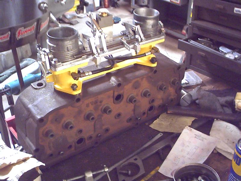

    For the few Non-Ford banger guys still around. I thought I would post some pictures of the new intake for the Dodge bros.

  8. What is the diameter of throttle bore and that of the port?

    Rich, what throttle bodies are you using? It looks great. Are you going to run at World of Speed in 2010?

    The port is 2 inches. The Ford 4.6 mod motor throttle bodies are 2.562 ID. I hope to have the Dodge on the salt either in my roadster or in a new rear engine roadster being built but they started thinking SBC lately. I also hope to loan my Packard/Vega to someone to run at woS.

  12. Rich,
    Thanks as always for posting- the throttle bodies look good!
    Just a quick question... would they be too much for an Olds 3 port head?
    I'm trying to think through some more economical ideas
    (translate as Winfields are too stinkin' expensive).

    I used two of them on my Plymouth but it was a race motor. It started and idled fine. was OK to drive through the stageing lanes. But keep in mind it's a Hilborn type fuel injection as I run it. If you are good with wires and can build an EFI system I am sure it would work fine. If you can live with the Hilborn race type deal it worked for me and I am sure it will again. If you want smaller throttle bodies I have some BMW parts that look the same but are 2 1/2 inch. I have also used F150 TBs which is a two bbl. 2 inch bore and 4 Suzuki 1 7/8 bore tbs off a 750GSXR. If you look on the bay you will see literly thousands of TBs of all sizes for sale. My 4.6 Ford parts went for under $20 or somebody else got them.
  14. Now that is a work of art.
  15. That engine is a masterpiece for a dodge banger Rich. I like it man, very nice detail.-Weeks
