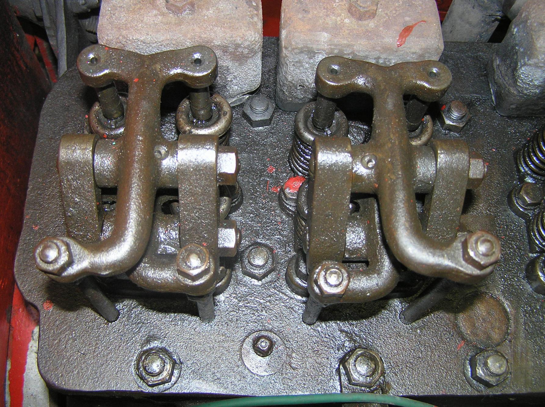

    A friend gave me these pics of a banger they are restoring. The engine is interesting and i thought you guys would appreciate it. He gave me a ton of pics but for privacy i'm not including anything identifiable to the car. But it is the real deal, if i get his permission and you guys want i'll post more pics.
    My buddy poured gas in it retarded the spark and fired it up on the crank and it ran, he sent me a video of that. He thought it was the first time in decades that it had been started.

    Looks like some 16 valve maybe a Roof? On a "T"?

    That is F'n *****in' !!!!!! Ya, I'm thinking Roof head. Yes, more pics and video !!!!!!!!! Pleeeeeese.

  29. Roof, looks like pictures I have seen online and in books.-Weeks

    Here is some pictures of a Roof BB OHV .
    The exhaust is different, but the valve train looks the same.
