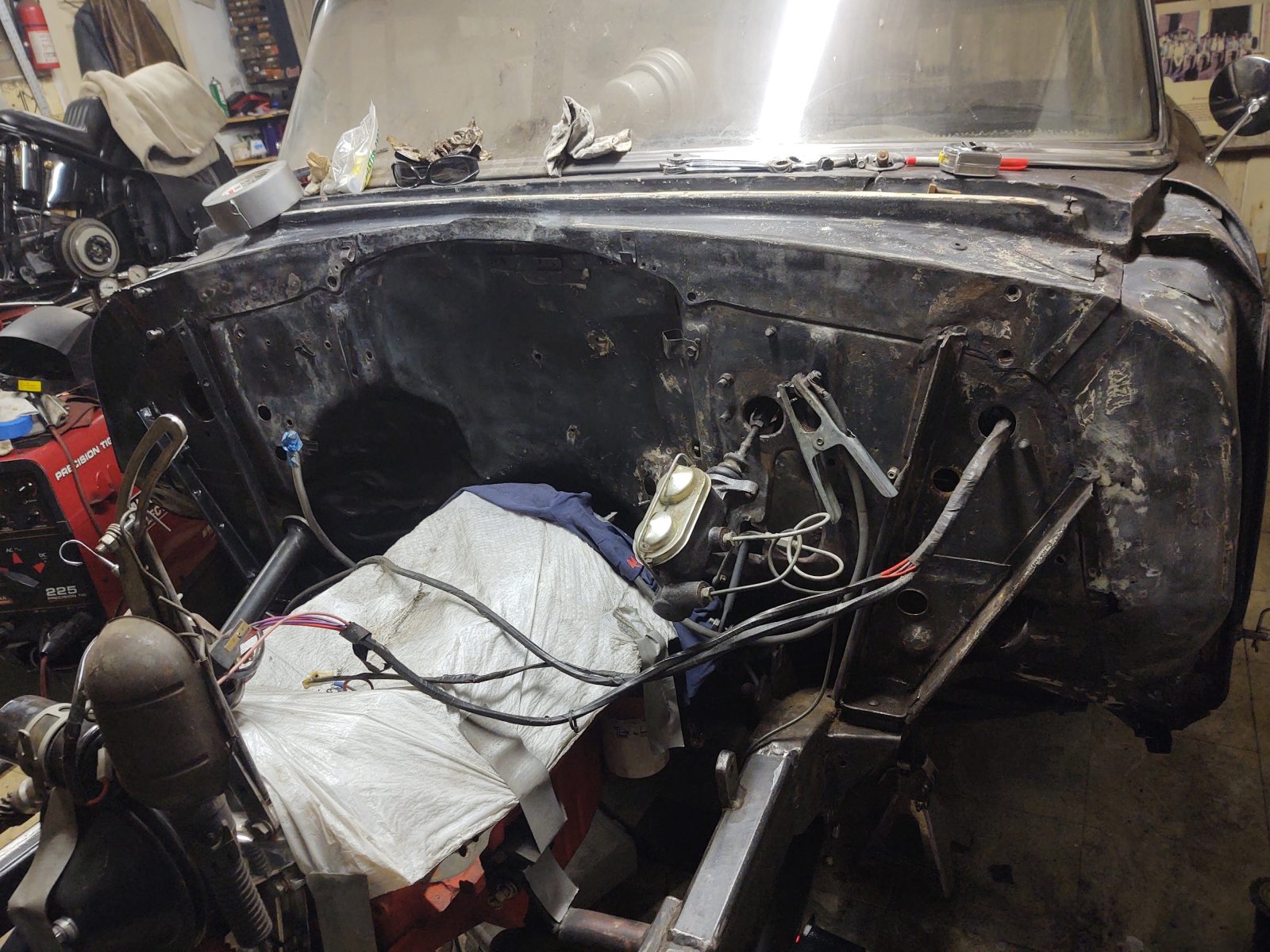

    I stripped the firewall and engine bay as much as was reasonable on this car. Nothing glamorous, but it's time consuming stuff.
    1. General cleanup
    2. Weld up holes that had been drilled over the years
    3. Clean up some other holes that had been made for things like the clutch rod
    4. A small patch in the p***enger side fresh air vent, usual tri-five spot. (the drivers side is a mess, but I'll save that for later).
    5. And clean up and finish mounts for the front clip support rails, which now bolt to the frame rails so they are removable.

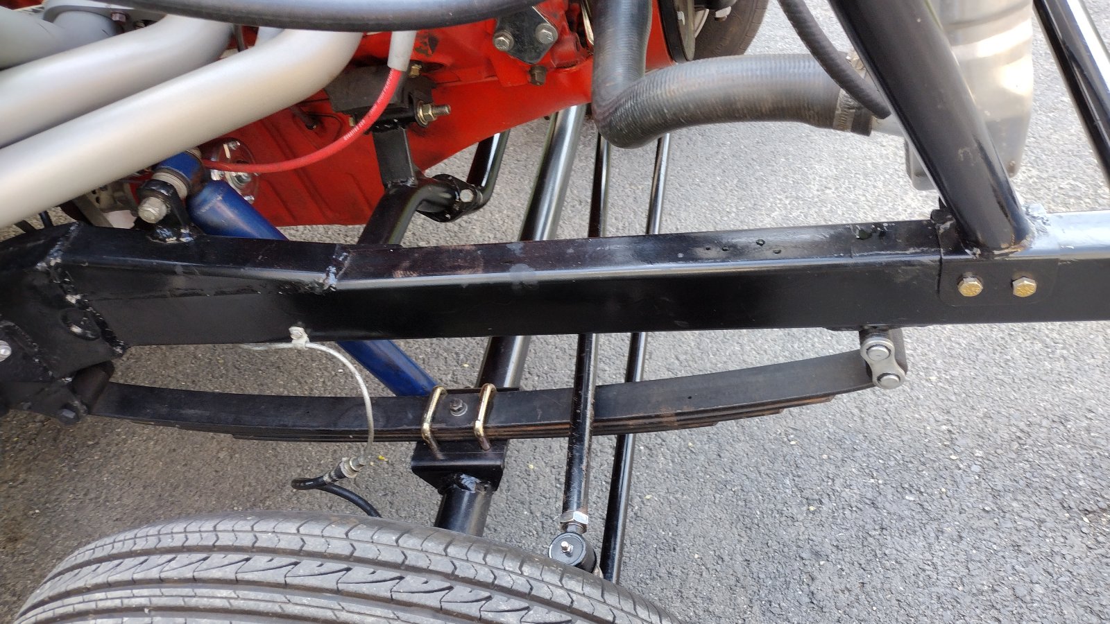

    I already mentioned that the axle pads and pretty much all of the weld-on parts (motor mounts, shock mounts, frame rails) needed finish welding and clean up. Most were also bare metal and therefore surface rusted.

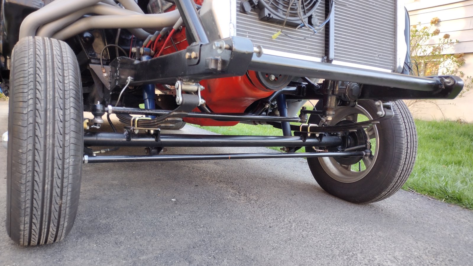

    Remember I said I hated how low the exhaust hung down? The exhaust got finished awhile ago, when I had the headers ceramicoated after welding the byp*** flanges. Now the pipes run parallel to the car.

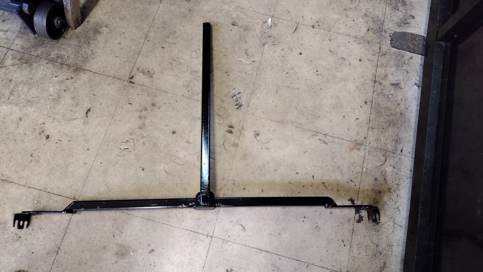

    I sectioned the motor mount crossmember and added flanges so the oil pan can be removed, sometime ago.

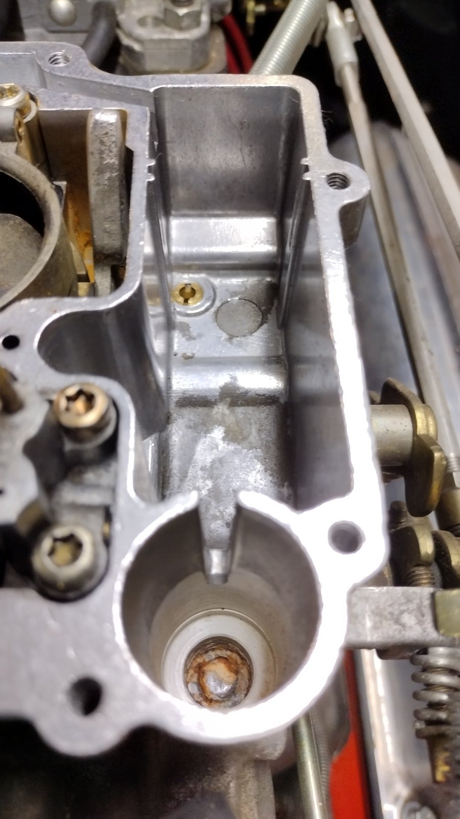

    It took me 8 days to get this thing started. It would fire a little bit, but that was it. So I was like, "it could be pretty much anything".
    1. At first nothing but a clunk when hitting key.
    2. New 65 series battery $225, same thing
    3. It's been 6 years, and a ton of work after a bend rod, so it could be anything. Bang starter enough, it frees up.
    4. Turns over REALLY slowly, but it works. Again, I can't remember if this is normal.
    5. Open carbs. Look terrible! I swore I cleaned them when I tore the motor down, but maybe not.
    6. Gas looked horrible. Pumped the tank clean.
    7. Went through carbs probably 3 more times.
    8. Checked the valves like 5 times.
    9. Omitted the battery shutoff.
    10. Checked and added grounds between battery, engine, and frame
    11. New spark plugs.
    12. Checked firing order and distributor 10xs
    13. Checked the coil and distributor timing 10x's
    Finally decided to try a new starter. Cranking problem solved. 100x' better. BUT I did have to reclock it. Seems weird that a starter for a big block Chevy needs reclocking: they're basically the same, right?
    Now spark (via tester) looks ****pier. When testing another coil, I finally found the negative terminal ring terminal at the coil had snapped, but you couldn't see it because the shrink tube was holding it together still (intermittent spark). Fixed that, and thing started to happen

    I can finally see the fruits of my labor in the front steering (can't be any more parallel than that) and cleanup of everything in the front clip of the car
