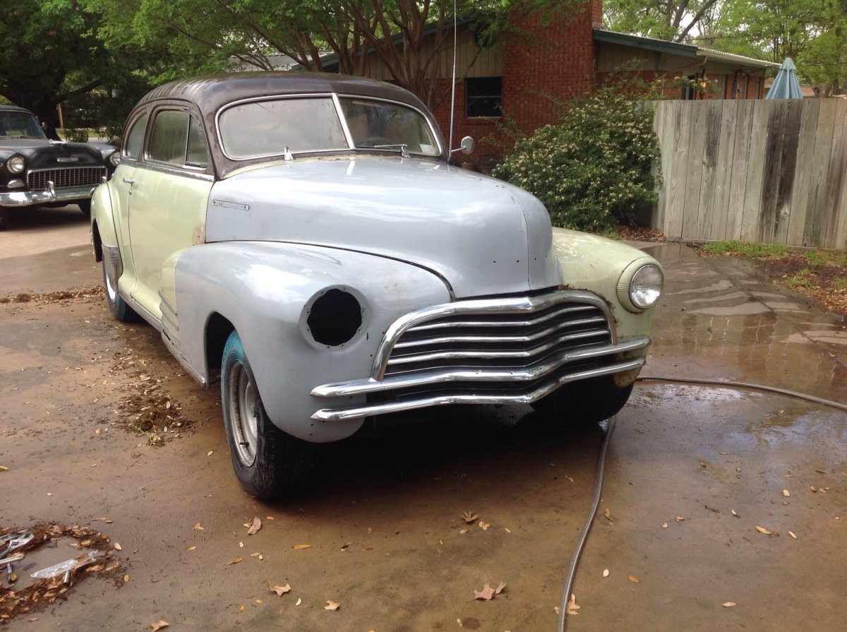

    Here's mine. It's a 48, got smacked, so I put in a 46 grille, cause I like em better. Its got a 250, th350, 57 chevy rear end. No rust. Buy it. Don't mean to hijack your thread. Sixes are easy to find, and I did all the work in my driveway. Headers and a 4 bbl, it runs in traffic just fine. Keep looking for a six-shooter. Craigslist is your friend. Glad you're back.

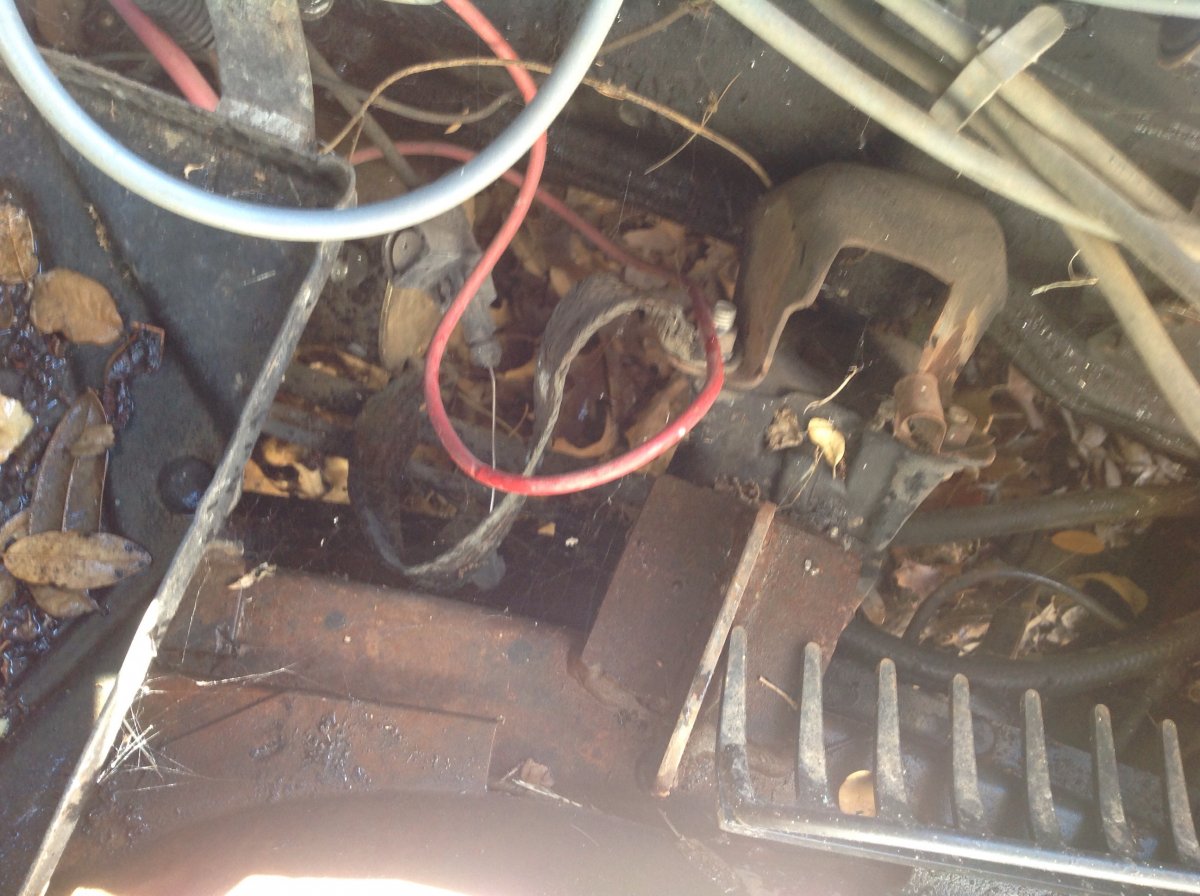

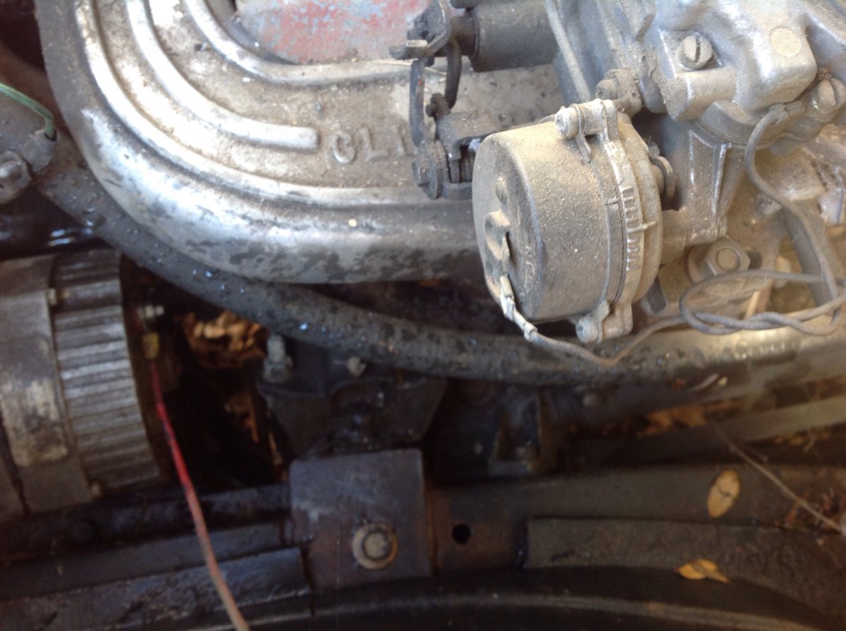

    Why will the trans be "fun"? Are you going with a manual? A 230,250, 292 will bolt up to a th350, and there are adapters for 235. BTW, I used slightly modified 71 Chevy pick-up motor mounts (6 cyl) for my engine.

    Yes I would like to go manual but all the linkage is missing. Do you have a build thread on how you did the motor mounts?

    ^^^^ the p***enger side has a gusset on top, I just laid them on top of the frame, trimmed off what wasn't needed. Easy as pie.

    Thank You, it looks easy enough to do. I will have to get a welder which I was planning to do there is plenty of steel around here that is easy and cheap to get.
