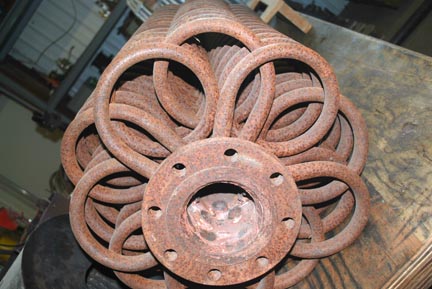

    I'm sorry, Frank, but my gut tells me this design is a bad idea, and I feel I'm not alone here. No, I'm not familiar with the Ofeldt, but have worked around materials all my life and am puzzled as to why Wafflemaster wouldn't take the safer, PROVEN alternative of a "conventional" water-tube boiler. For over 100 years, it was the standard setup for steam locomotives that would do 100 MPH, and, in fact, the only fire-tube design I can think of on the railroads was the 300+ PSI special that the Erie built around the turn of the century and was s****ped as too troublesome - it turns out, the stationary and marine designs sometimes used fire-tube but even on smooth rails, there was too much vibration for the boiler to handle. An even bigger cause for concern, though, is the duplex drum design! Looking up a "typical" Ofeldt on-line I see a SINGLE central drum - the duplex setup introduces a potentially DANGEROUS see-sawing effect we've discussed earlier; I can't emphasize how much of a boiler-killer this feature alone can be. Also noticeable is the ratio of drum diameter to tube area: notice in this photograph how much smaller the central drum is compared to Wafflemaster's?
    http://www.kimmelsteam.com/images/Ofeldt boiler-Grzyb/Factory Ofeldt DSC_0777a.jpg
    The larger the stored volume of fluid, the more potential for danger there is
    Oh well, since he's apparently intent on completing this project all I can do is hope for the best.
    Wafflemaster, it's just that nobody wants to see you or others get hurt!
