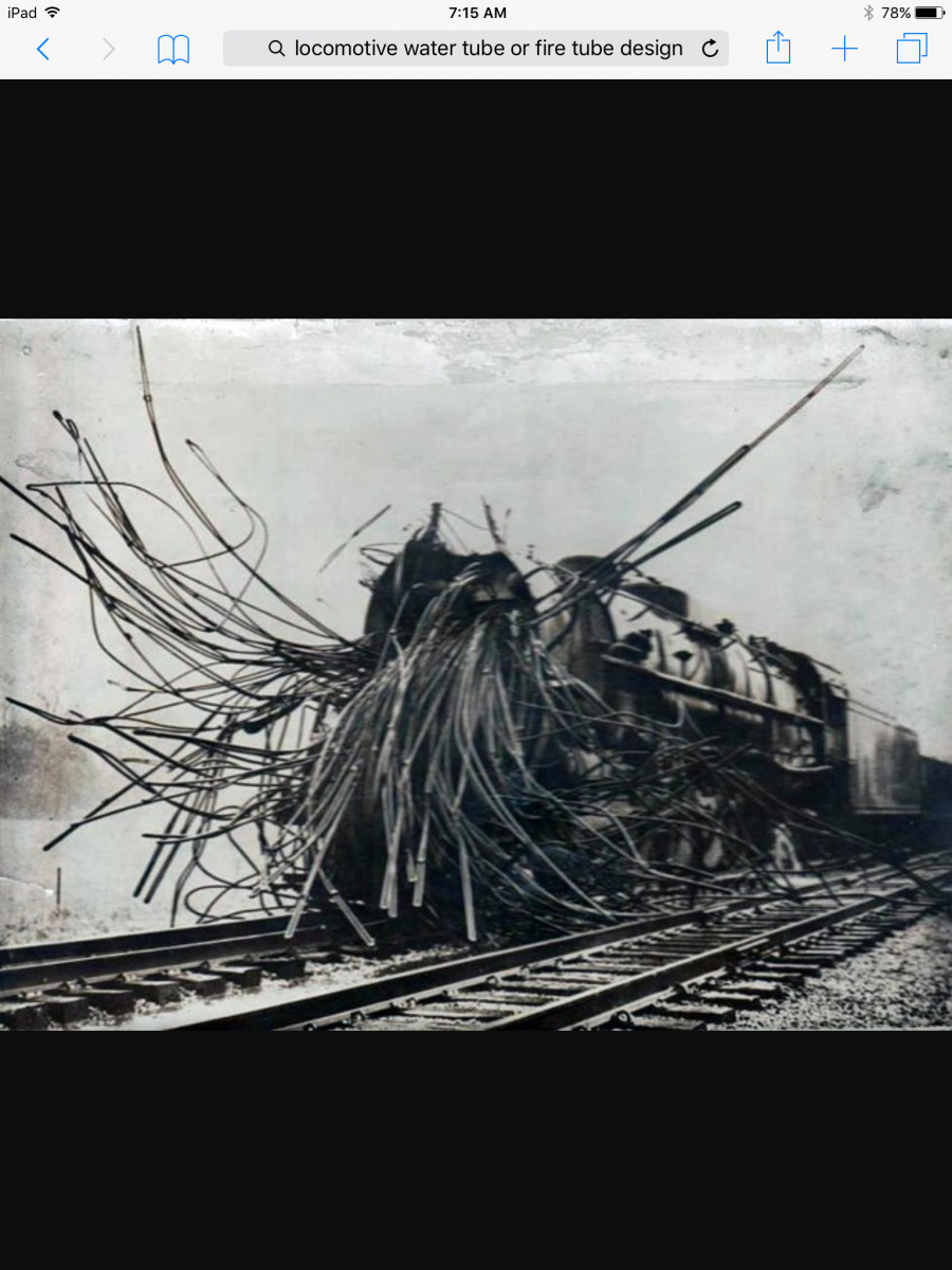

    Check these out! Use caution , I sure the locomotive was operated by a licensed engineer and was built to code and well maintained to code requirements . Accidents happen , but we must try to prevent at all costs , safety doesn't have a price tag , but the results of not using it does have a price tag attached .

    I also am interested in live steam model locomotives. The hobby magazines regularly have discussions about boiler safety, the need to follow ASME codes certified materials etc. Boilers are made of welded steel with copper tubes or steel tubes. Some boilers are stainless steel others are all copper silver soldered. very rarely is certified material used. Most welding isn't done by certified welders. Pressures are usually 100 psi.
    This has been going for more than 100 years and there has only been 1 recorded boiler explosion which resulted in a cloud of steam but no injuries.
    The folks that have posted pictures of exploding steam tractors, locomotives and power plants seem to not realize that 2gallons of water in a boiler doesn't have the energy that several thousand gallons in a large boiler does.
    Yes he could get scalded but the possibility is very small. The reality probably is that one of the copper coils will fail and a cloud of steam will come from the bottom of his boiler casing.
