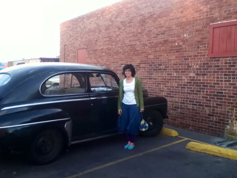

    some one made note a long while back of how Sarah wasn't in the photos much anymore after the beginning, let me ***ure you she has put in an awefull lot of back to back 12 hour days right next to me on the car.
    So with that in mind i thought id post this 14 month update photo, in a month or so when its all cleaned up and a little more put together i thought id post the video of when we first walked around the car and a video of it now. but until then...

    Nice work man...Sounds like your getting closer!

    Thanks :) can you believe it sat that high WITH the flathead 8 still in it! From what I read over the first 1000 miles my front spring should settle another inch-ish looking forward to a little more nose down stance.
    Tomorrow morning I'll put on my warm clothes and finally jack the car up and tighten the residual valves better, there not wanting to seal 100% which obviously makes bleeding them a futile mission. Hopefully I can manage all that tomorrow and get my insurance papers stuck in the car somewhere the wind won't take them.
    Then I can work on getting the proportioning valve just right, install the gauges, make some quick and dirty seat covers, cover the floor with a rug or something, pai t the wheels and add caps. Wash and wax and there we are in time for wedding bells :)

    Has it really been 14 months? That flew by! :eek:

    Car is looking great!
    Nothing like a deadline, especially a wedding, to keep you on your toes. :)
