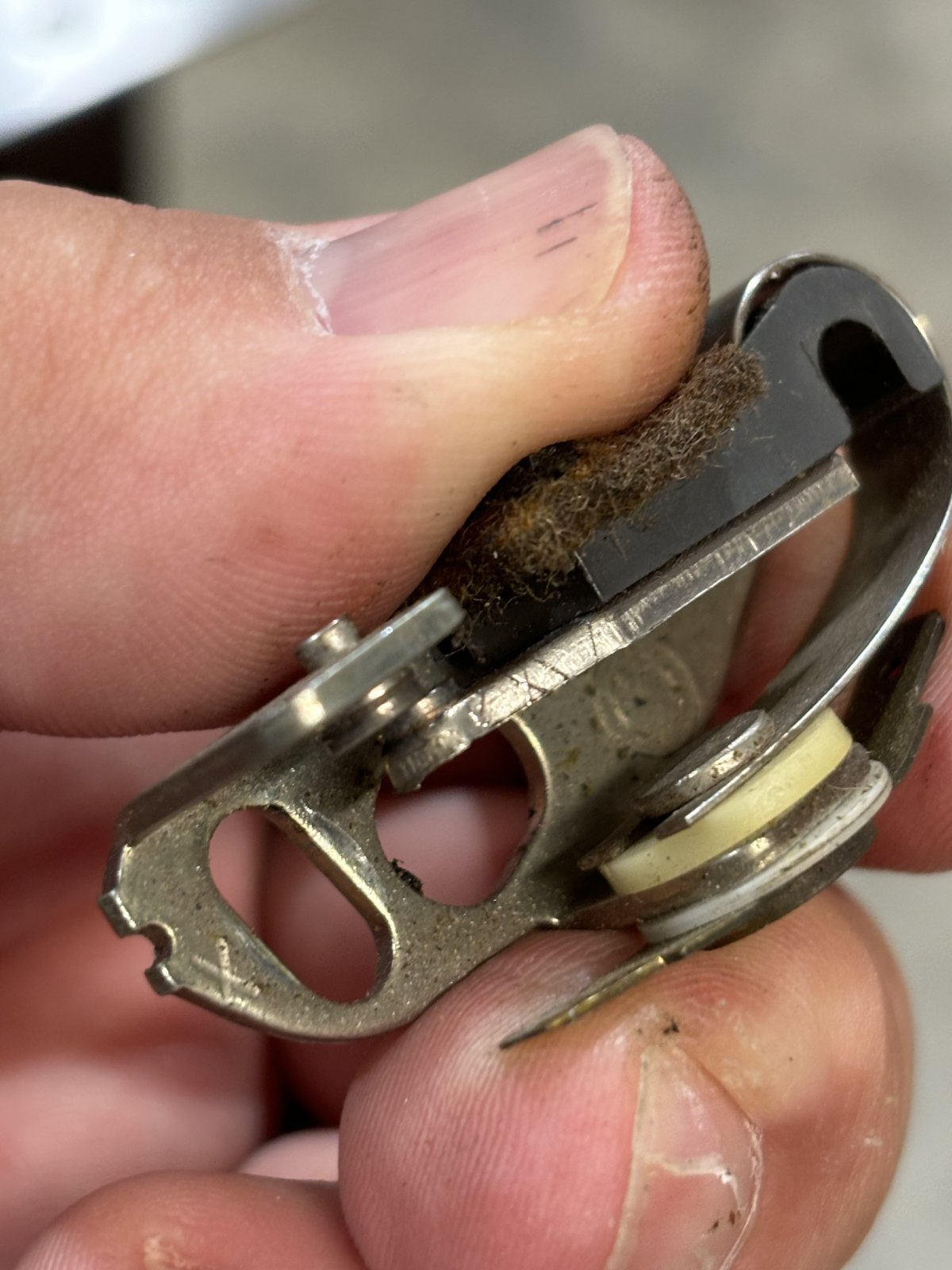

    Ok quick sorta update, bought some replacement points for the distributor. Long ramble short I felt like I’d dusted the points with a failed capacitor and then by the time They were cleaned up they were to worn to function correctly
    pulled them and found the spring was basically sprung IMG_5166.jpeg IMG_5165.jpeg in the car they were square but not even close out of the car. Sorry for the zoomed in fingers lol couldn’t get the camera to focus that small unless I held them.
    the pads also are noticeably thinner than the new points.
    down side is the points I got don’t clear IMG_5169.jpeg you can see the double nutted post on the new ones and it completely hits the inside of the distributor body. No room at all, the points I removed have a spade connector so way tighter.
    when I looked up replacement points that aren’t Mallory they came up along with these IMG_5168.jpeg while I saw more people using the 2300 I thought the post would be easier to plug and play. Jokes on me, I guess I’ll exchange these for the 2300 and ether see how close the strap lands or swap the tiny spade connector for a ring.

    The reason your points don’t line up out of the car is they’re not on the locating pin. I really don’t think they’re a problem.
    winduptoy and Tim like this.

    Alright so I’m waiting to test fit the new points, but here is a quick update.
    I spent the last week of evening spare minutes with my multimeter and the 46 and tested every thing suggested and everything else I could come up with.
    Everything tested like it should until I found a video of someone bench testing a set of points for continuity. That’s when I found it! … I
    Hope.
    On the set I had already removed somewhere between the spade that the power wire connects to and the spring there is a short.
    Right in that stack of yellow and white insulators and rivet it goes awry.
    best @porknbeaner and I can figure since the coil and capacitor tested bad before I replaced them, is the coil surged when it failed? Taking out the condensor and creating the short? This car has had a decent history of electrical dominoes when something fails so it makes enough since to me.
    either way if these new points physically fit I’ll change the fittings to get power to them and we shall see.
    At this point I’d be more surprised if it did fire up but I’m really feeling like we’ve got it this time.
    brEad, Tim_with_a_T, drdave and 2 others like this.
