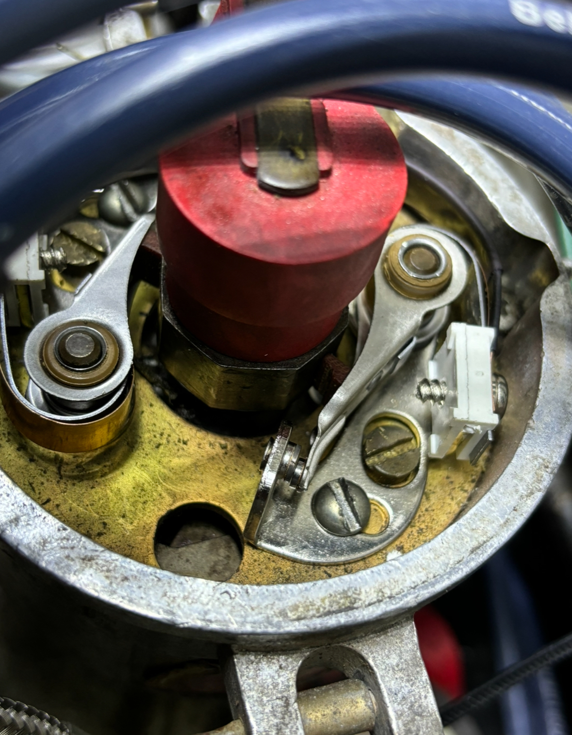

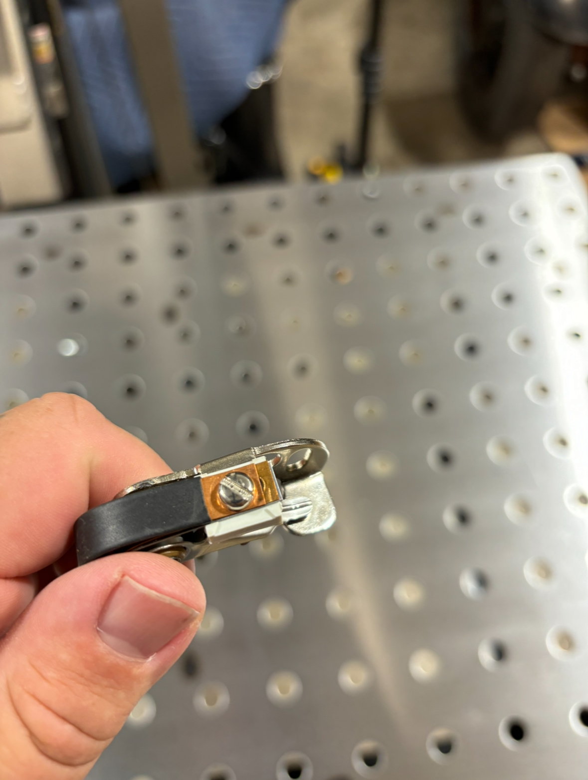

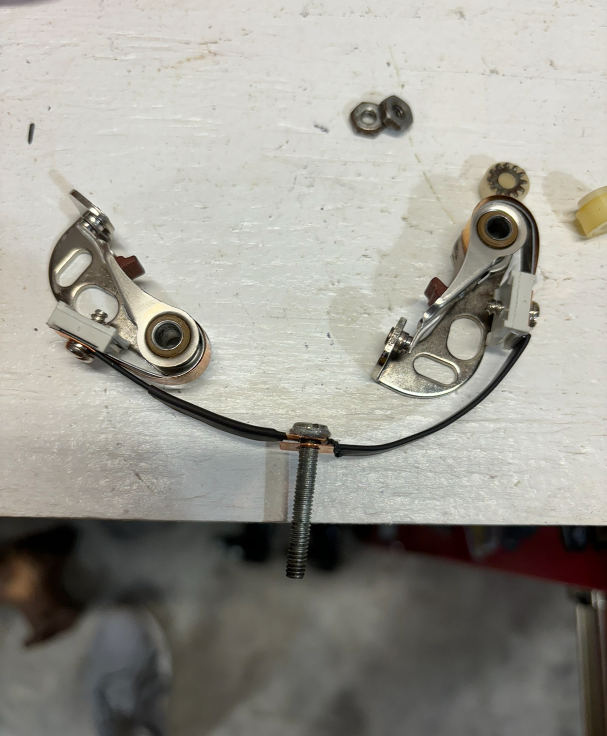

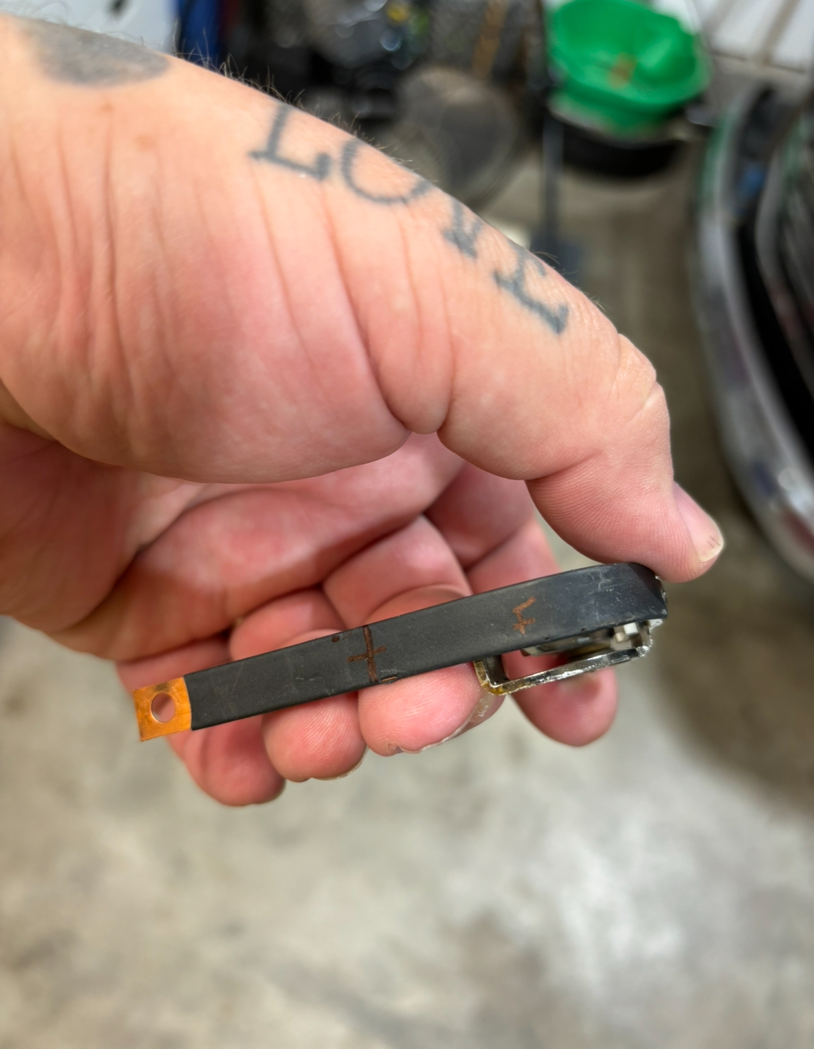

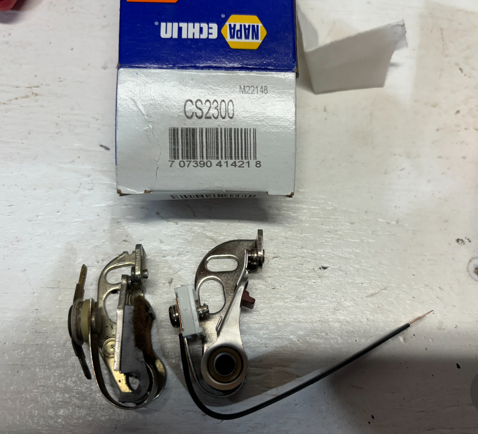

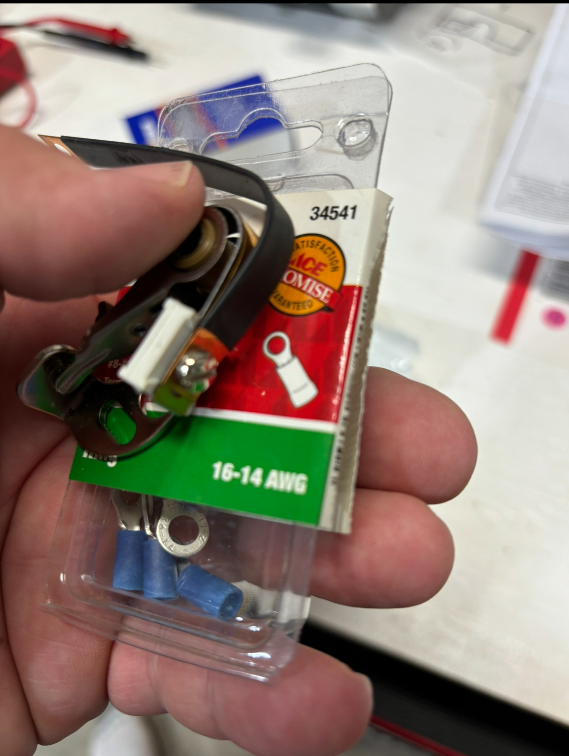

    Soooo close.
    So ends up the wires are too short to add a ring terminal to so I mocked up and re drilled, cut and heat shrink the straps. IMG_5374.jpeg IMG_5375.jpeg IMG_5376.jpeg IMG_5377.jpeg Which makes for a lot of dancing. Had a hard time getting the inner half of the insulator on the stud to get into the hole but I got it. IMG_5378.jpeg IMG_5379.jpeg Only down side is the rear most set of points didn’t/ won’t slide all the way down the locating pin. It did while doing all mock ups so either something is under it or it’s just in a funny bind.
    you can see when I put the screw into the base plate it pulled the points out of alignment but didn’t get the set to slide down the post. So this morning I removed the screw and I’ll take it back apart tonight… again.
  4. Tim
    Joined: Mar 2, 2001
    Posts: 20,432
    Tim
    from KCMO

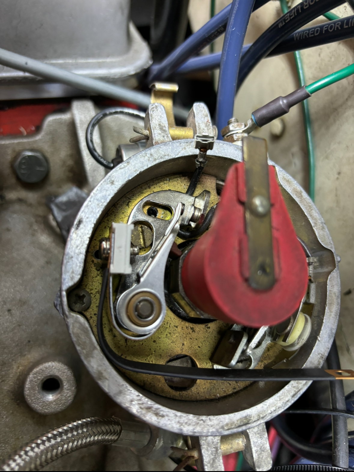

    So last night I took the set back out and put them back in. Did the ***embly dance we all know. ( parts you know go together but only go together if you do it very specifically )
    anyhow got them as good as they are going to get, it appears to me that the may have never set exactly the same because they have different looking spacers on the bottom Of the alignment poles and looking at photos online they look like mine do.
    anyhow I used a pick to make sure the rubbing block on the points was making contact evenly and spent a lot of time gaping the points exactly on the top of the lobes at .020. Checked them after they were snuggled down etc. I will check them
    Again after it’s run for a a while since they are new but they are pretty dead on.
    anyhow I smear some supplied grease on and ****oned it all up.
    super nervous to even try to start it at this point I gave it a shot after checking every possible wire and connection.
    aaaaaaand I think I’m getting a little rumble but not enough to start. Volt meter landed around 7 so I sat the battery charger on it over night and I’ll try again around noon. But it did seem, or my desperate ears want to make it seem like it was getting spark even if weak when I tried.
    man this thing better start

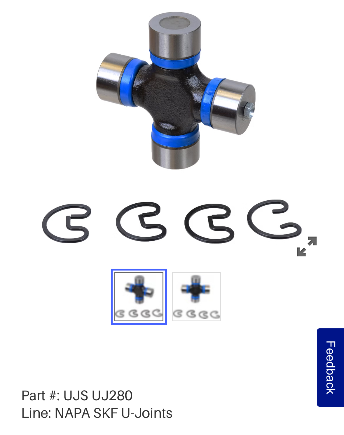

    Looks like the rest should be a ****er 1310 joint.
    some of these options look exactly the same on paper but even from the same manufacture some are 40% higher. Guess I’ll go full @Tim_with_a_T and learn more about u joints than anyone needs to know. Lol
    IMG_5987.jpeg First question. How do you grease theee things with a nut on the cap instead of a zerk?
