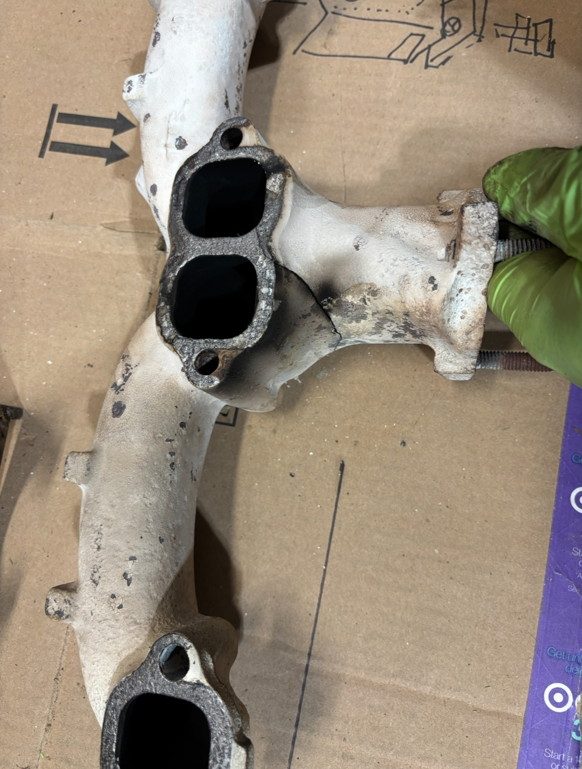

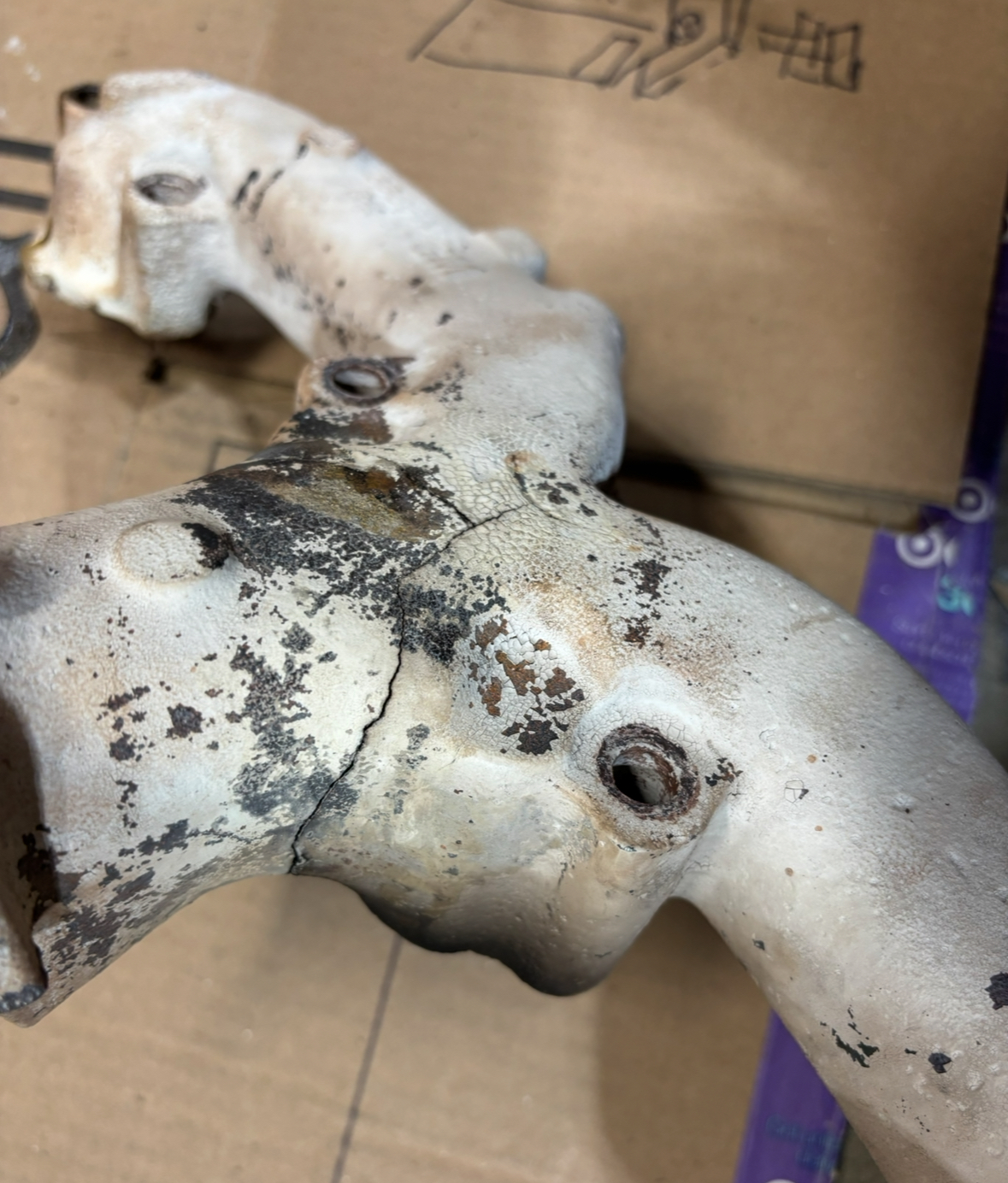

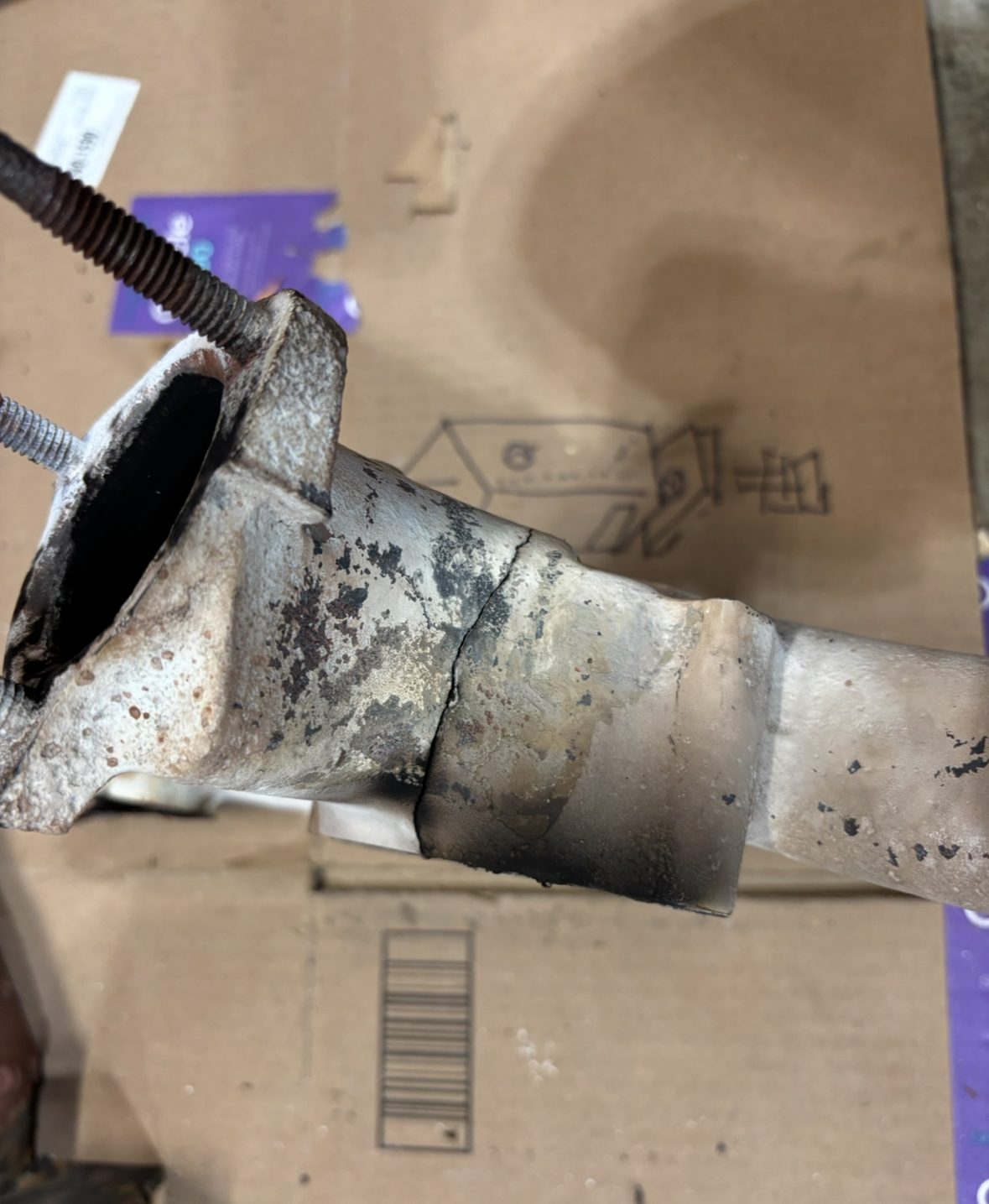

    So with the school year coming to an end I’m still trying to find the work schedule for this season. I haven't gotten to checking over the car past looking at the p***enger side exhaust manifold. The rest I’ve optimistically set for Sunday.
    I’ll take some photos when it’s off the car but as some will recall after cleaning up a replacement for the drivers side manifold the p***enger side promptly cracked.
    the drivers side broke the flange to bolt to the exhaust losing a bolt/stud location when a buddy was helping remove the exhaust and didn’t realize he was hitting the manifold and not a flange on the pipe.
    Anyhow it is cracked I’d say 50% of the diameter about an inch and a half or so above the flange to the exhaust towards the block. On the back side where it’s up against the block the crack is big enough to stick a pick into but not through. I actually think it has pinched shut pushing that part of the manifold into the side of the block.
    on the outside it seems to have created an inverted Y crack with the vertical reaching toward a the center primaries.
    I won’t be surprised if it just comes apart when I remove it from the engine.
    when it was a hair line I jb welded it and moved on for the time being because getting them on the car was a weeks long chore. Mainly because getting them on the head and on the y pipe with studs on the collector ends was a real pain. I could hear it on warm up and then once it hit operating temp it swelled shut, to my ear anyhow.
    I’m thinking that the terrible road in Oklahoma that destroyed my, and others, shock mounts also fractured this already cracked manifold and the extra heat escaping is going right to my trans cooler lines.
    so after the Sunday inspection my next step for the car is pull another rams horn off the shelf and clean it up and paint it to swap. This one will get the studs cut off and drilled out.
    This car isn’t really “project priority” but if it means I get to drive it this summer instead of chasing gremlins it’ll get bumped ahead in the line.
    keep ya posted

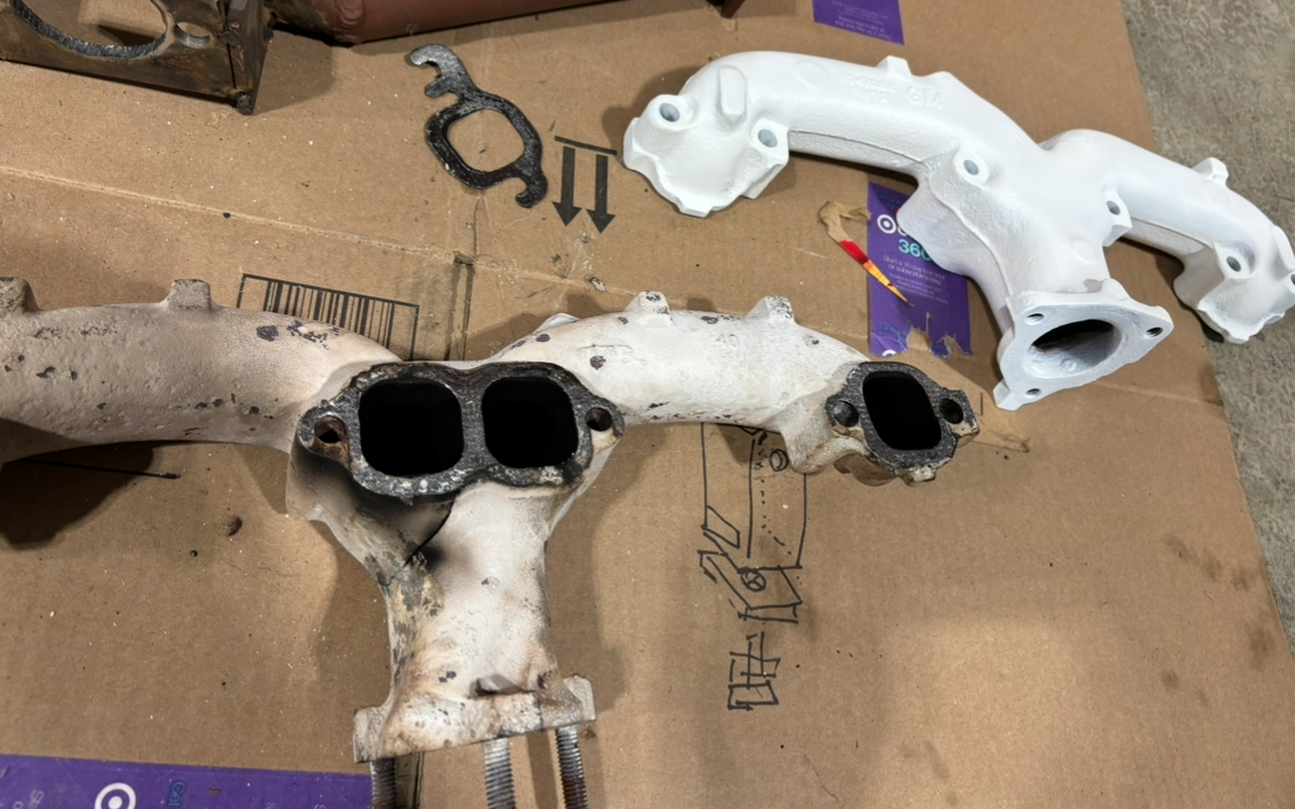

    Yup that’s pretty busted lol
    would explain my heat related issues and running less than awesome.
    new one ready to go on, just need to chase some threads, find some bolts and some time.

    Ran a tap through the threads on the collector side, grabbed a gasket off the top shelf and got the new manifold on 90%.
    I need to buy three bolts to connect the head pipe but it’s shoved up into the collector with the ring gasket nice and snug already.
    long as the threads int he manifold holds I can sneak three bolts in from the bottom, finish tightening down the manifold to head bolts and and be ready for a test drive!

    Nah, I think you are chasing rabbits and that manifold has nothing to do with anything. LOL I'm with @osage orange .....I doubt I've ever seen a more cracked manifold. I bet that solves a whole lot of problems.

    With the amount of black I wiped off the side of the block I’d say it should solve a lot.
    I’m really tempted to drop this manifold on the floor and see how many parts it breaks into but I might wire wheel it instead. Just out of general curiosity
