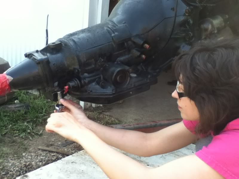

    the motor mounts primed, painted and installed i moved onto the trans/wishbone mount. i wiggled under the car and got in all clamped in place with out to much drama and popped the holes in like a hot knife threw ...well hot butter haha. I've gotta go grab a bigger bit for the wishbone mounts but other then that its all buttoned up. pretty straight forward oddly enough haha. no drama.
    after that i started cleaning up the engine, i spent the better part of Saturday pulling it out of a friends recently lifted pickup and at first it looked pretty filthy but it seems the valve covers were hardly tight at all and most of the grime was just new oil all over.
    so some rags and some dawn/water and it was close to being clean. threw it up and over the front of the car to check clearances and what not and found the stock battery tray is in the way, the HEI is going to clear but not by much it seems and the center dump exhaust on the drivers side just may clear the steering. Kinda iffy if the mech fuel pump will clear though. its pretty close to the stock crossmember right now, i guess with the trans bolted to it and pushed around it place better we'll find out.
    yanked it out and got started on the trans, got it primed and painted and installed the convert. Wiggled it all around and bolted up the bellhousing only to find that the converter and the flywheel were nice and butted up against each other guess it didnt fully seat :p off it comes next weekend.
    I thought I heard it pop 2 times but i must have heard wrong. sad day.

    anyhow here's some photos now that im done rambling. Because everyone knows a thread it pointless with out photos haha.
    stock trans mount gone
    remains
    motor mount positioned in primer
    deluxe midnight working accommodations ;) you can sorta see how the mounts are offset here
    pulling the motor, pulled the 38's off the front to make it a little easier to yank. and it was a "little" easier :p
    100 degs and every thing's black, and not a shade tree in sight. great.
    every wrench at this point was a 'hot wrench'
    buddy and his dad making sure every thing's looking good.
    a tornado watch and its at the shop :)
    front end out!
    air ride?
    cut dogbone
    taking a break and taking pix

    Alright quick update, it was mothers day weekend so i didn't have as much time as normal but i still made a dent.
    After a little fussing around I got the converter to seat and the trans bolted to the motor. What seems like was happening was the converter would jossle around and more or less un seat when i was bolted up the engine because the trans was on the ground and the motor on a cherry picker so the angles just didnt want to jive perfect.
    took 3 trys but i got it seated and bolted up and then went ahead and bolted the converter to the flywheel.
    I also managed to get the stock battery tray out of the car. the bolts were either rusted solid or super hard to get at so it was a little work. I have seen photos of the stock battery tray being used with a sbc but as i dropped the motor in the first time it wouldnt clear the manifolds. oh well, ill put the battery in the same spot just lower instead of up on legs and I shouldnt have any trouble.
    a hot hot hot torch and some slip joint plies i got the cross member that ties the halves of the X member together clearance for the tail shaft and dropped the motor and trans in together to make sure everything would clear. granted i dont have the drag link hooked up right now but fingers crossed it will clear and we will be looking good.
    i also managed to get the engine painted, plus side of having tins and plug wires on the engine that i dont care about is a whole lot less masking haha. should look sharp all dressed up.
    And Sarah made the delightful discovery that the trans mount holes are pretty stripped out so the drivetrain came back out so i can re tap them next weekend.
    It was the first time for her to mess with engine swap stuff so she had a good laugh at spending 45 minutes to get the motor and trans into the car and then it taking about 4 minutes to pull it out. Yup, thats how it goes.
    got an order in with Macs for a bunch of kinda random harder to find bits and was delighted to find all but some little brackets in stock, and hit up Julianos for some front seat belts. A couple more trips to the parts store and i shouldnt have any issues with waiting for parts to show up for me to make progress.
    next weekend i hope to have the motor and trans in for the final time~ fingers crossed, get the spring off the front axel and the wishbone cut so i can send it off to get welded up, get the bigger holes drilled for the mounting points of the split bones and start in on brake lines. i'll be realistic and be happy if i get the new pedal/mc and prop valve painted, plumbed and installed in the car. but id be more pleased if i get the lines to the back brakes done as well.
