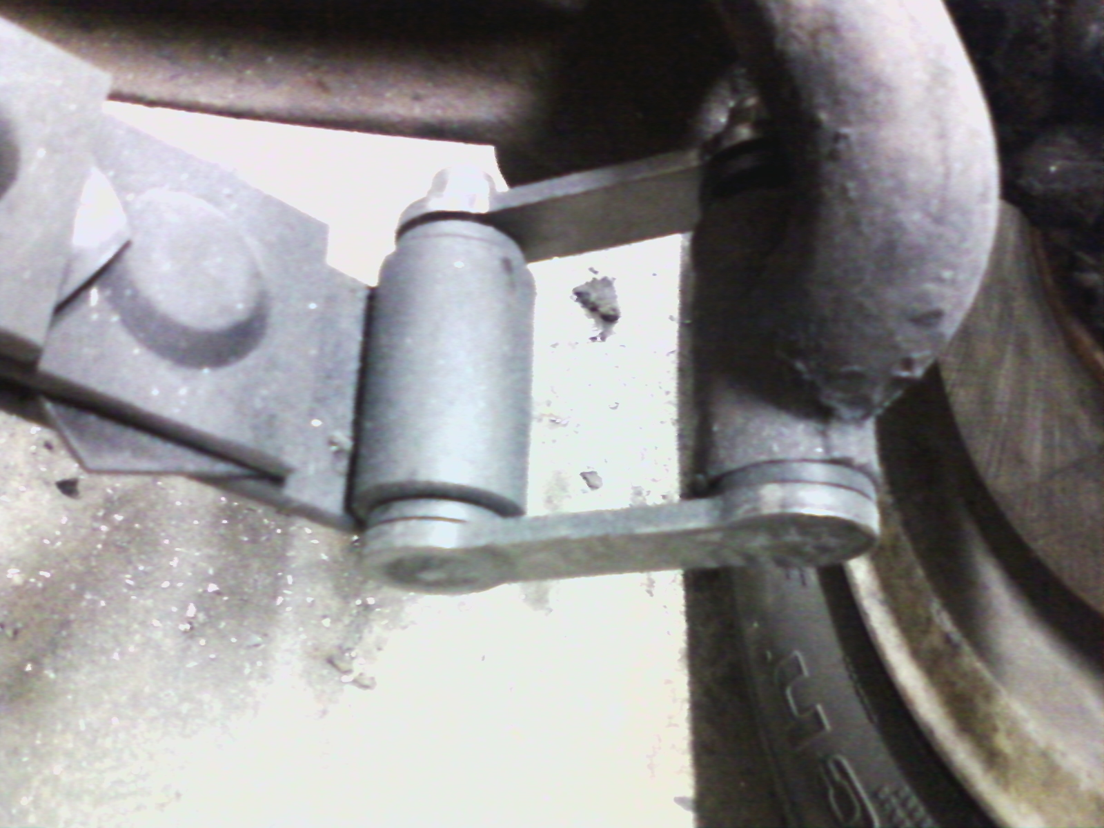

    Hey Tim, Great progress on your build ! On your front spring I did the same one. and like you scratched my head when they didn't quite match up. I bought my posies spring from speedway but they failed to tell me you need the new posies shackle too. Posies was nice enough to cut a buck or two off it and ship it right away.

    OMA_Turk how long are the shackles center to center? it looks like the eyes are the same distance as the old ones so I'd guess 3"
    would you mind measuring them when you get a chance?
  28. OMA_Turk
    Joined: May 2, 2011
    Posts: 43
    OMA_Turk
    from Omaha, NE
    ok just measured them, from center to center they are 2 3/8 length.. here is a pic

    awesome thank you. ill probably just make some that way i actually get what i actually want haha.
