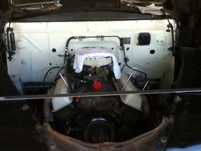

    people always like photos but running brake and gas lines isn't that glamorous so this is what i saw all "weekend" when i wasn't looking under the car.
    Basicly what got done was finishing mounting the brake lines, I had a couple holes left to drill, some short mc to prop valve lines to make etc.
    took a brake to stretch my legs and walked around, then got going on fuel lines. I ran all the way from the carb to about 30 inches short of the gas tank. got them all bent, all the holes drilled and everything clamped in place. mounted the pre pump filter, the pump and another filter further up towards the firewall.
    I didn't run brakes or fuel past the rear axle as I figure it'll be much easier once the front end of the car is back bolted in and I can jack up the rear and pull a tire to get at them. all the holes are drilled and the lines made to length so it should go quick.
    loaded up the front seat and took it to my Dad, he's going to get it cleaned up better for me during the next week or two so I can focus on other areas as KKOA is growing nearer and nearer. I also got my steering column and shifter, shifter tube etc painted. its rattle can shiney black but seeing as most of its under the dash I figured it would be alright.

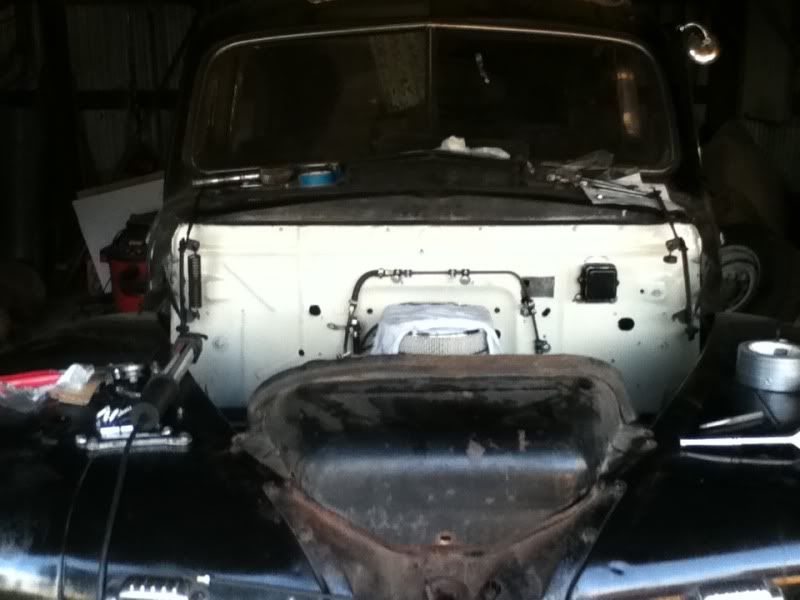

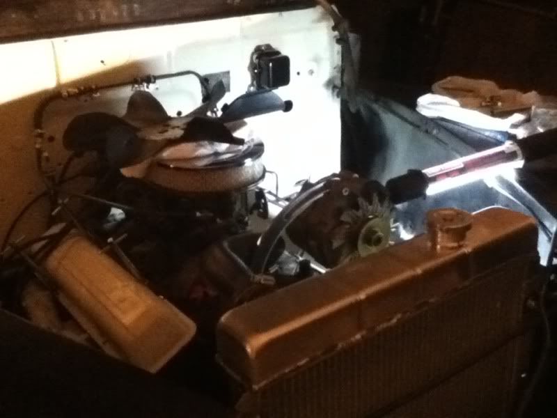

    upside of the heat is this roll of duct tape is suuuuuuuuuuper sticky and making for a great set of extra hands!
    i dont know what speedways radiator mounts are supposed to go to but its not this. so i grabbed some flat stock.
    ~dont mind all the extra fittings on that line on the firewall, i need to swap the bolted ones for the lose ones later and didnt want to lose them ;)
    made a little tab of cardboard for each mount. i know how things can be a lil different side to side so i figured id play it safe
    mocked up i marked everything with some soap stone and got ready to measure for mounts.
    you can see that the lower mounts have a little step in them to account for the shape of the stock brake im bolting to.
    transferred
    fancy drill press...yes we are registered at home depot for the wedding if some one wants to buy me an actual drill press for a wedding gift haha
    nipped the corners with a grinder quick
    and knocked them into correct shape with my favorite giant king pin from a tractor :)
    prime and paint
    halfway installed checking to see how the shield/cover clears. looks good!
    there is a motor in there i swear! hmm looks like room for a blower under that hood though..

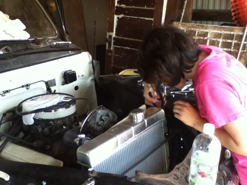

    Day 2:
    I ran around getting nuts and bolts and talking to the guy whos working on my wishbones to make sure we get it done by next weekend, and it was hoooooooooot.
    so all i really got done was finishing up the rad install, i ran short on bolts and the stores 6 miles one way away from me so it wasnt 100% done last night. i mounted the aluminum early mustang radiator to the stock radiator 'yoke' putting the flange even with the side of the yoke closest to the front of the car and it fit pretty much perfect. the old rad was bolted solid to this piece so i think it aught to be just fine. i used some fat washers on both sides of the bolts where possible and 1/8 inch thick rubber pad in between the flange and the yoke to soak a little of that vibration up.
    after that i got the stock cross bar that runs between the fenders between the rad and the grill back in and measured for hoses. I then made sure i had enough new screws for the windshield garnish molding and bolted the new mounts to the gas tank with the padding included. I wanted to make sure that i didnt lose a fitting and to make sure that i had enough bolts. I didnt. ha...
    Either was i was going to install the gas tank and the battery tray also this afternoon but i found that no way was the bat going to fit upfront so i admitted defeat and started setting up to run it in the trunk. I'll need to drill some holes for the battery box and figure that was best done with the brand new gas tank not in harms way so until next weekend when i have a box and a long ass cable it'll wait.
    and that more or less is what i got done other then being hot enough to have sweat raining out of my beard lol.

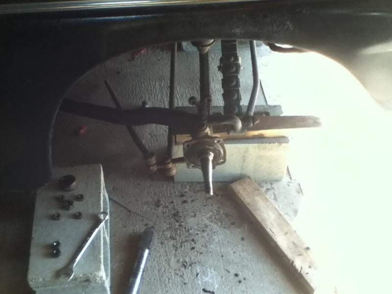

    day two! pull the old brakes off
    greassy!
    one..
    and two. came off real easy and they are totaly complete and in good condition. some new pads and wheel cylinders and i could have run them.
    instead...
    i pounded an adapter on
    mocked up a huge rotor with a pre metric 1975 impala caliper, looks like itll clear the wheels just fine. close but fine. might have to do a teeny bit of clearancing when its actualy put together bit itll be minimal if anything.
    i got the passenger side almost finished, i need pull it apart and get the seal to seat better and i think im going to re pack the bearings just for peace of mind before i bolt the caliper up and move onto the other side.
    all i got done on the other side is getting the bearing/seat adapter on and switching the outer bearing cup in the rotor out for the correct one.

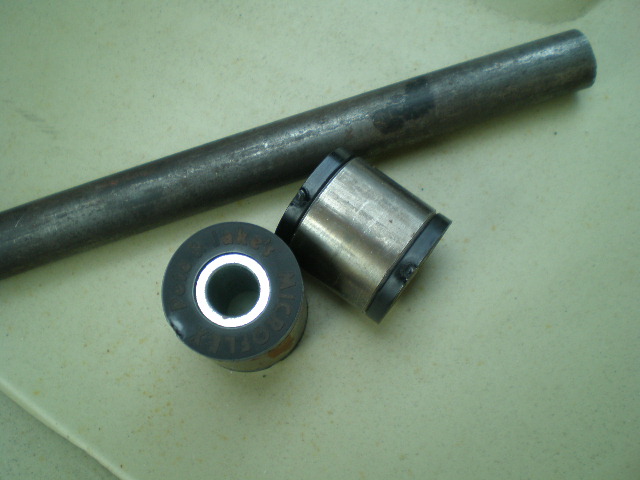

  23. I just used the tubular ones that came with the Posies kit... They came loose eventually too, don't rely on the stock caged nuts in the frame... and put fender washers front and back...
    Page 5 top right corner...
    http://www.posiesrodsandcustoms.com/images/pages1631.pdf
    looks like they use a different style in the kit now.
    Here's the only shot that has them in it.
    I had to cut the panhard bar stud off the wishbone to get the tube shock to clear, that the reason there is no Panhard on mine... Stilll figuring out what to do there

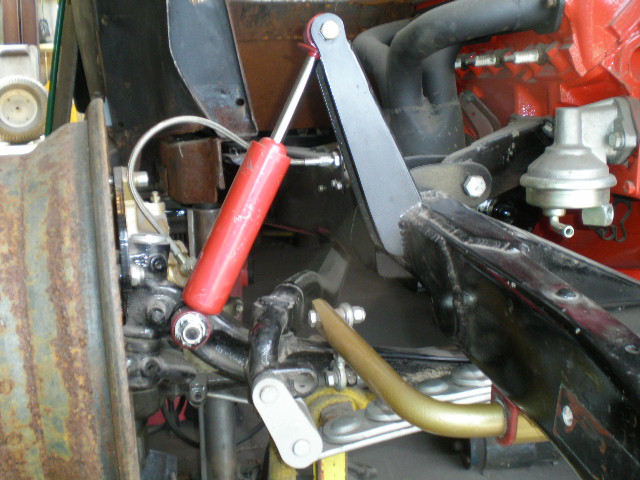

  25. Here's how I put the front shocks on my '47.
    Stock mount on axle, fabricated frame mounts, Chassis Eng adjustable shocks.
    I used Chassis Eng shackles with the Posies spring. Seem like they are decent.
    I haven't made the panhard bar yet, but will make it out of 7/8" DOM and Pete & Jakes bushings.
    I welded a double shear bracket on the left rail and will use a modified stock wishbone mount on the right.
    The anti-roll bar is from Weedetr Street Rod (weedburner 40 on here).

    got a good chunk of hours in with Sarah before we called it quits. We managed to get the brakes finished on the passenger side front, was a little bit of work getting the new rubber line to work with the stock frame rail tab but 45 minutes of grinding and cutting we got it fit :) unfortunately as soon as it was all bolted up we found that the caliper bracket hits the bolt that locks the king pin in place because the nut etc on the bolt is so long :( so its all gotta come back off and get notched. color me impressed.
    after that we got the fan spacer and fan bolted on... after realizing that we had to pull the radiator out to get the bolts in. let me tell ya, rubber hoses that are clamped down pretty good do not want to come off when its that hot out :S either way we got it out and got the fan on with juuuuuuuust enough clearance to feel ok about it and sarah put the rad back in and got all the cooler lines and rad hoses connected. The lower is the 3rd hose but we finaly got it. the first try the diameter was wrong, the second time i cut to much off, the 3rd time golden!
    we also measured with a string for the alter belt since ive bee having bad luck grabbing the correct one from the store.

    got a whole bunch done. Sarah had the weekend off and came to help me from sat night to monday afternoon, man stuff goes so much faster with two people!
    she picks up on stuff super fast. We found that the brackets that hold the calipers on that came with the speedway kit hit the king pin locking bolt. which in stock configuration worked as a steering stop but with the bracket face being about an inch further in it wouldnt let us steer but an inch at most.
    in the above photo i was setting everything up to notch the brackets and when i turned around she had stripped everything off down the the bare spindle and gave me the bracket to cut. got it done and when i finished the second bracket she'd already re assembled the brakes on the first side!
    If i hadn't already asked her to marry me I would have then!
