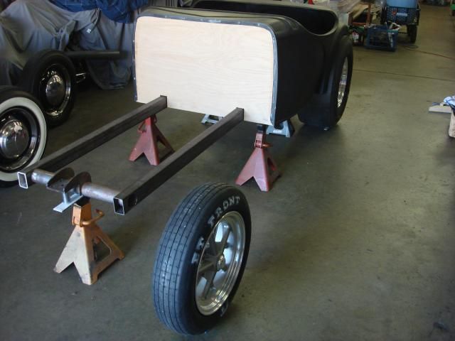

    Ok, I did cut some tubing today. Since I have decided to go with the 4 bar for sure, I have gotten a lot of suggestions (thanks all). Ron Pope told me it would be best to put the front 4 bar bracket directly in line on the frame so that all the force is centered on the rails............made sense, so today I cut the side rails to 45 degrees each so that the kickup is now at a straight up 90 degrees. That way I can **** the 4 bar front bracket right up against the kickup and weld in in place there.
    To get the two side rails exactly the same length, I slipped the front round crossmember tube straight down through both pieces of frame tubing, clamped it all together, and then cut it on the bandsaw. But doing that they are identical in length and the cuts are identical.
    Then I slipped the two rails into the body and put jackstands under it all so I could see how it all worked out. With the front tires resting where they will finally be, my wheelbase is right at 100 inches.
    Now that I am moving the coilovers directly under the frame rails (instead of outboard of them) I picked up about 5 inches and am able to tuck the tires in much further. People are also telling me that a narrow rear will tend to keep the car going straighter than if I had the rear tires more outboard. I think the look is a little better too.
    Does this make my *** look fat ??? :D:D

    I agree with your friend Ron Pope.

    there is a reason why dragsters have narrow rear ends. it's not just aerodynamics.
