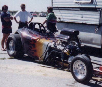

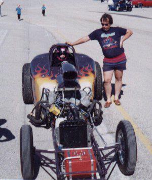

    Here are a couple of (bad) pictures of the Bantam I had back in '95. The car was wrecked when the steering wheel came off at 145 mph - the reason I will NOT have a quick detach wheel in my cars now.

    What kind of quick-disconnect did you have?
    And what, specifically, failed on it?

    It was a Wilwood pin style quick disconnect.
    Never really knew why it came off Brad. It had been checked at "strap in" time with the "tug test" but for some reason it released and came off right at the stripe.
    What made matters worse is that my crew chief was driving the car for the last p*** in his NHRA compe***ion licensing. Car ran a 9.04 @ 145 on that p*** as I recall. Anyway, he went on to drive an Alcohol Funny Car - won the National at Brainerd last year.

    I put a splined quick-release on mine. After asking for opinions over on Yellow Bullet, a lot of guys said the splined connectors are better than hex-style because the hex eventually gets sloppy. The pin-style connector also don't always lock, or the profile of the pin gets worn from sliding on and off the recess in the male part of the ***embly.
    I also like the 360-degree release ring... if I'm upside down and disoriented, I don't want to have to play "Find The Release Pin" on the steering wheel.
    Mine also has a second catch--push it all the way onto the splined end, and it catches. If you don't get it all the way on for some reason, and it starts to pull back off, it catches a second time.
