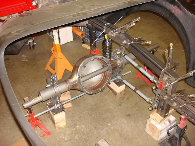

    Today Dan went to the steel supply shop and picked up some more 2 x 3 tubing so that we could spend the day figuring out just how the rear part of the frame needs to be to hold the 4 link setup. I got the new frame brackets I ordered from Ron at RPM, and also some 1.5 x .120 wall tubing from Applied Racing, so we pretty much had all the steel we needed to get going.
    The design we ended up with is a little unorthodox and different from the street setups we have done, but it looks like it is going to work. The back end of these Bantams is so short it is hard to cram all the stuff under one that you need. In a lot of respects, I wish I had gone with my original plan to run a solid mounted rear, but this will handle much better, I'm sure.
    Here is the mocked up result of our work today. The part that drops down under the frame is needed to let the lower bar lay parallel to the ground, so it drops down quite a bit. But we are going to run an 1.5 round tube out of that will curve up and join onto the bottom of the frame.
    The two round holes in the lower part of the mount are for the round tubes I mentioned.......one will run forward to the bottom of the frame, and the other will run over to the other kickdown, into a similar hole in that part. We figure this should tie in the entire rear section pretty well, when all welded up.
    Not much of what you see here is permanent, even the bars are s**** leftovers from another project, so it is all just mocked up to get an idea of how the final frame will look. But we did make major progress today, next week we can start prepping and welding it all up and then put it on the frame jig for final welding.

    Looks good Don. I'd like to see the tubing below the frame shortened about two-two and 1/2 inches and(cut just above the hole that the forward brace will run into), and re-drill that hole higher so that the two pieces of tubing ( the cross tube and forward tube) will intersect. Notch the forward tube to fit the cross tube( as you would with a roll bar).

    It has to drop down that far to allow the lower bar to be parallel to the ground. We actually shortened it up quite a bit by eliminating the wishbone hole in the bottom of that mount. We are relocating it to the round cross tube, and were able to gain about 2 1/2 inches. If it wasn't for the need to make the lower bar parallel, we would have that ability.

    I'm not understanding why you can't just drop the frame rail down to the bottom of the bracket.

    Are you going to put a drop in the lower cross member for driveshaft clearance or is the trans output high enough that it clears? I normally put the cross tube in line with the lower four link hole and a straight one will clear even with the engine/trans set low. Good to see that you got some frame brackets with an arc in the hole locations--it will make the initial ch***is set up a lot easier.
