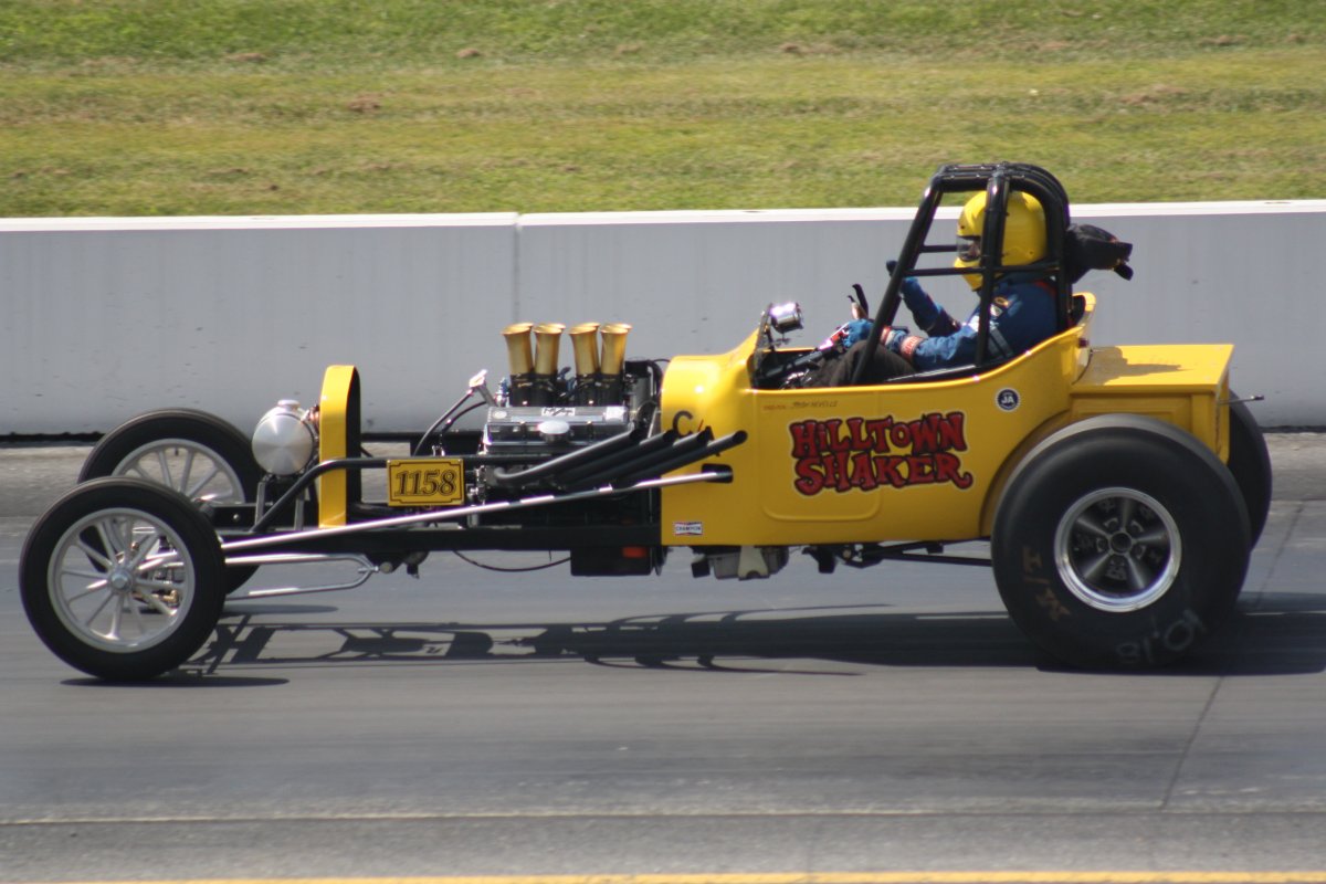

    We, have had a fun summer running the altered. ran a 9.58 at 135 at Island Dragway a few weeks back. I will be coming to Venice again for the horse show with my wife in January , would like to stop down to your shop and see the altered and all your hot rods, Hope all is well with your health,
    Paul

    Doing fine been racing all summer, we are done now, ran a 9.58 at 135 a few weeks back, car is working real well, i will see you in January

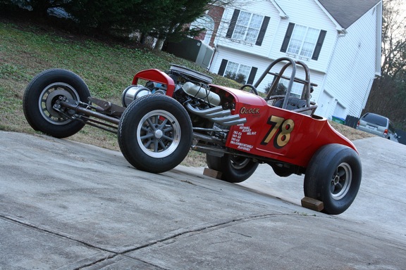

    My Hot Rod Deluxe altered project, mocked up for the final magazine story.
    Still needs to be plumbed, wired, several things need to be re-fabricated and modified... but the bulk of it is finished. I'll be working on it to debut (but not run) at The Gear Jam Drags in April, then plan on having it at the Hot Rod Reunion in Bowling Green, the Meltdown Drags, and a couple others this year.
    Engine made a little over 500hp for the story, and we found a crack in the block, so the new block and tuning put it at 514hp @ 5400rpm, and over 500lb of torque for most of the power band.
    Mopar 8 3/4 rear with two spools: one wearing 4.10 gears for the 1/8-mile, the other with 3.23 for the quarter. All the computer calculators say... well, they say "too fast!"
    I've got a hell of a learning curve ahead of me.
    The FE build is by far the most expensive part of this project. I scored the entire induction on Ebay, turn-key and ready to run, for $1,300; which is a GREAT deal for a factory 2x4, carbs, linkage, air cleaner, etc. etc. etc. But that was just the intake.
    A guy could build a 450-500hp small block Chevy from the swap meet for nearly what I paid for just the intake, and it'd be lighter than the FE to boot!
    I really think a vintage-style Altered is a great way to get into nostalgia racing on the cheap.

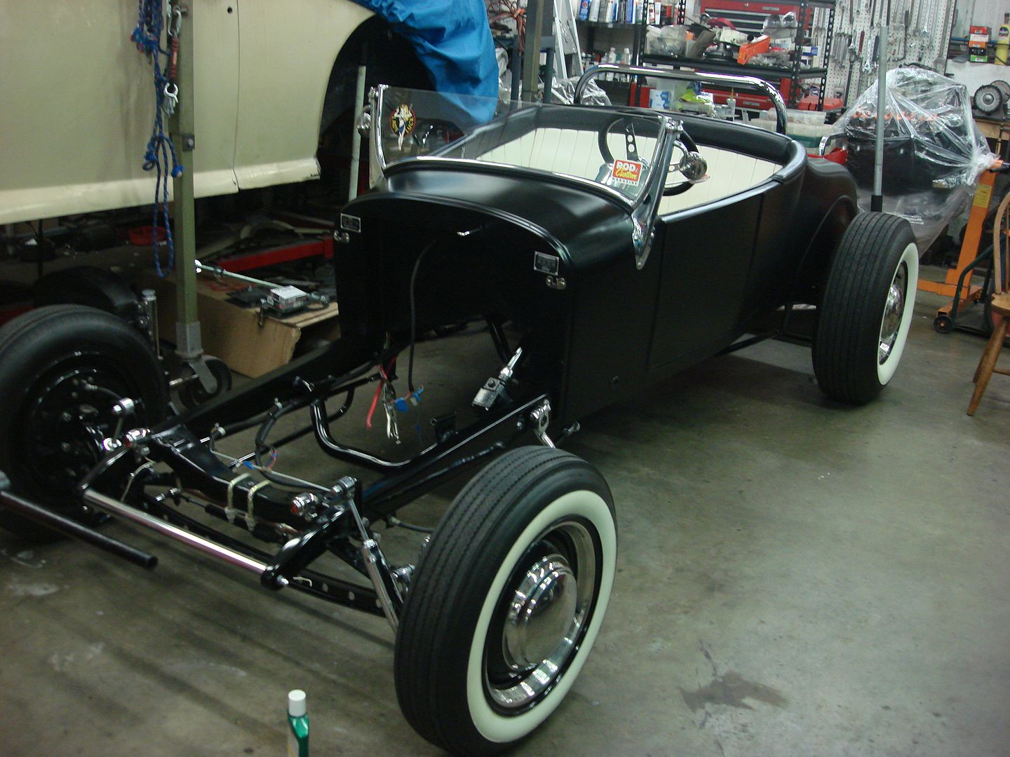

    Just the other night I was soaking in the tub and grabbed a couple of magazines to read while in there. One of them was the HRDeluxe with the article on your car in it. Enjoyed reading it all over again and stole a few ideas for mine.
    I'm doing some things to allow me to get back on my own altered project a little quicker. I have been hitting on the rpu, now the transmission and rear crossmember are installed. Ready to put the body back on now and start body work.
    Secondly, I realized I have more projects than years left, so I decided to get rid of my 46 Ford Tudor. I will never get around to it, especially if I ever start to actually race the altered, so I offered it to my two Sons. Dan has his Fox Mustang to do, plus his 30 Model A Tudor that is waiting in the loft, so he had no interest in it. However, Don did want it back ( I sold it to him at one time and then bought it back) so this time I am just giving it to him with all the parts and parts car that goes with it.
    I feel like a weight has been lifted off me, and I know he will finish it at some point, where I would not have. I would rather give it to him while I am alive than have him get it in my estate. This will free up space in our shop for me to get back on the altered. I want to go racing in the worst way, and all this clutter in my life was slowing that down.
    So maybe I will actually have some progress to post about sometime in the near future ! :D
    In the meantime, here is a picture of the transmission installed in the rpu.

    Don, you're a smart man! I'm 45, and have realized I've got more projects than years left! I want to go racing bad too. Got the Altered to a point where it's a roller, and in the next few months I'm going to ****on it up and get a '54 Buick back on the road, then... who knows?
    What trans are you gonna run in the Altered? I just got a carbon fiber trans shield, and it fits the powerglide like a skin, so it'll give me a lot more room for the floor. It was more expensive than the plate-style shields, but will make things a lot nicer overall. An inch here, an inch there, and before you know it, the interior is roomy!
