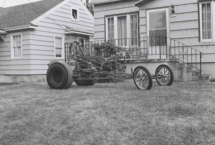

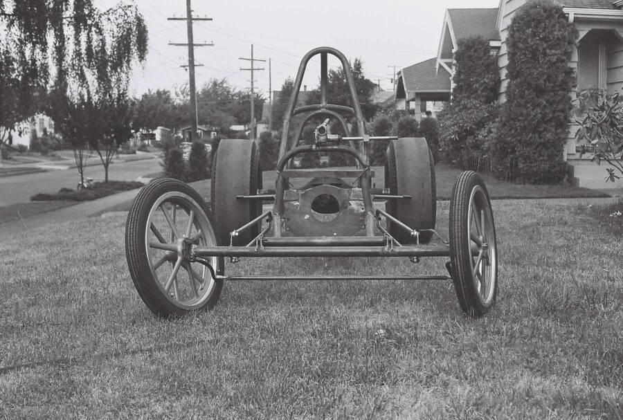

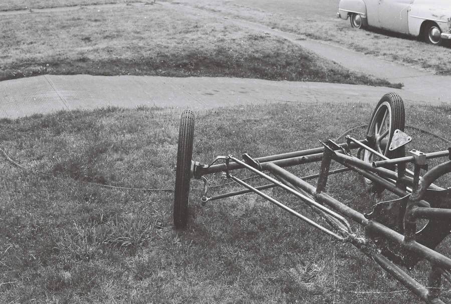

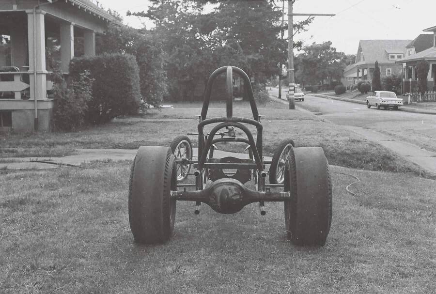

  10. TR who did you buy that from? Look at the roll bar notching and cut out and the wheel wells and then look below! Looks awful familiar!
    don[​IMG]
