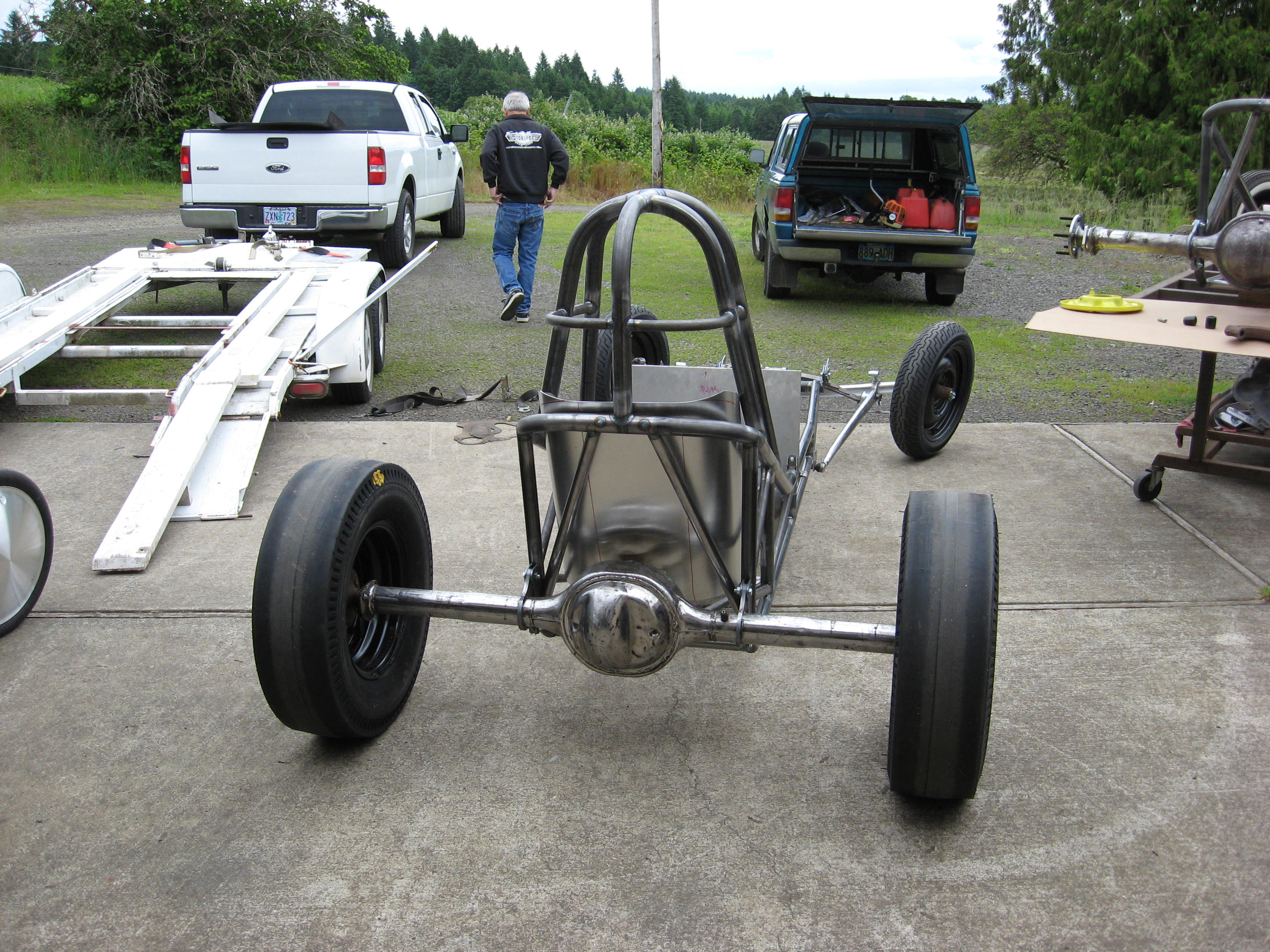

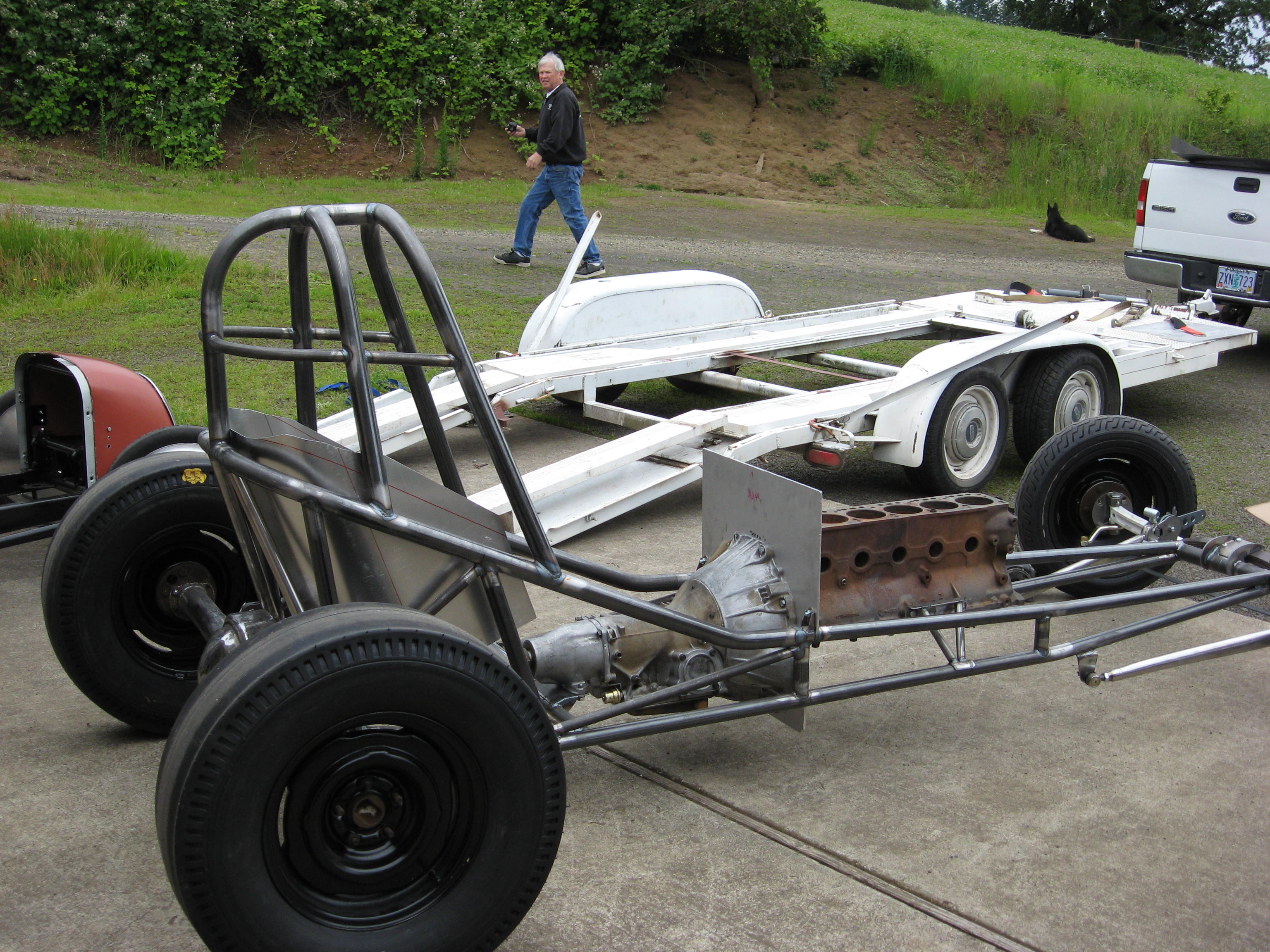

    Don, With you and your son's ability to bend, cope and weld round tube, why would you use a rectangular bottom rail? Many altered cars were built on this principle in the 60's, I think you would save weight as well. IMG_0591.JPG IMG_0595.JPG

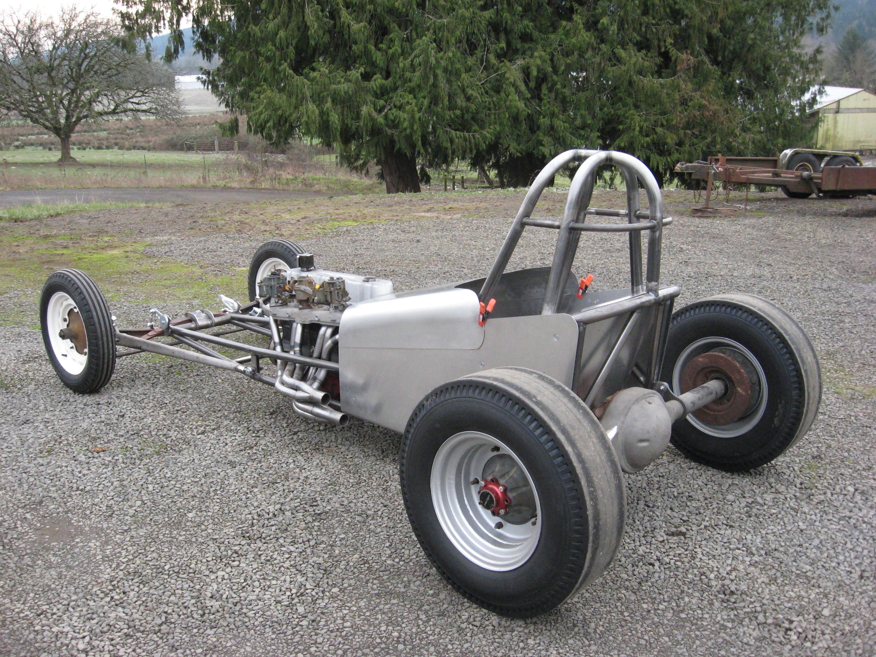

    Using the mid-plate for a firewall, as Rooman suggested, it makes it easy to get a good seal, this is how I finish it off inside. IMG_0935.JPG IMG_0937.JPG

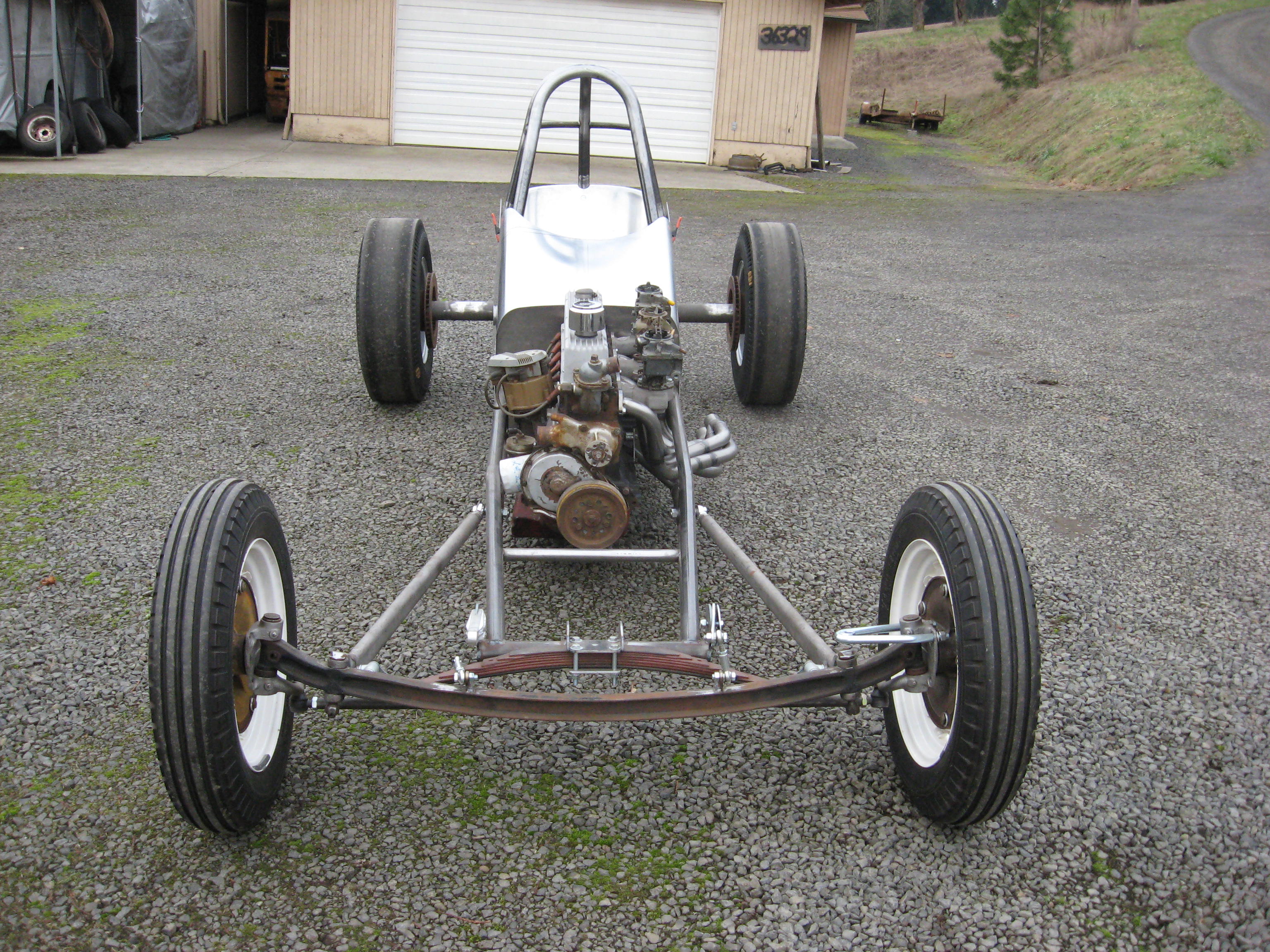

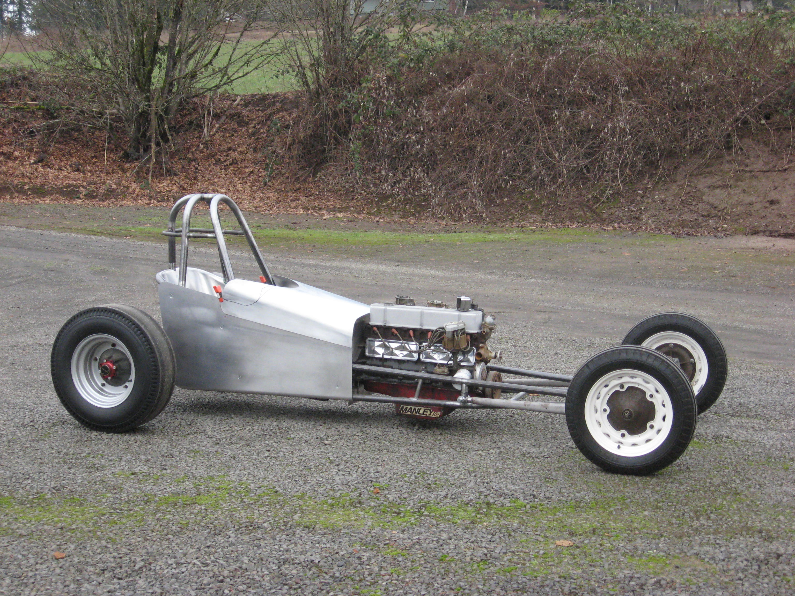

    The pics I have been posting are "my spin" on HAMB Dragster design. I built 3 of them a while back. This one has a 116" wb, and if it had been built at 100 to 105 inches it would work well as an altered. I chose a '40 axle because it is narrower than a '28 to '36, and I prefer that look. The "shorty" dragster style body would work well to enclose the driver. It could also serve as a tunnel extension to gain some leg room in a short body, IMG_0979.JPG IMG_0980.JPG IMG_0981.JPG such as a Bantam.
