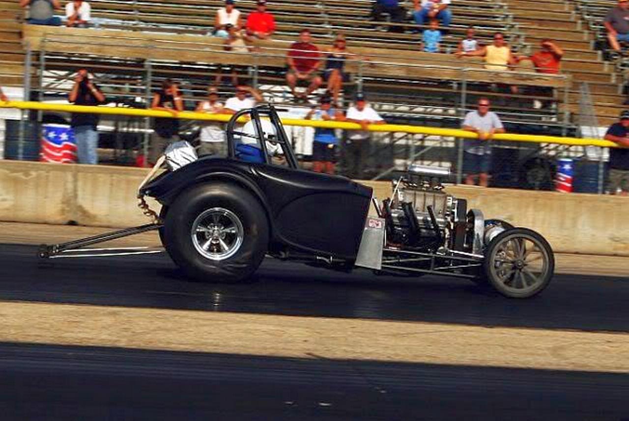

    This is a perfect example of why you better put some wheelie bars on it from the get go. :eek:
    Not mine just a guy that thought doing a giant wheelie to win the wheelie contest was the way to go ...I don't think it was worth it LOL.

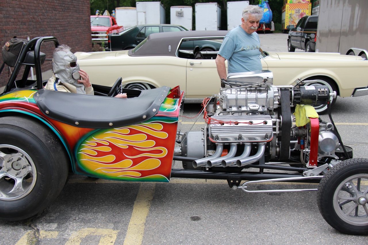

    The Bantam body's have such a short cowl that you almost have to move the motor forward. This picture of Ed's shows how far forward his motor is. Also note how far back the sitting position is. Me in Ed\'s Altered.jpg .
    Crumley, Panel Pete and loudbang like this.

    That is what I figured too. I already planned on cutting into the section behind the ****pit to move the roll cage back a little. I am not tall, but these things are pretty cramped as they come. I am also moving the motor up a little . That is a cool altered, BTW. Is that hoop design on his cage NHRA legal. If so, I like the way he did it.
    I see a lot of altered with little shields like his plexigl*** one on top of the cowl. What is that for ?
    Don
  15. old sparks
    Joined: Mar 12, 2012
    Posts: 414
    old sparks
    The shield is to comply with ,in my case , nhra rules. If I remember, 5" by 7". That cage wouldn't p*** tech at Bakersfield. The shield is supposed to deflect fluids and parts, which didn't happen for me.
