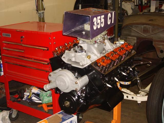

    I also picked up the 750 Holley DP that All American Carburetors remanufactured for me. It looks absolutely like brand new. They have done carbs for us before, and always do a great job.
    And........as stupid as it sounds, my very favorite find was this carb scoop I bought from Charlie at Vintage Speed. It came off of his dragster and has a bunch of win stickers on it. I will repaint it to match whatever I paint the body in, and probably remove the win stickers (sob :() I feel like I am destroying a part of history if I do, but I guess it wouldn't be right to run someone elses stickers.
