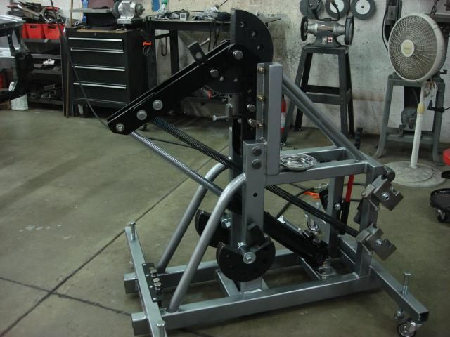

    As for the question "ididn'tdoit1960" had about a tubing bender, ours is one my Son Dan built from a ProTools version he cut up and modified. It takes 1 inch, 1.25, 1.5, and 1.75 dies, but mostly we use the 1.5 and 1.75. It will be getting a workout on this altered !

    And here I thought that was some sort of exercise equipment. On second thought, I guess it really is.

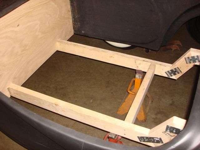

    Today I built my frame..............................................out of wood. :D Picked up a few 2 x 4's and started to figure out what the real frame should look like. I love building the mockup frame out of lumber, it is so easy to make changes , so much easier than if you make a mistake in steel tubing.
    My Sons have also talked me into making one radical change from my original plan. I am going to run coil overs and a 4 link rear setup instead of the solidly mounted rear I was thinking of doing. The main reason was that to look right the frame had to be kicked up 6 inches in the rear, otherwise it hung down under the body too far. That moved my rear tires way up into the body, so the only way to move them back down was to put some suspension back there.
    It will probably be better in the long run. I can fine tune my launch and the ride down the quarter will probably be a little softer on my old behind.
    So, here is my wooden frame. The front crossmember will actually be round tubing and the second one (that supports the rear of the Moon tank, will be something like 1 inch diameter round tubing. I may make up a sheet metal panel to go over the top to dress it up, and may send it to Need Louvers to have a few louvers punched in it. All that is just planning though, and won't know till I get to that point.
    Then we slipped the body on to see how it fit:
    My favorite view of a Bantam:
    A picture of the interior:
    And back under the body where my battery and rear end will go:
    Oh, and I was able to pick up a couple of inches in wheel base. It should end up at 102 or so. Even better.

    I know you're trying to build the altered as somewhat period correct, but going with the coil overs and 4 link is a smart move. Once you get the suspension dialed in and find the right tire pressure for the track, it'll make the actual racing fun. Having to use the rear tires as the only suspension tuning parameter on a solid rear end can be hit or miss throughout the racing day.

    Yeah, I am starting to realize that. I was determined that this one would be simple and a solid rear was what I had always planned, but I agree this will make it better.
    Ya know, I don't think I have ever built a car that ended up being what I started out to build. As it goes along you start finding reasons to change what you had planned, but somehow it does make a nicer car in the end.

    Looking at the pictures, it looks like the kick up starts right where you'll be sitting. I'd try moving that back as far as possible to gain seat and leg room. Even if it is only 2 or 3 inches,it can make a huge difference.

    I also think the suggestion that the kickup might start too far up in the ****pit is a good one. I considered that myself, but needed room between the kickup and the axle. These damn Bantam bodies are so short in the rear that it doesn't leave much room for suspension and all that stuff. BUT, I am going to take your suggestion and see if I can shove the kickup back a couple inches more to give me more hip room. I do want the rear slicks centered in the wheel openings though, to look right. (I hope Home Depot has more 2 x4's:p)
    I may be able to actually use the mockup I have by sliding the body forward a couple of inches on the frame. I left 35 inches between firewall to grille shell and was being generous with that. I could get by with less plus I will be using smaller diameter tubing for the rear Moon tank mount and can pick up an inch or so there. In any event, I have a lot of room to play with and I don't think I will need a ton of room between the rear axle and the kickup, just enough for the rear end to move up and down a little without hitting the kickup. It is probably getting to the point where I need to order my slicks and rear wheels so I can make a dummy rear end up and see how things will really fit back there.

    OK, since you are considering a 4-bar I think you should consider putting some taper into the frame rails. Most 4-link front brackets are attached at the frame kick-up. So moving the kick-up rearward will mean your 4-bars are starting to get really short. By spreading the frame rails apart a few inches in the rear you could give yourself more seat room but not have to shorten the bars excessively. I think you want to keep bars at least 12-14 inches long. Juggle things around back there until you get it all to fit.
    Another (less desireable to me) option would be to put the suspension on the outside (or inside) of the frame rails. That would give you a place for longer bars at the expense of not having the rear bar heims in a double-shear mounting condition. I have seen this done on another rigid car that was converted to a 4-bar set up. That is also how it is on my Logghe car, which I converted from a ladder bar setup (too violent) to a 4-bar by adding another outboard attaching point and another bar:
