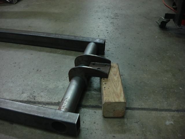

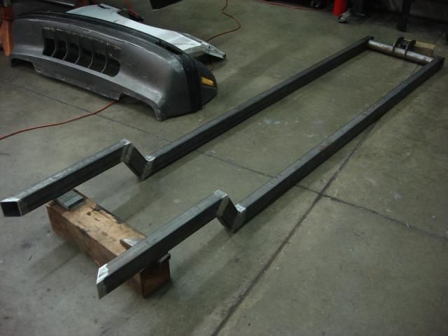

    This afternoon I went to the shop and cut the 2 x 3 tubing into the correct lengths for the side rails. I deviated from the wooden mockup by adding 2.5 inches to the front and 1 inch to the back. It will look less stubby, and my wheelbase will end up around 101 or so. I chucked all the side pieces into the bandsaw and cut 60 degree angles on all the pieces, and cut two at a time so they are mirror images.
    The last couple of frames we built we did the front tube crossmember a little different than we had been doing them, and it really gives a much stronger weld. Normally, you just punch a hole in the inner wall of the tubing and slide the round crossmember inside and then weld around the inside wall and tube. Even welding the front part that you roll over the edge still doesn't give a full weld on everything.
    So, what we have done recently is to punch the 2 and 5/8 hole through BOTH walls of each piece of box tubing, then we weld a round cap on each side of the tube crossmember that acts as the new outside wall. We fully weld that cap to the outside wall, then fully weld the inside wall to the tube too. Then we roll the top and bottom edges of the box tubing around the front of the round tube and weld it even more. It is hard to describe, but it makes a very strong structure when it is done.
    Dan came over and helped me holesaw the front holes in the frame rails tonight, but he will be out of town and next week will be the first chance I will have to get him to weld it all up for me, but I have a lot I can be doing in the meantime. Here are some pictures of the frame pieces that I laid out tonight after cutting them.
    That hole you see in the outside rail will be capped and fully welded in place, and the square front will be cut out and rolled over the front edge to make it look nicer.
    This will sort of give the idea of how it will end up. We did the exact same thing on my Sons blue T bucket and on my 23.

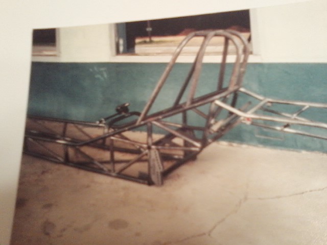

  20. Don, when we lived in Florida I built several altereds and roadsters. I found pictures of a couple of altereds with suspension we built. Maybe this will be of some help,please keep in mind these were built some 20 years ago ,so they are a little outdated. I never built a Bantam,only 23s and Fiats. I had a good friend whose last car was a Bantam. I always liked his car. I check your progress daily, looking forward to see the finished car.
