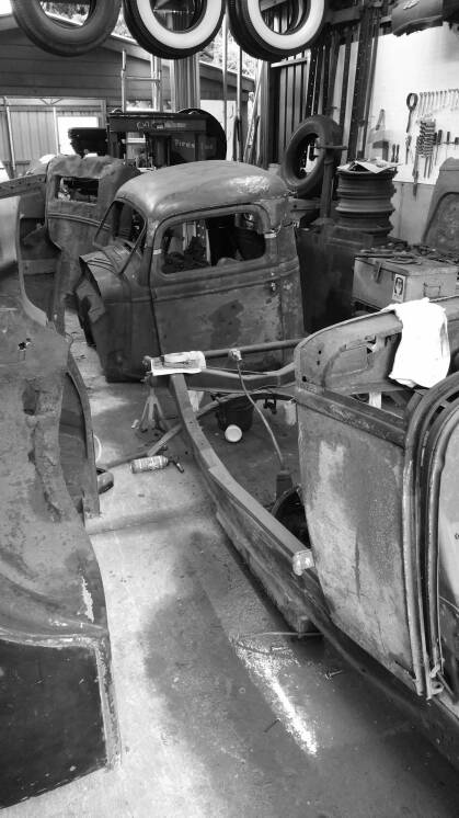

    [​IMG][​IMG]straightened the dings out where I drove into a motel veranda with it on the back of my ute[emoji2]... and it's time to chop a top![​IMG][​IMG]started at 3" and decided it needed more. I went to 3 3/4 and it will end up at 4.5". Plenty of rust to be cut out of this one so the bigger chop I do the less rust replacement I will need to do[emoji2]![​IMG][​IMG]. Finally back in the shed from my slow recovery. Surgery next wednesday to remove screws from my foot[emoji54].

    [​IMG]I also found the time to repair these tired 32 panels with the intention of building a pickup cab from sedan parts... I've seen a few photos of this and heard it was a common conversion in South America a**** other countries. [​IMG][​IMG]doors were rough! I figure I'll take the taper out of the door tops and square up the fronts of the sedan doors where they meet the door jam.

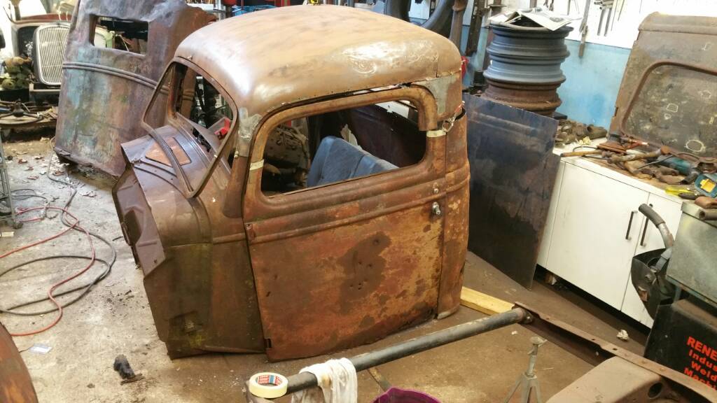

    [​IMG]4.5" chop now. I'm happy with the height and overall look! Just have to get everything else to fit[emoji2]! Plus all the patch work in the back of the cab!

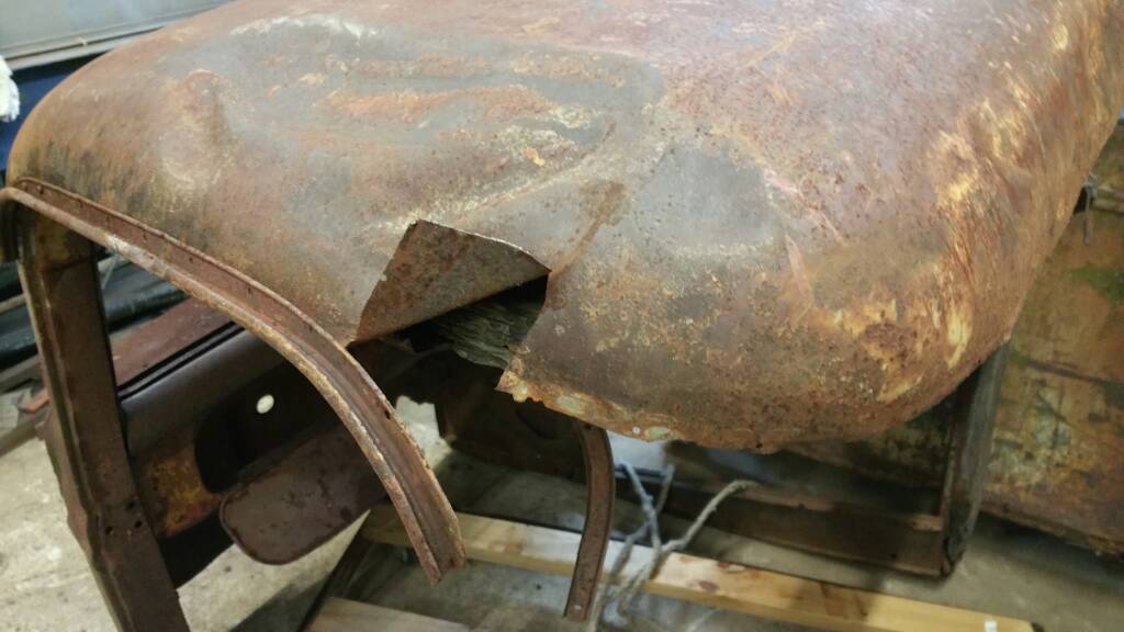

    I thought I'd share a few pics of the 35 I'm working on to help fund the 32.[​IMG]4.5" chop top. I bought three cabs and sold the 38 with a 42 for patch panels, but kept the rear panel of the 42. The rear panel of the 42 will be used to patch the 35. The 35 was missing the inner latch panel of the cab so the 42 one will be used. [​IMG][​IMG][​IMG]I see alot of the process as increasing my skill level as well as saving some old metal that was honestly grabbed from the s**** metal yard! I'm excited about how this 35 will turn out and it will make someone an excellent project that will be ready to drop on a frame! The 35 sat on it's back for many years! [​IMG]
    Sent from my SM-N910G using The H.A.M.B. mobile app
    The steel structure of the 42 will also be a good addition to the 35 cab as most of the 35 structure was timber. I was lucky enough to pick up a rear window for $10 around a year ago at a swap meet, I thought it was too good not to grab for that sort of money. 12 months later and I'm pretty stoked that I picked it up.

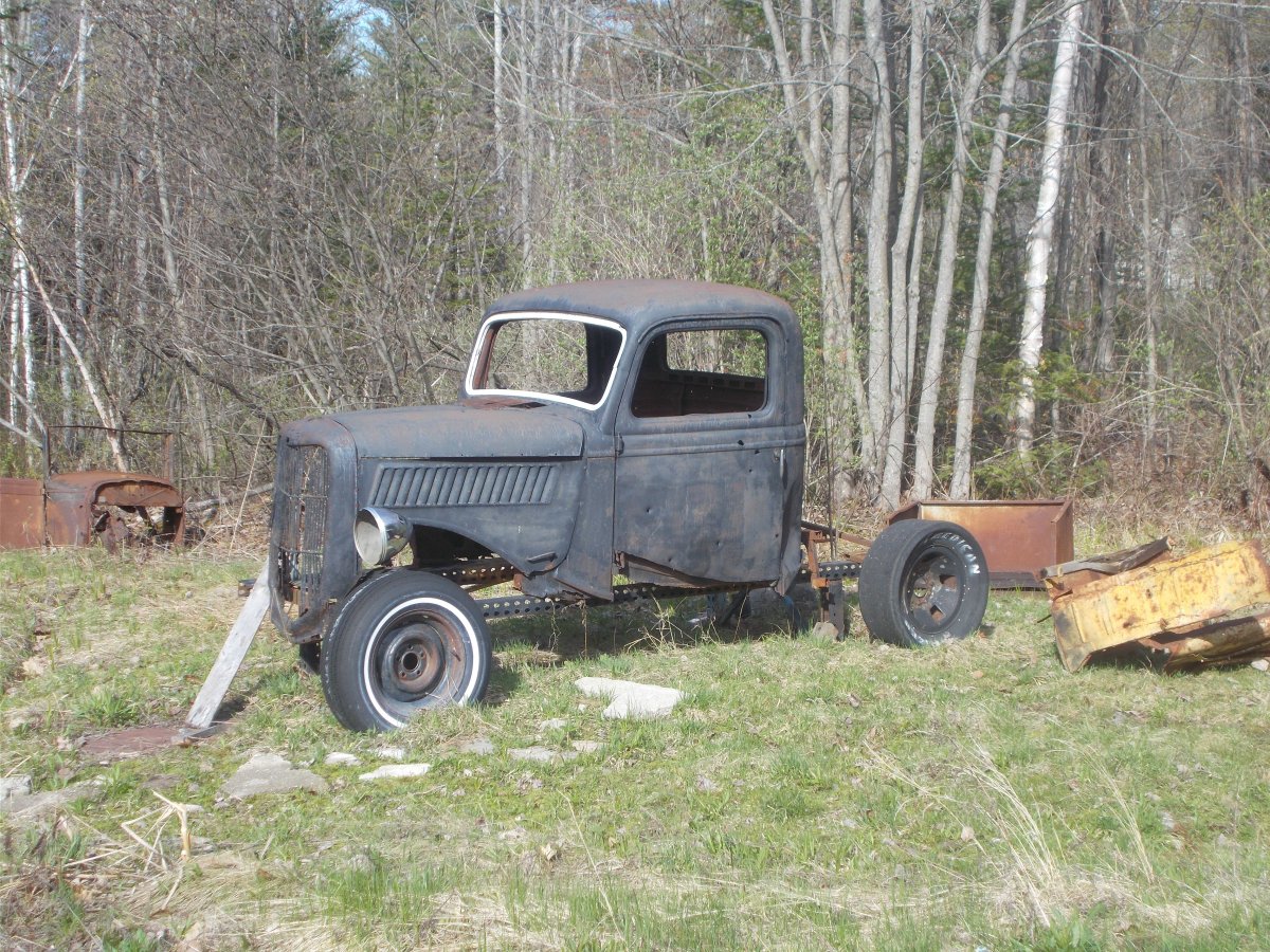

    wish you lived closer to 04210... my landmark '35, for a split second p***ers by see what looks like an old truck out back... she has no right side... note the landmark cabbie in the woods DSCN0564.JPG

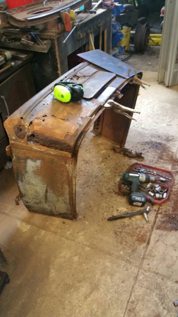

    So, I decided the top sheet metal of my 32 roadster cowl had to go. It was rusted from the inside out because my roadster sat upside-down for quite a while.[​IMG]I took the sheet metal from a dodge bonnet that wouldn't sell.[​IMG][​IMG][​IMG][​IMG]I have cowl vent parts to go back in as well.

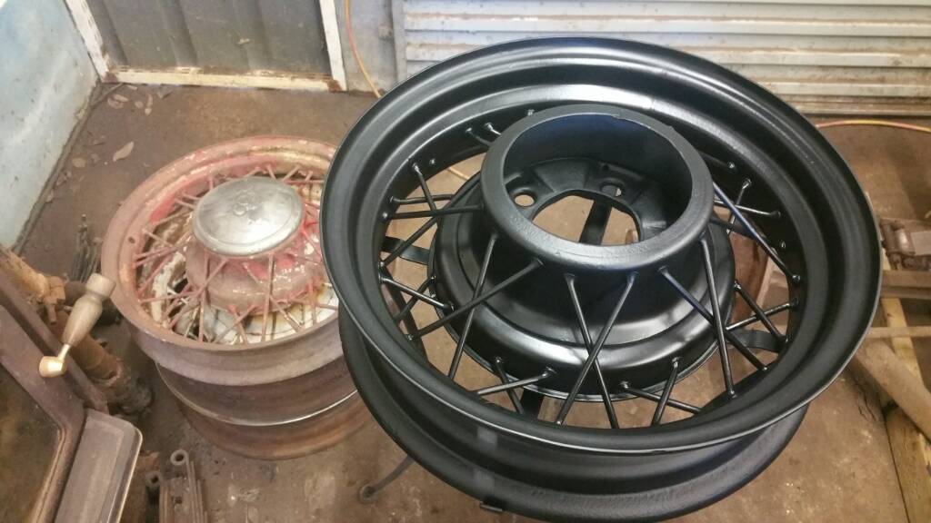

    Drylake
    I spent some time yesterday filing, sanding, straightening, welding, grinding on my 35 wires. I had five of them abbr***ive blasted a while back. I Painted two of them today. I'm hoping to get the tyres on by the end of the week.[​IMG]

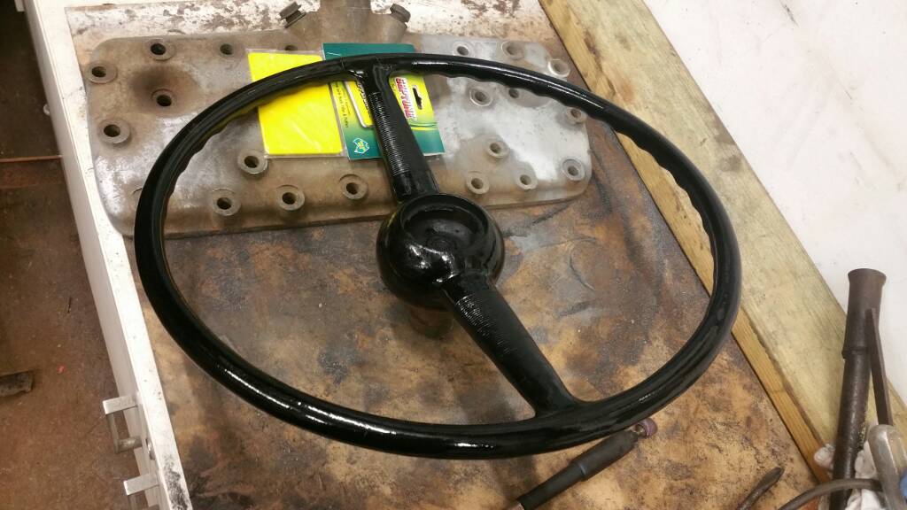

    Drylake
    A little more progress. Played around with column drop parts I picked up. Not sure if it'll work for the 32 but what the hell. I cleaned it up anyway.[​IMG][​IMG]half 32 Desoto, half 27 oldsmobile I believe[emoji2].[​IMG]cleaned my 40 wheel up a little and started to clean up a replacement head.[​IMG]also played with the idea of using these little oil filters as air filters. Might modify the tops and use these fins from a 33-34 dodge bumper....maybe[emoji51].[​IMG]

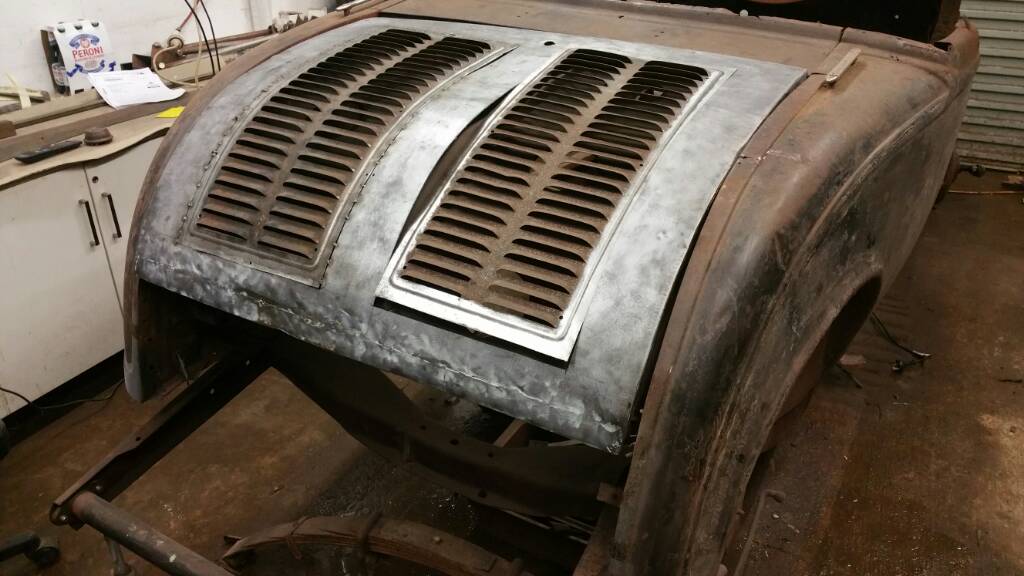

    Drylake
    [​IMG][​IMG]started on the louvres. Couple of issues with the deck lid that I need to straighten out. Bit of a twist in it and the bronze welded lower patch has to come out as it's pretty crude. Had about 10mm of bog in places as well.

    Drylake
    [​IMG] I'll have to get a little pin striping to fill the gaps between the runs of louvres when it's done[emoji3].
