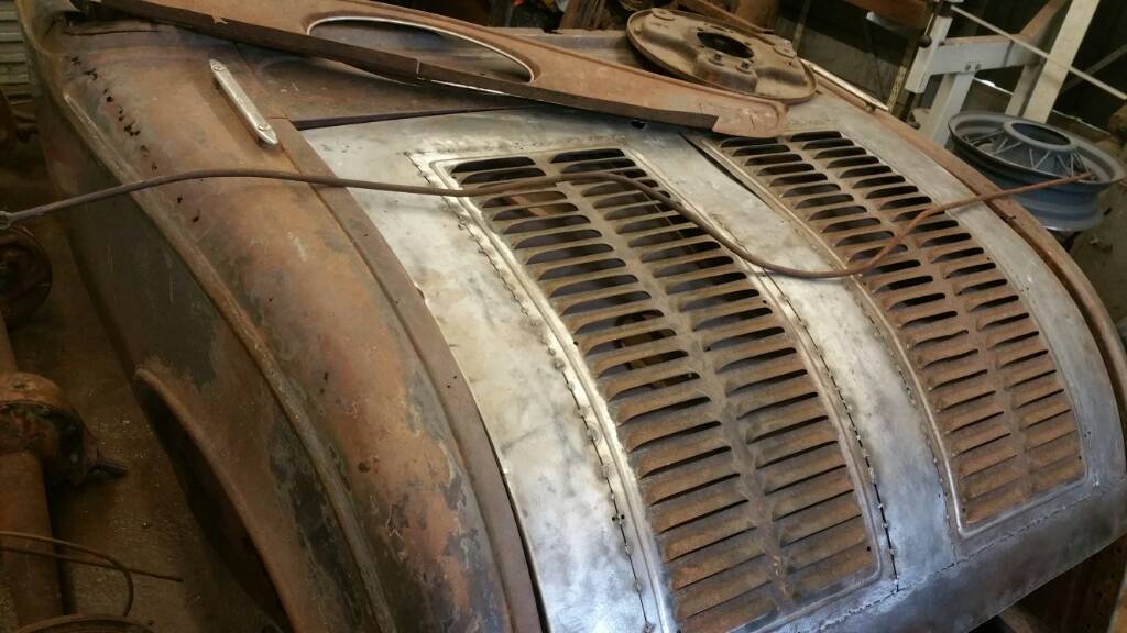

    Boy...I don't know if I like that or not. It's a shame to fuck up a decent deck skin. Maybe I am not seeing the total picture but that just doesn't look right.

    Strangely enough I think I like it. Get some paint on there and it will blend in much better to the untrained eye. Pinstripes even better.
    These cars don't all have to be the same.

    The deck lid skin had a huge amount of filler. So there's nothing "fucked up"..... or wasted. we'll just have to see how it comes out with some paint on it. The patches that were in it were bronze welded, and distorted. I don't mind honest opinions, as long as they're constructive. [​IMG]Pretty hard to see how much filler was on it, but there was alot!

    In saying that, it's only metal. If I find I don't like it once it has some colour on it, I'll just re-do it.

    [​IMG]Shame about the shed flooding over night... but the proportions of the louvres work for me.

    Louvers look good to me! Something different, and that's nice.
