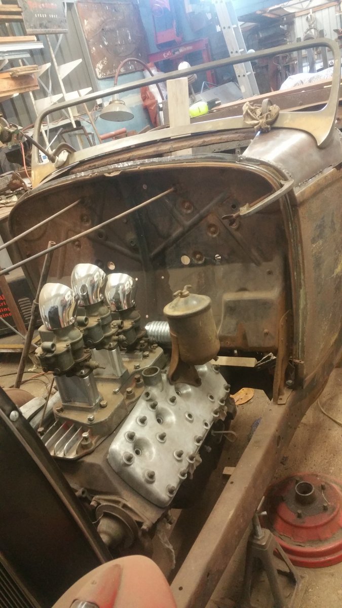

    [​IMG]New rings and a good clean up this weekend. [​IMG][​IMG][​IMG]I've been easily distracted with other ****![emoji23]

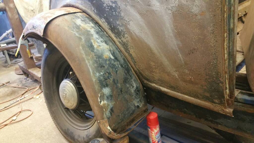

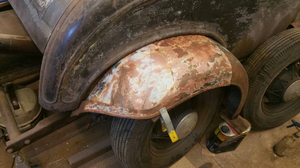

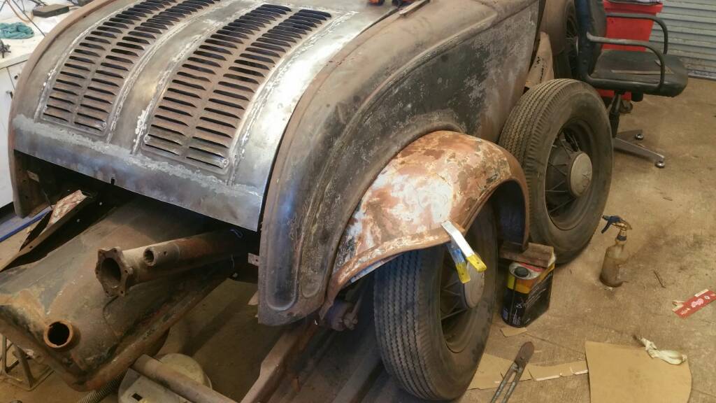

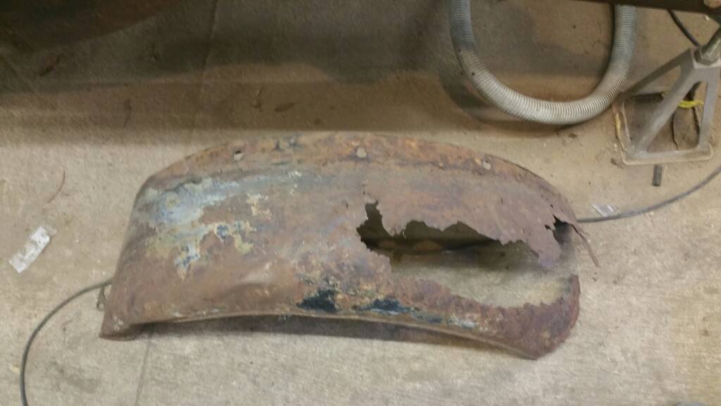

    I've decided to bob the rear fenders, or what was left of them anyway. I have in mind what I want and had a play last night. I want a continuous swage on the border of the fender to make it look kinda factory and less hacked up. One of the keys I think is making them flow. [​IMG][​IMG][​IMG][​IMG]I'll shorten the front to line up with the body line and radius the corner. I used a couple of bedford truck fenders I found in a pile of rubbish to help with the shape. [​IMG] not the same as these but similar and a better finish with a continuous swage on the fender.

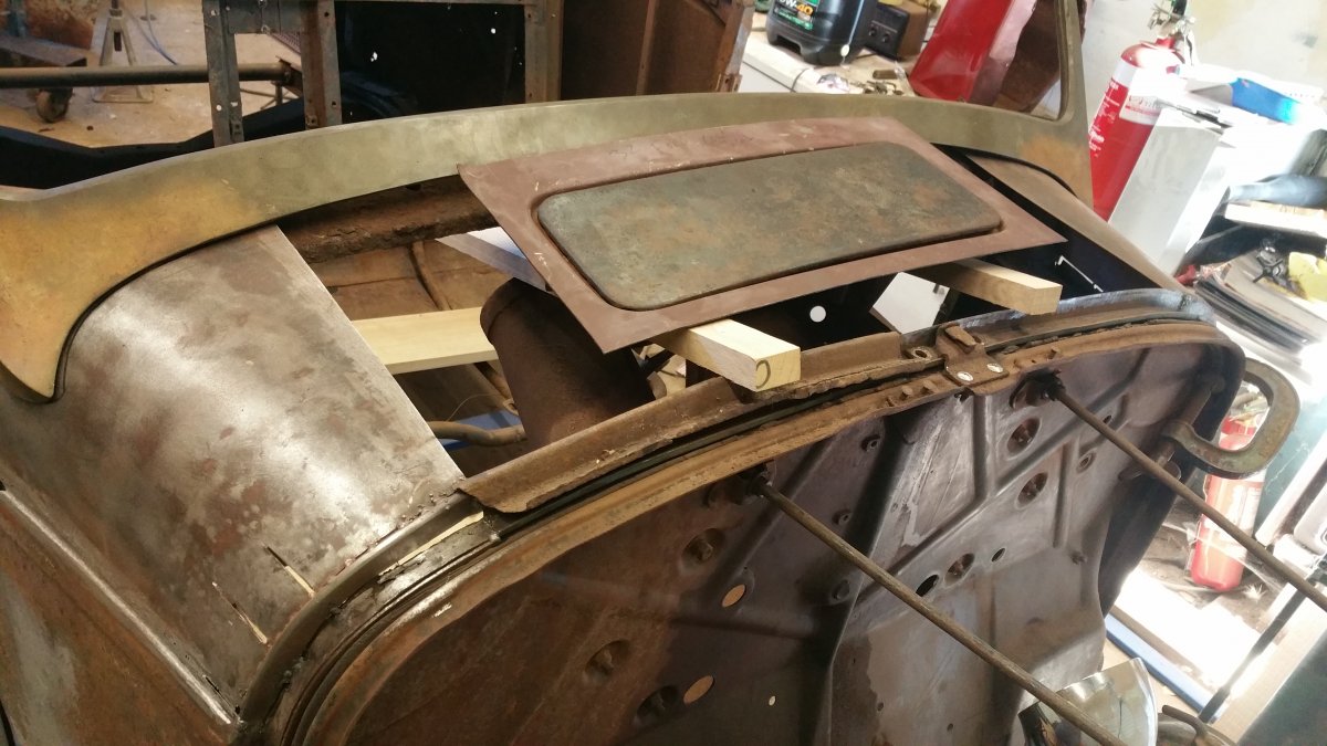

    Weather was **** but I still had a great time! Rushed home and sold some parts, which were less important to me than the parts I had just aquired. Making sure I had money left to pay the bills... because I had a few days of leave from work organised, I spent monday and tuesday in the shed cleaning up my parts and working on the 32! Made up my door patch on the english wheel and tried my skills at annealing. Working on the stretched section in my door, which needs more work, but looks alright. I also wheeled the upper cowel patches and formed the front chanel out of 20×20mm square tube. (I cut the first attempt out). Splitting the tube with the grinder after I bent it. I also have a patch coming for the cowel vent soon I hope... 20180227_172602.jpg

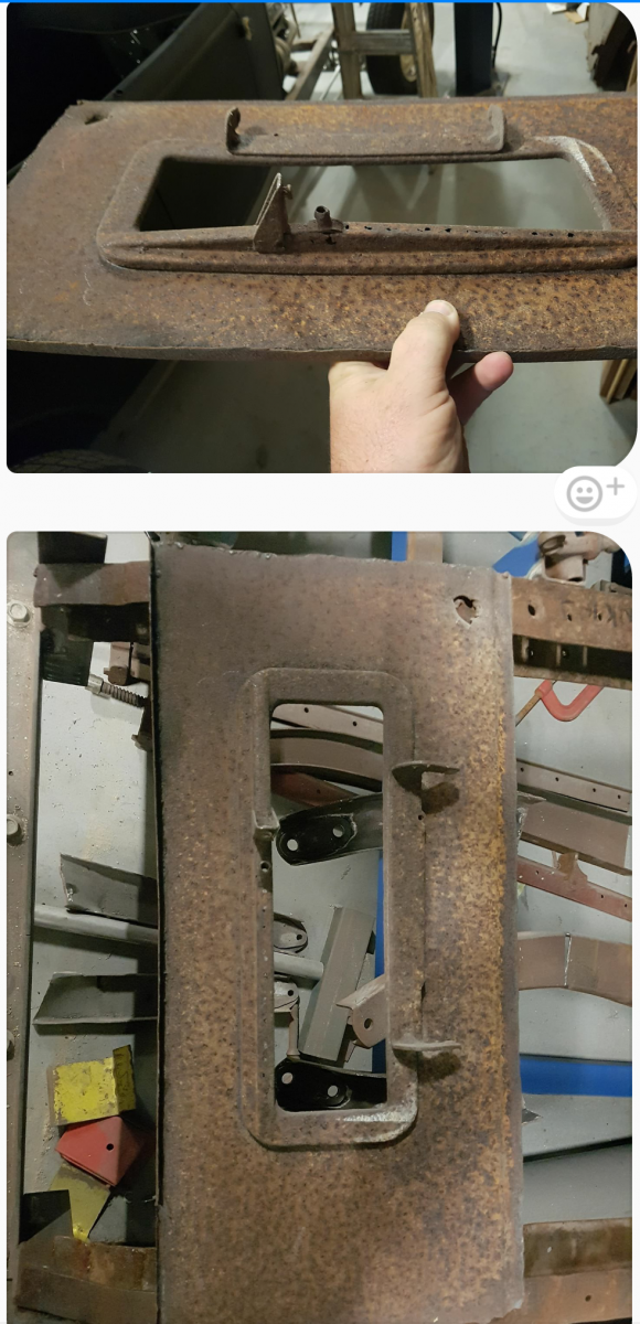

    I've managed to get a hold of a couple of cowel vent patches for the roadster. One looks quite good, the other has pin holes in the chanel of the cowel vent, but has the front swage. Swapped some nice windshield posts for the pin holed patch, I hope I don't regret it! Screenshot_2018-03-01-06-31-02-1.png Screenshot_2018-03-01-19-19-24-1.png

    Those are the posts I'm swapping... I haven't seen these patches yet in person, but I'm sure I can make them work!

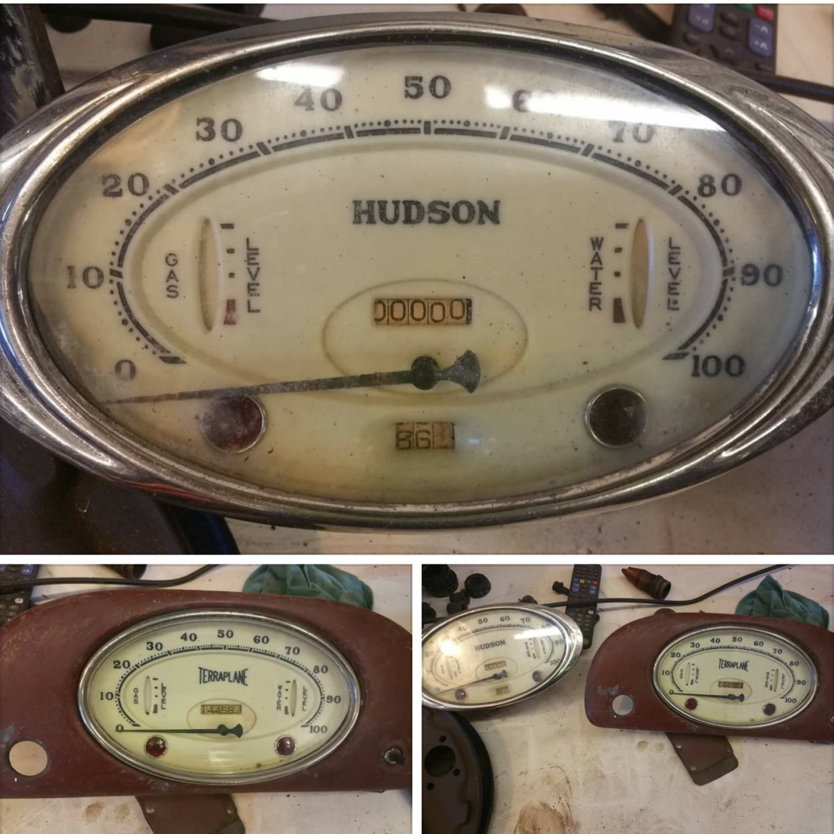

  20. Nice gauges-"Water level" - that's a new one- are you going to hook it up, and how does that work?
  21. Drylake
    Joined: Jul 17, 2016
    Posts: 737
    Drylake
    I think it's "water" - (temp)"level" I like them but in the roadster they just didn't look right to me. I moved them on and used the money to take to the Ballarat swap meet. They do look nice though!

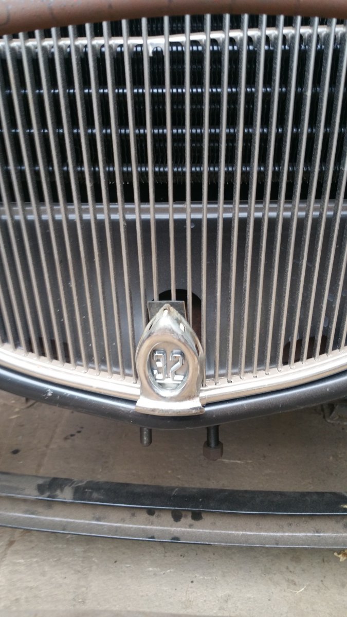

    Did some polishing today, picked up a coil for my finned cover, "U" bolts for the front spring and purchased a cheap and toasty sectioned grill mainly for the crank hole bezel.

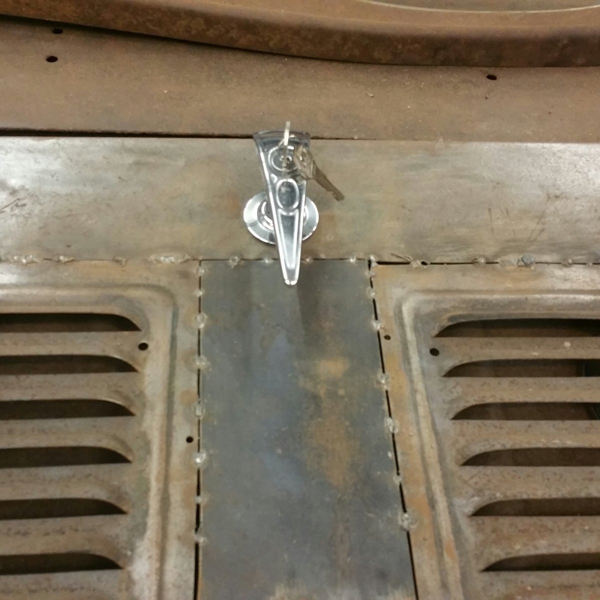

    Both my patches arrived today and my 37 deck lid handle is on it's way! Screenshot_2018-03-05-06-47-37-1.png

    Original bezel came with a sectioned insert. If it was full height I'd repair it a little, and run it!
