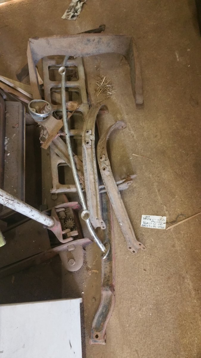

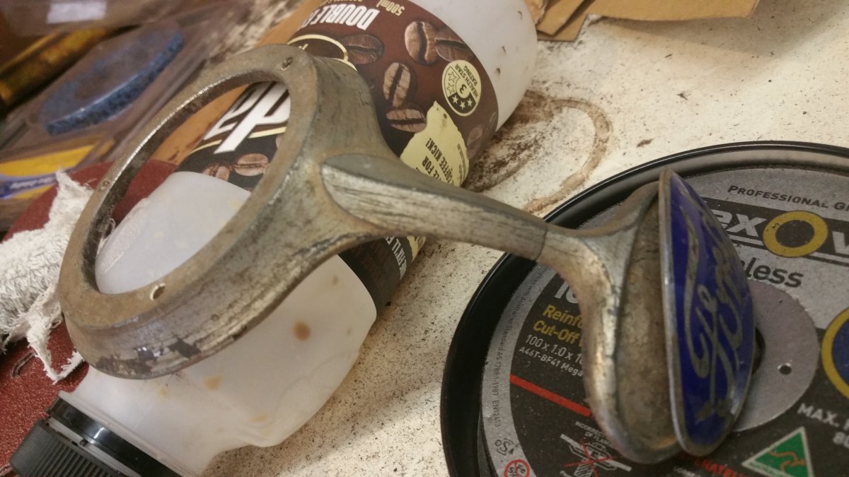

  11. Drylake
    Joined: Jul 17, 2016
    Posts: 738
    Drylake
    Been a good day. Slowly patching my rusty roadster and had a pallet of goodies arrive today from interstate which I purchased online. Worked out far better than I expected! 32 heavy, rad shell badge, door latch sets for closed and open car luggage rack, headlight bar, rear fenders x3, front frame horn cover, set of door hinges, front fender backets, rear bumper irons, rad support rods, hood stays, tail lights, bug catcher scoop, headlights, front spreader bar, deck lid handles and latches! Early Christmas for me! Left overs from his street rod build! All for $250... 20181211_132829.jpg

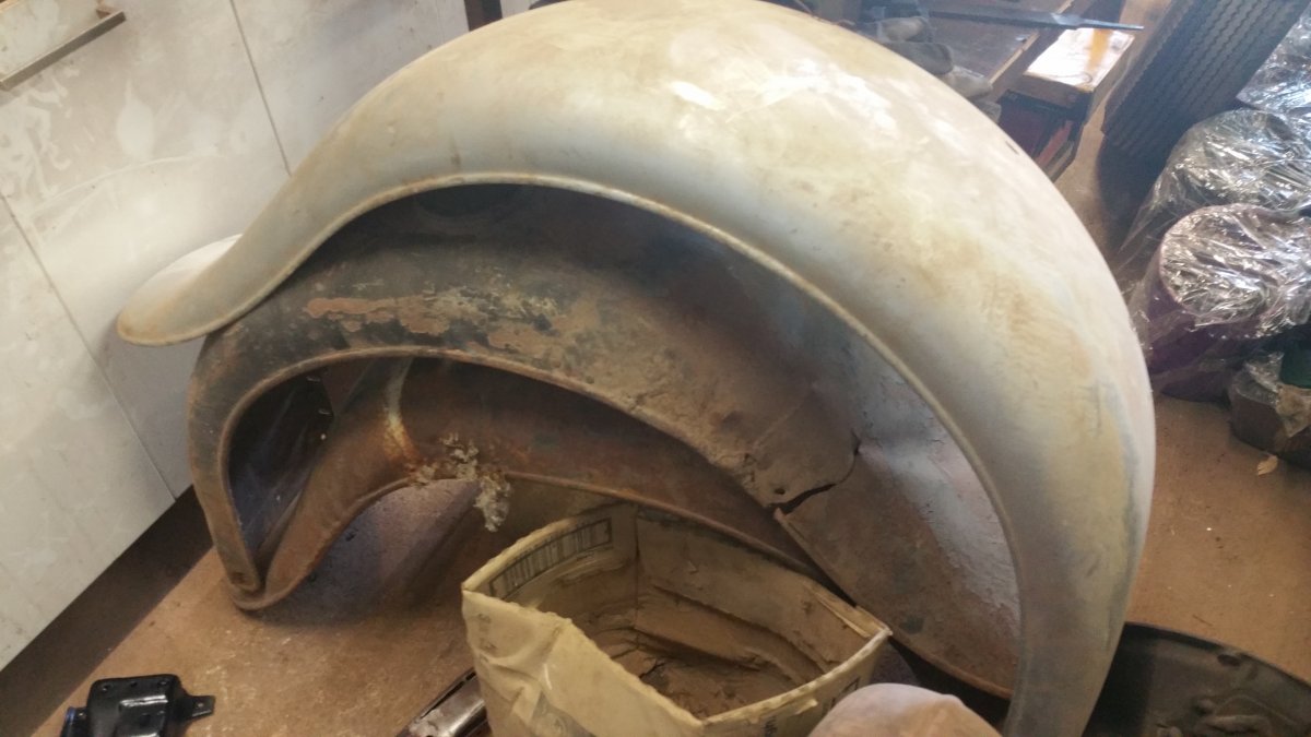

  18. Drylake
    Posts: 738
    Drylake
    Here are some photos of the parts I recently aquired. Spreader bar has the same colour paint as my car under the silver. Also made a basic tach mount yesterday. Some of the parts have already been sold such as the scoop, but there's a few parts a****st them I was chasing! I plan to have the 32 heavy dropped at a later date. 566531505.jpg 20181211_181759.jpg 20181213_185340.jpg 20181212_191129.jpg 20181211_140447.jpg 20181211_182333.jpg 20181211_140349.jpg 20181211_140428.jpg 20181218_101947.jpg 20181218_185006.jpg
  19. What's the info on that scoop? Would look rad on top of my Holley 94 ;)
  20. Drylake
    Posts: 738
    Drylake
    Already sold the scoop mate. The parts I picked up had some rego papers from june 1954 at the bottom of a crate which is pretty cool. The scoop sold for $250 which offsets the cost of all the parts I purchased. Also sold the gl*** rear fender. The majority of the parts I will be able to use.

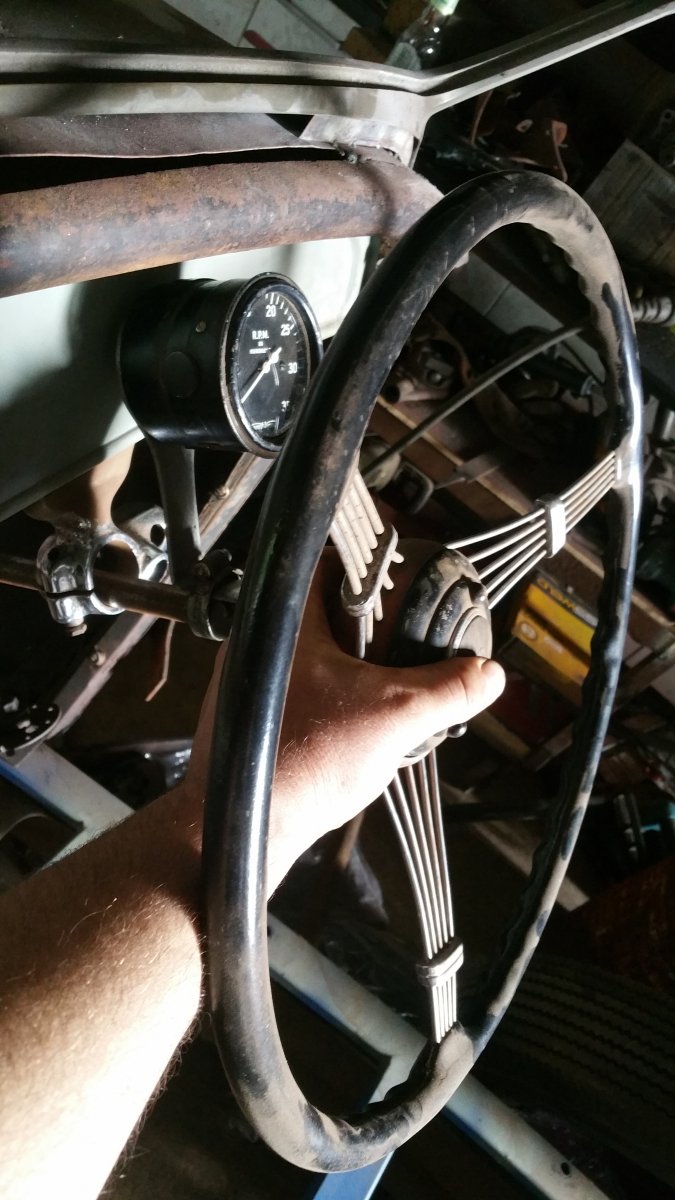

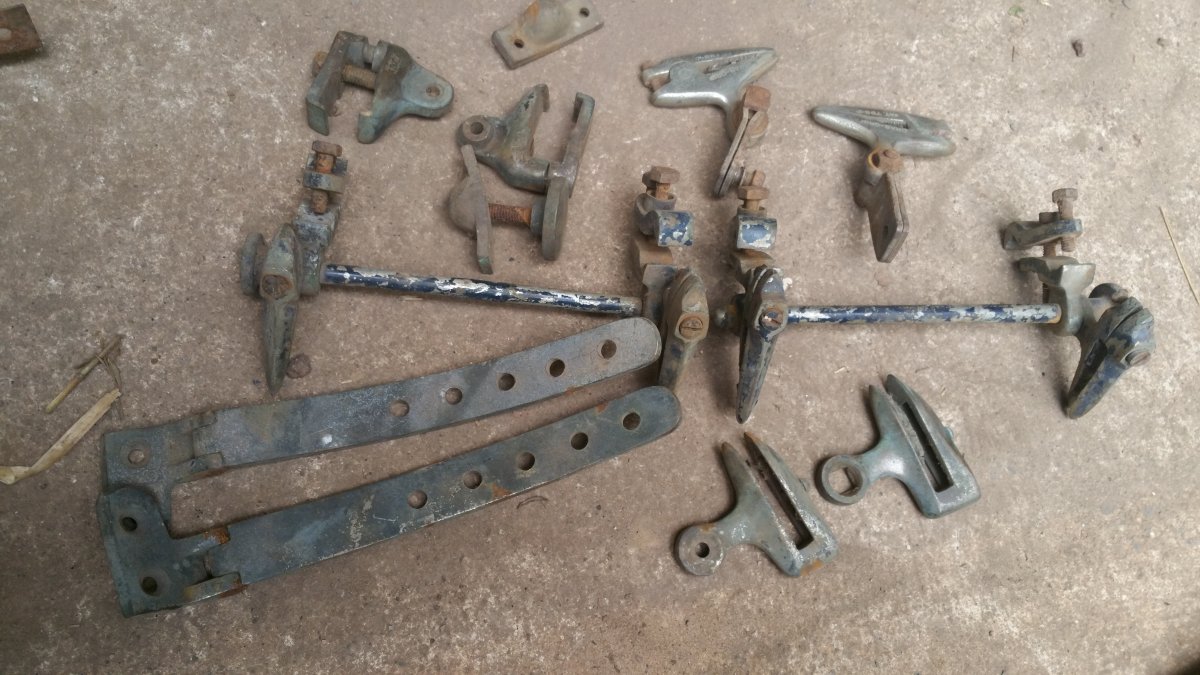

  21. Drylake
    Posts: 738
    Drylake
    Found a couple more parts to the puzzle recently. Original handles and aviation belts. Screenshot_2019-01-01-16-02-35.png 20190104_170554.jpg

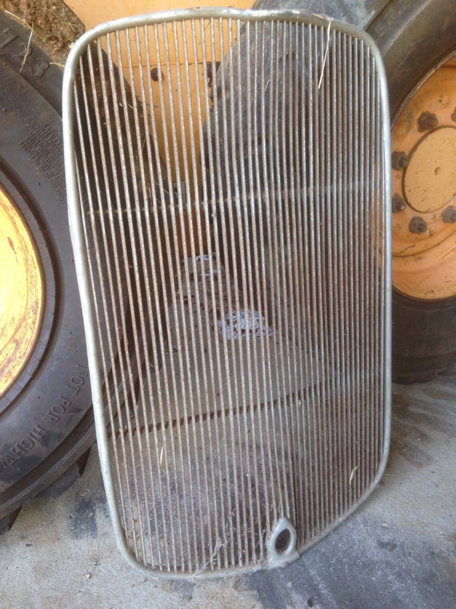

  25. Drylake
    Posts: 738
    Drylake
    20190107_133701.jpg Original grill arrived yesterday and the guy I bought it off put in an early ford V8 book for me as well! What a nice fella! 20190107_133905.jpg 20190107_133923.jpg
