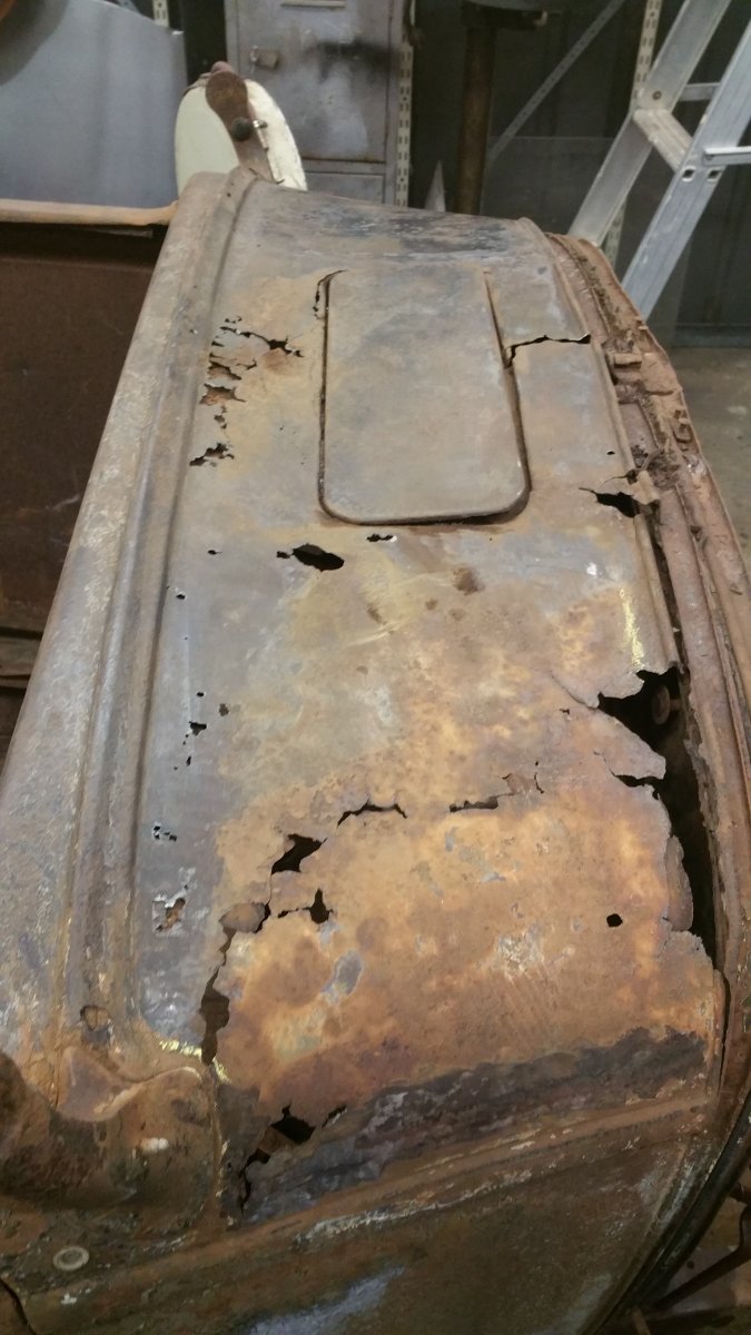

    It was by far the roughest part of the roadster. This photo is after I went over it with a pick hammer to find the thin spots, it was basically held together with paint on the top... must have held some water when it sat upside down for 40+ years on the farm! 20160804_181507.jpg

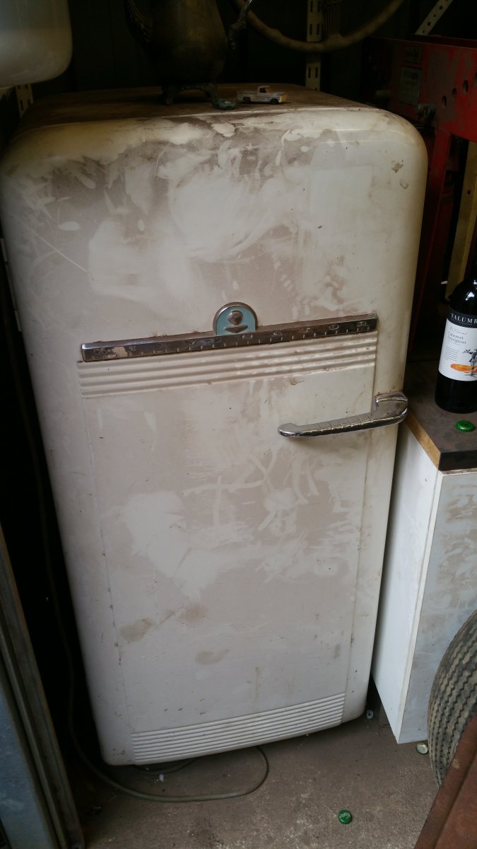

    Not a bad view from the beer fridge :) . Fridge is the first electric fridge my grandparents had, still going strong! 20190208_192215.jpg 20190328_181829.jpg

    I had a fridge like that... paid $25 for it, used it as my only fridge for over 25 years...
    couldn't get a relay it needed... gave it to a buddy to store bondo, spray bomb, solvent, in...

    That fridge is HAMB relevant... Kelvinator I believe had its DNA origins with the Crosley or Kaiser car companies. Regarding beers, I was told by a dad of one of ,y students who owned 8 pubs is that the reason they export Fosters is that no one in Oz will drink it. True?

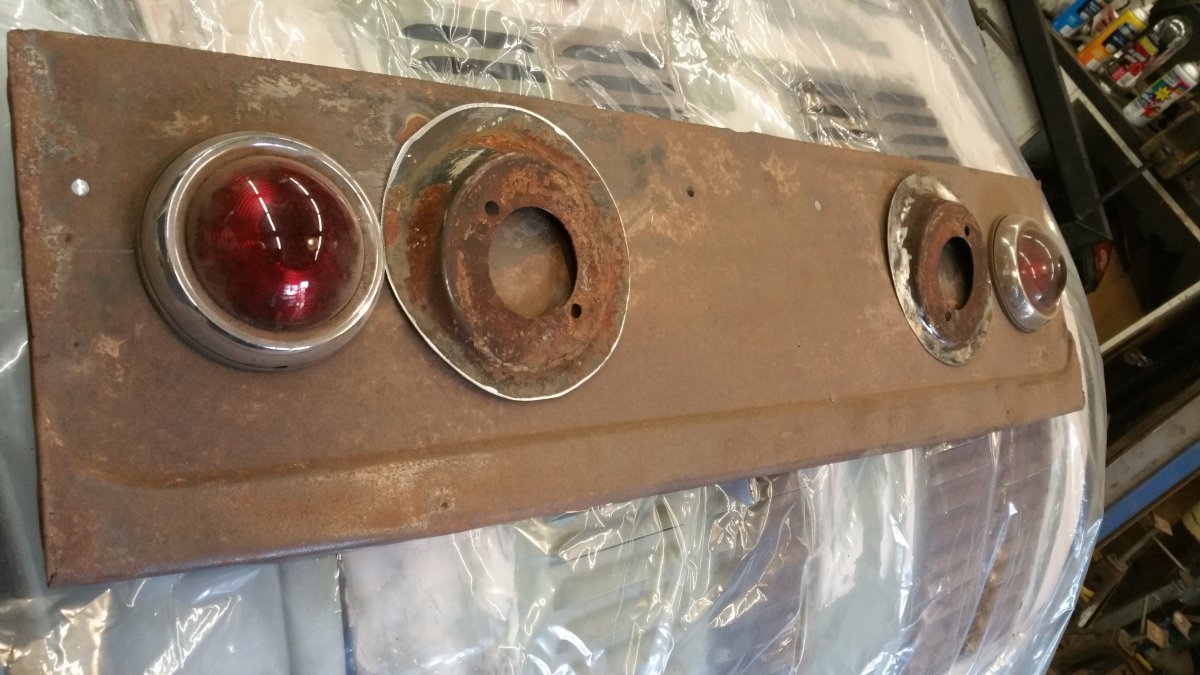

    On a tin hunt quite a while ago I dragged out a 1933 Graham rear panel... pretty sure it was 33. Anyway I sold the badge for ok money and saved the tail lights and sheet metal they mounted to. The mounting points are the same diameter as the pontiac lights I'll be using and will make a good recessed cavity to level the tail lights out, and make them look like they belong there. I plan to reverse the mounts from original. I've put them in a citric acid bath I'm running at the moment so they'll come out all clean ready to weld, in a few days 20190329_121726.jpg 20190329_121933.jpg !

    Why not do something different and use those cups to mount the Pontiac lights proud of the tail panel instead of recessing them? Just an idea...

    I did consider that idea. My thoughts are along the lines of subtlety. Making them sit proud could make too much of a feature. Less is more? I'll do some mocking up when they come out of the citric bath.
