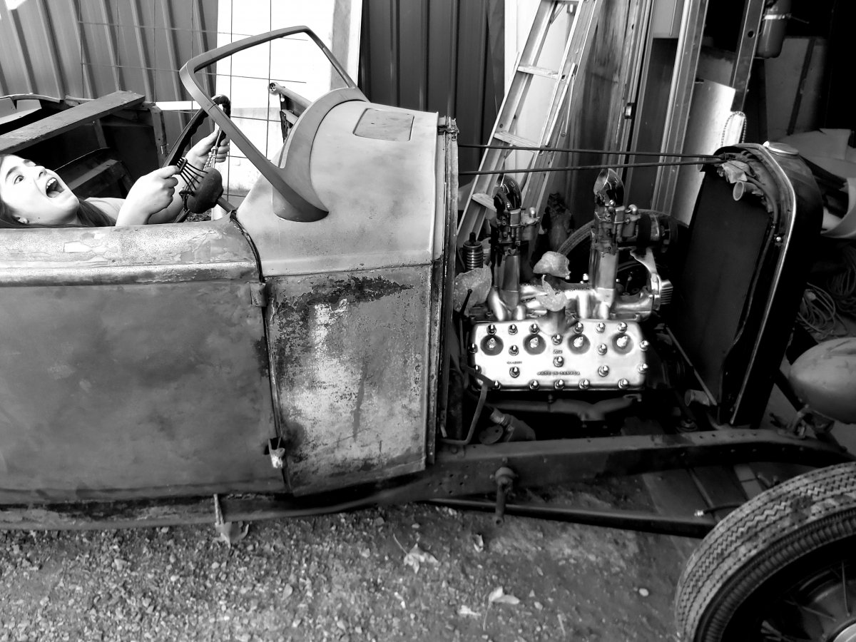

    This photo makes me smile, looks like she goosed the throttle and it is trying to get away from her!

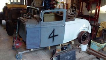

    I also dragged some **** together I have been collecting for fun. Just because it's enjoyable to mock it up. 32 Sport coupe with custom roof, or 5w I am not sure yet. Nearly enough parts in the pile, either way! I'm basically just waiting to get some parts out of storage to continue with the roadster.

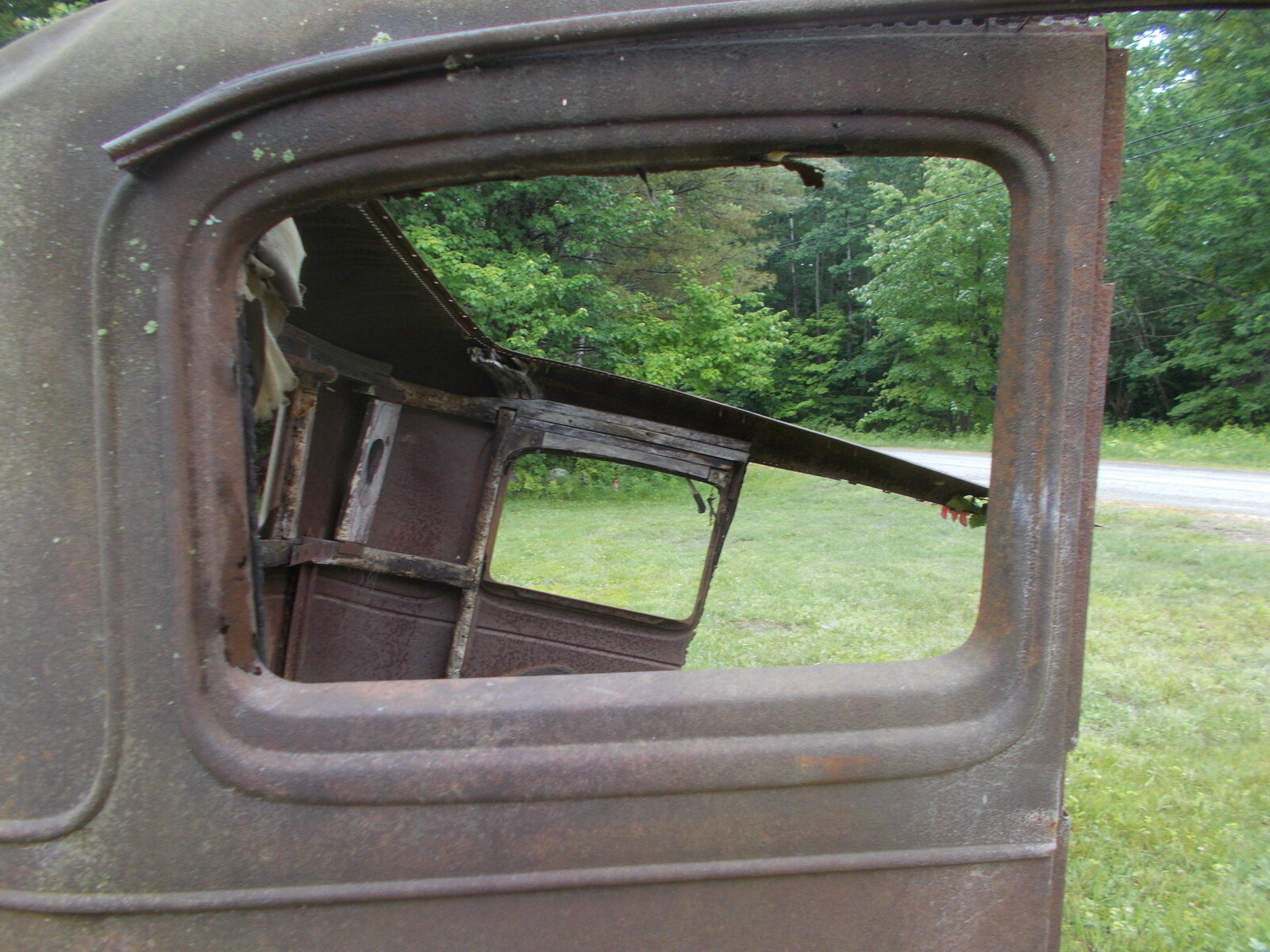

    DSCN7671 - Copy.JPG DSCN7676 - Copy.JPG i just traded around for a ? ...year / ? make ... four door rear clip, no doors, pix when its home...
    wish you lived closer as it would be cool in you PILE !

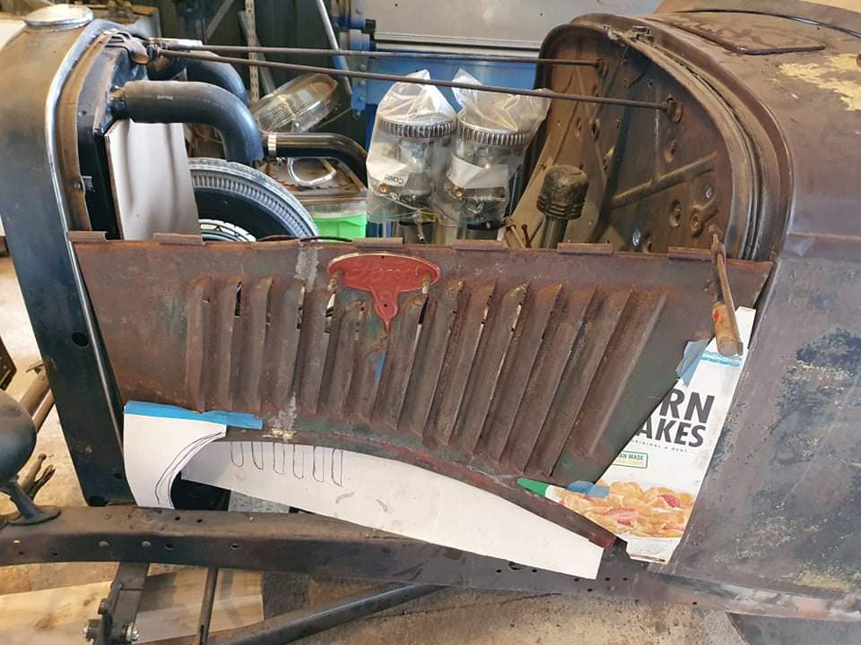

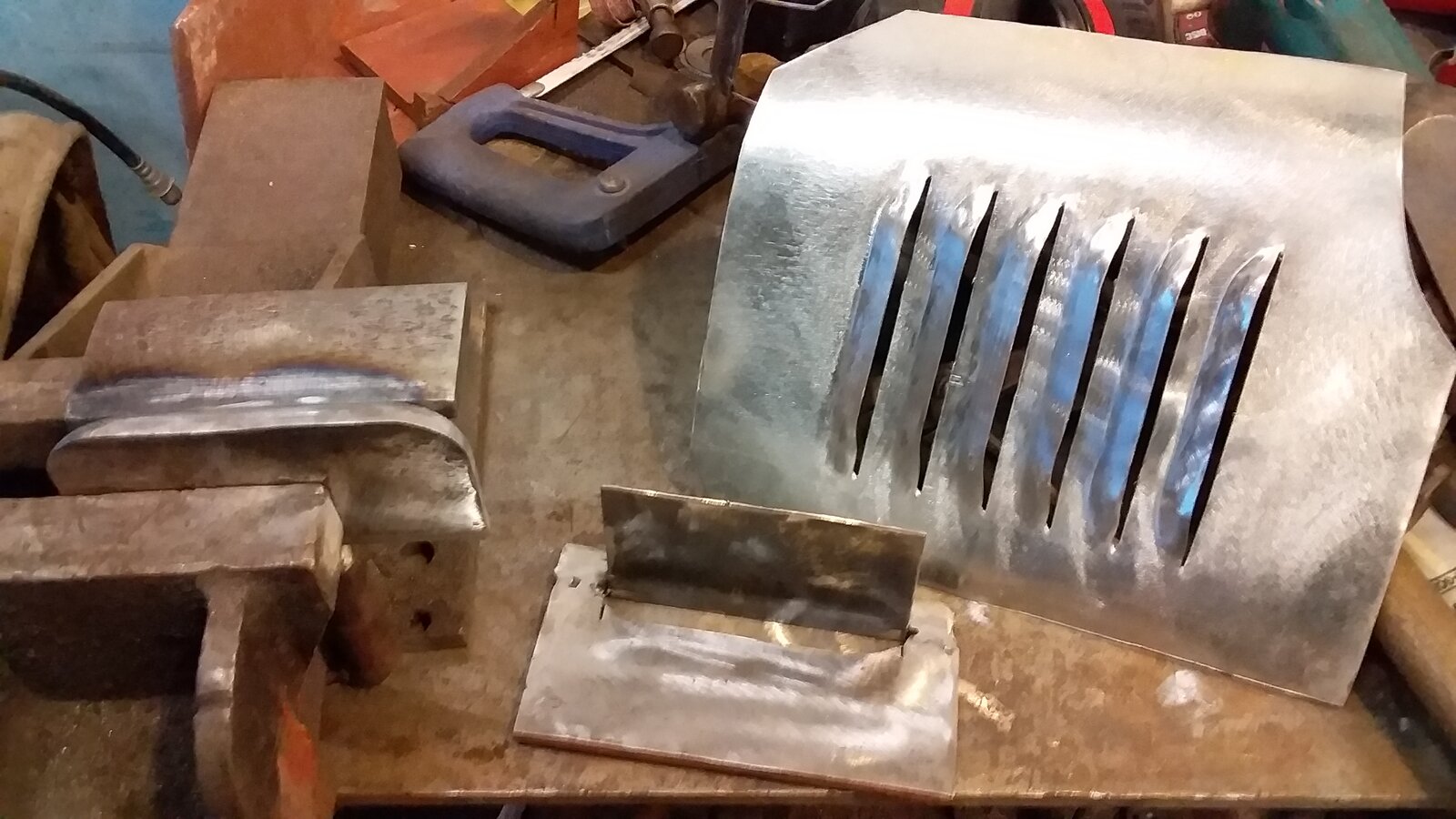

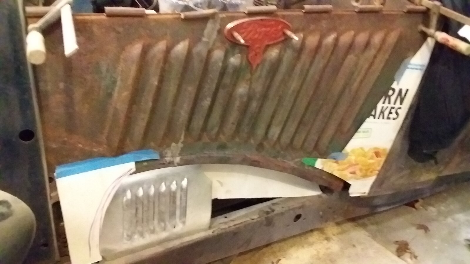

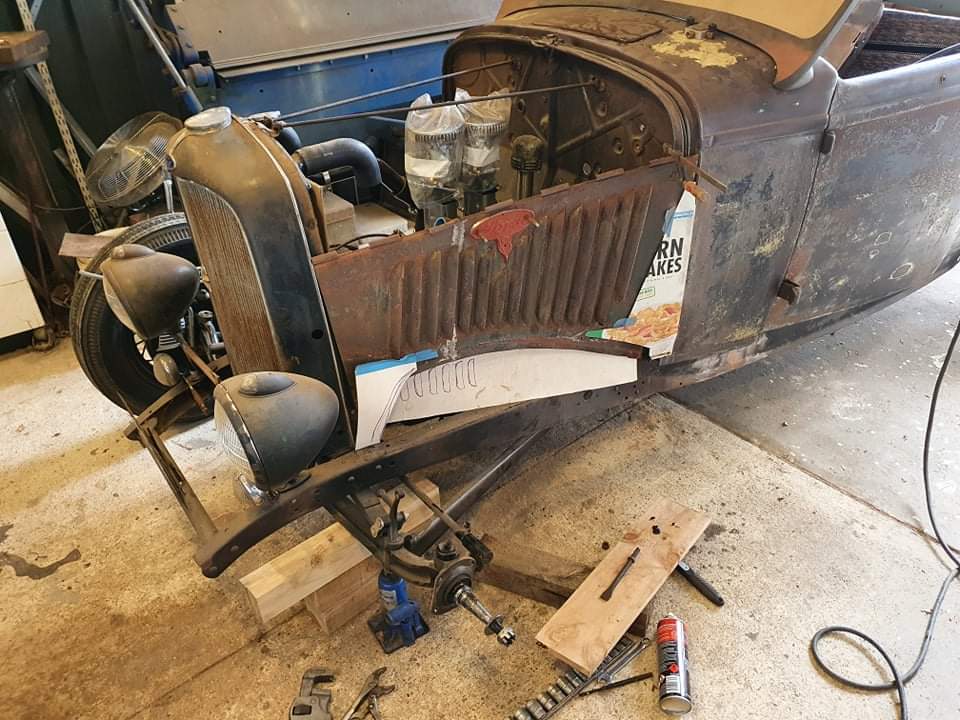

    This arvo I spent some time making a jig for forming dies on the hood sides. It is surprisingly easy. I plan to have a play with the idea of either br*** or paint finished inserts on the hood, at this stage it is just mock up and deciding the louvre style. The louvre I formed is based on the rear louvres on the deck lid. More refining needed on the jig used to form them, but it works quite well, and is simple. 20210622_170931.jpg 20210622_170934.jpg 20210622_170954.jpg 20210622_171007.jpg

    I believe you should try punching your mini louvers at the same angle as the Henry ones for a more cohesive look.
    Keep up the progress!

    my $0.02 ... try '35-'36 car or '35-'37 truck inner panels... the big trucks have shallower hood sides...

    I agree, thanks for the input. Angled louvres will work well.

    I'll have to see what I can get. The inner fender panels I planned to make will be domed for sure. These hood sides are Aussie big truck. If I can come across cheap inner fenders I will grab them. All the truck inner fenders I have come across have been a mess from the punishment a working truck receives. I am also changing the hood side radius to suit the 32 so I'm not sure how much of the stock inner fender would be of use. Thanks for the input.

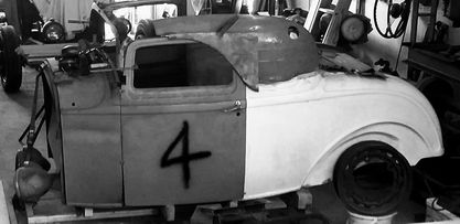

    lousy pic... '35 car inners...'35 truck sides...

    Very cool! I hadn't seen the hood sides used on a roadster before, I just liked them. Thanks for the photo, I think it would look good with original style inner fender wells. It's just a matter of finding some for a reasonable price and condition, or making some to fit. I'm enjoying the challenge and process.

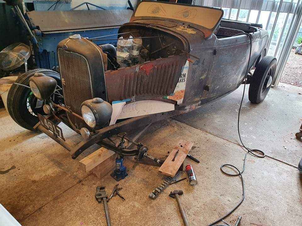

    Rainy day here, so ****ty paint blending day. I'll knock the sheen off once it dries to get the perfectly ****ty survivor finish over the patch panels on the roadster. It was fun!

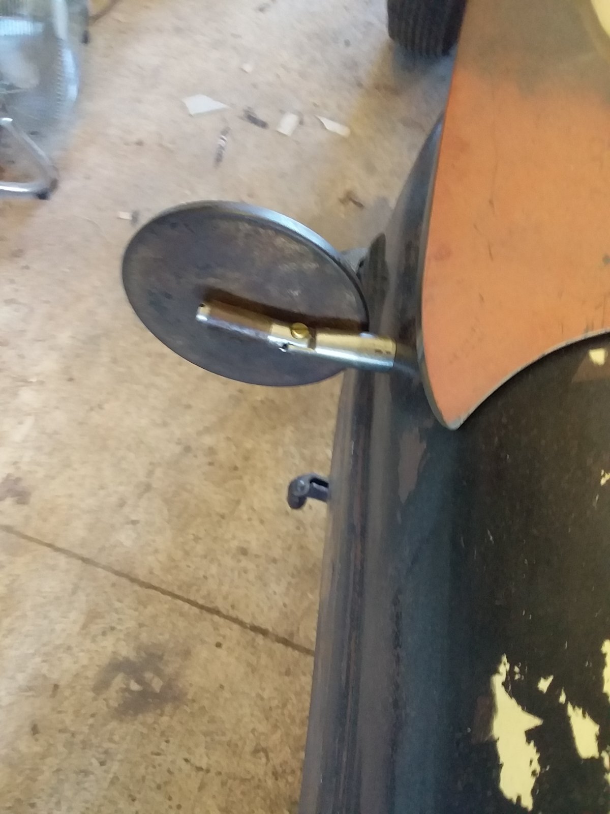

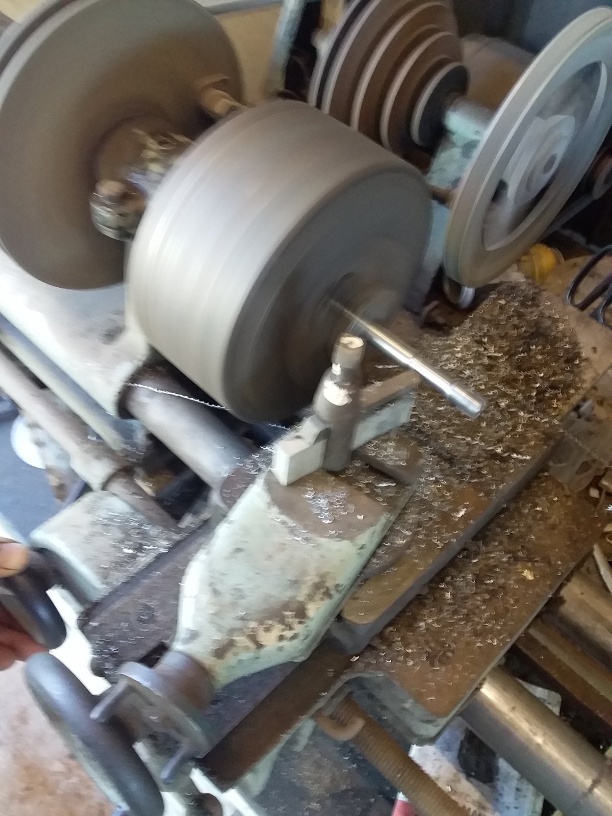

    Fired up the ****py old lathe and made an articulating mirror mount and mounted the centre mirror. Side mirror mount is mild steel and will be painted. I think the mirror itself might be Blitz? 20210819_134016.jpg 20210819_111705.jpg 20210819_123336.jpg

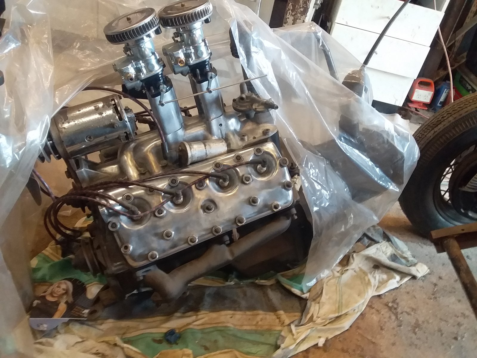

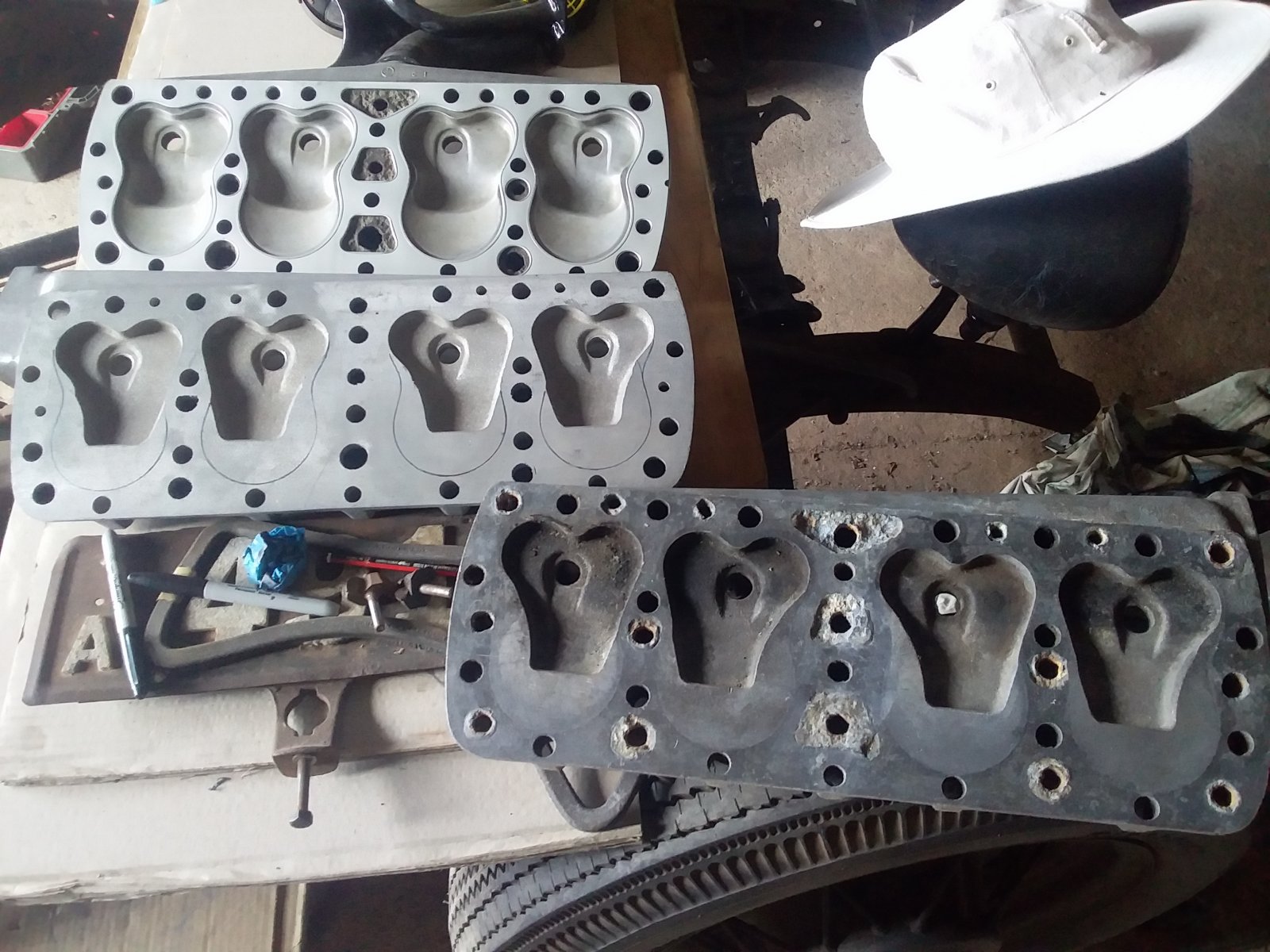

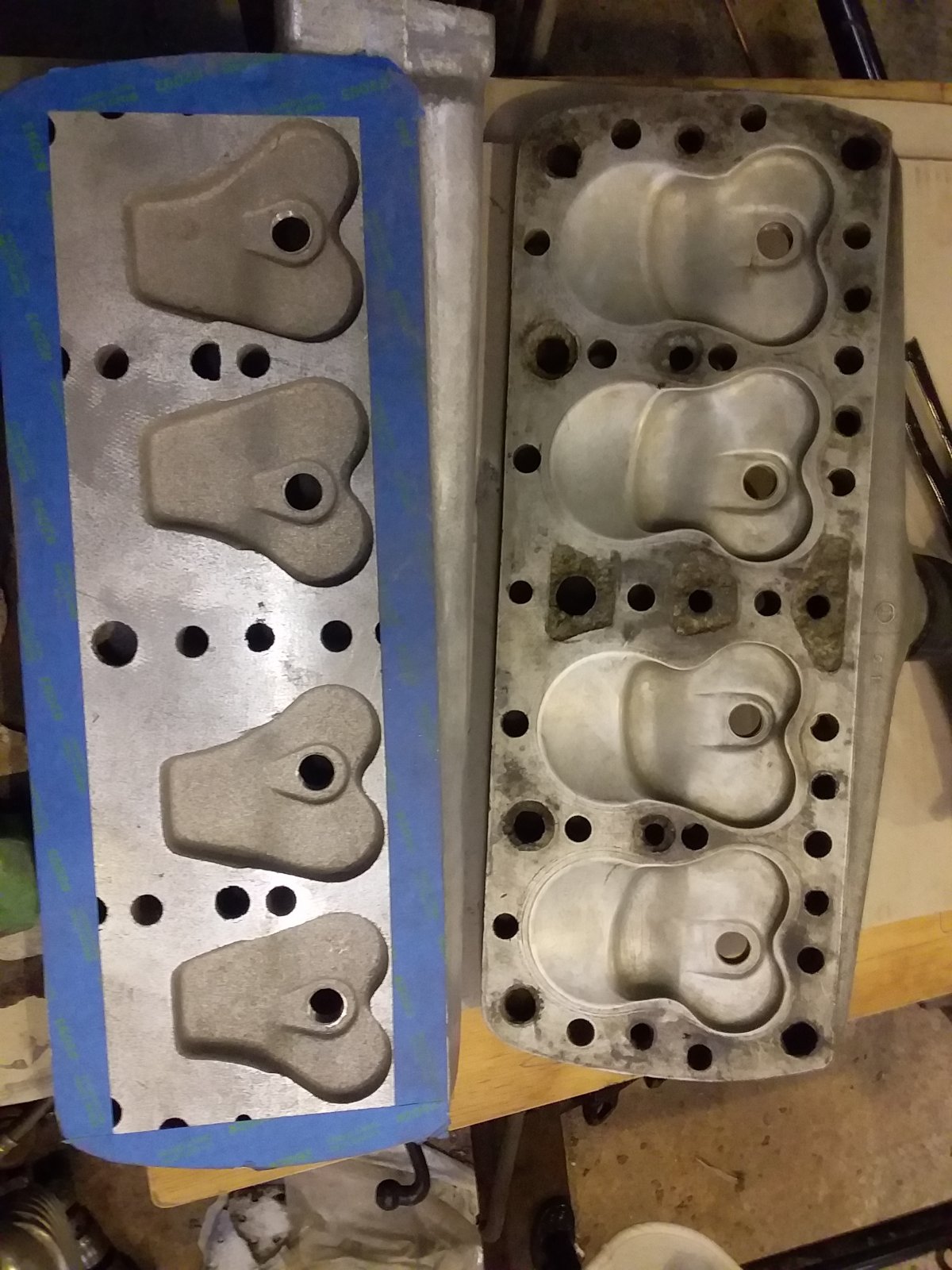

    I had great fun hitting a swap meet for the first time in a while. Covid meant it was small, but I met some really nice fellas and got some good deals on parts. Swage and jenny was my best deal with tipping dies. I also cleaned up and painted a few parts, built hand brake mount, played with the old paint a bit more, and toyed with the idea of pump in heads. I would need to fly cut the heads for the dome pistons and replace the studs, I am in two minds but love the look of the older heads and it will help with the fan belt clearance issue with motor mounts. 20210921_170122.jpg 20210913_110926.jpg 20210910_155203.jpg 20210905_160920.jpg 20210904_184453~2.jpg 20210922_140612.jpg 20210919_122148.jpg 20210919_084051.jpg

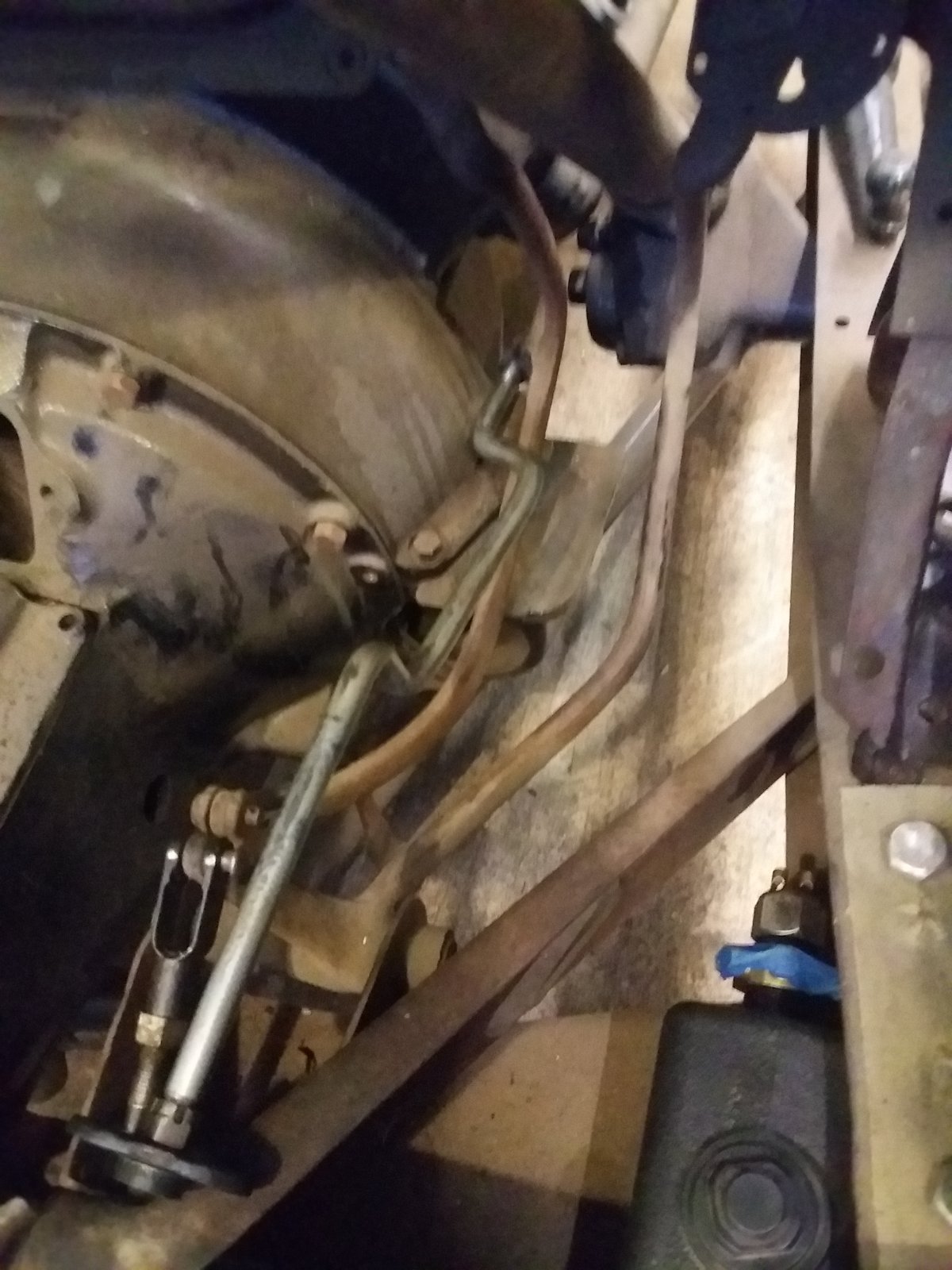

    20210901_180241.jpg 20210923_181121.jpg Pump in heads have been blasted and crack tested, surfaced and polished. See how I go with the piston clearancing. They were a good price, and will look good on a mock up engine worst case scenario. 20210926_212717.jpg I also shortened the drive shaft and had it machined and welded. Plus I made up a wobbly anti chatter rod to get around pedals.

    So those heads must have been offered that way for a builder to cut specific dome shape to match the the shortblock needs? Don’t think they were for flat top pistons. Time to find a proper machine shop to barter with, she’ll be alright. They’re ripper!
    Drylake and Thor1 like this.

    Ford used both dome and flat top pistons in that era and had different heads for each.

    I'm not sure if they've been over machined or what the deal is. They do appear to have a lot of meat left in them to be machined for specific pistons.

    What does and original 32 ford RHD antichatter rod look like? That's quite a twisted path it needs to take!

    Pump-in-heads certainly are pretty, polished up like that! Love that high-stacker intake!
    Agree with Carter... Likely compression chambers were designed that way. Seen those early blocks with flat top pistons before.
    I have a '37 flathead with the firing order cast right on top of the left head. (in 2 rows) If I had a good 21 stud block, I'd build it. Just for those heads. (they're cast iron, but very coool...)

    I don't really know what the rods look like stock around pedals... It's all a learning process for me.

    I dragged out a rough stock early 21 stud head, and it appears the pair I have are stock for flat top pistons. Thank you for the help fellas. 20210929_101317.jpg
