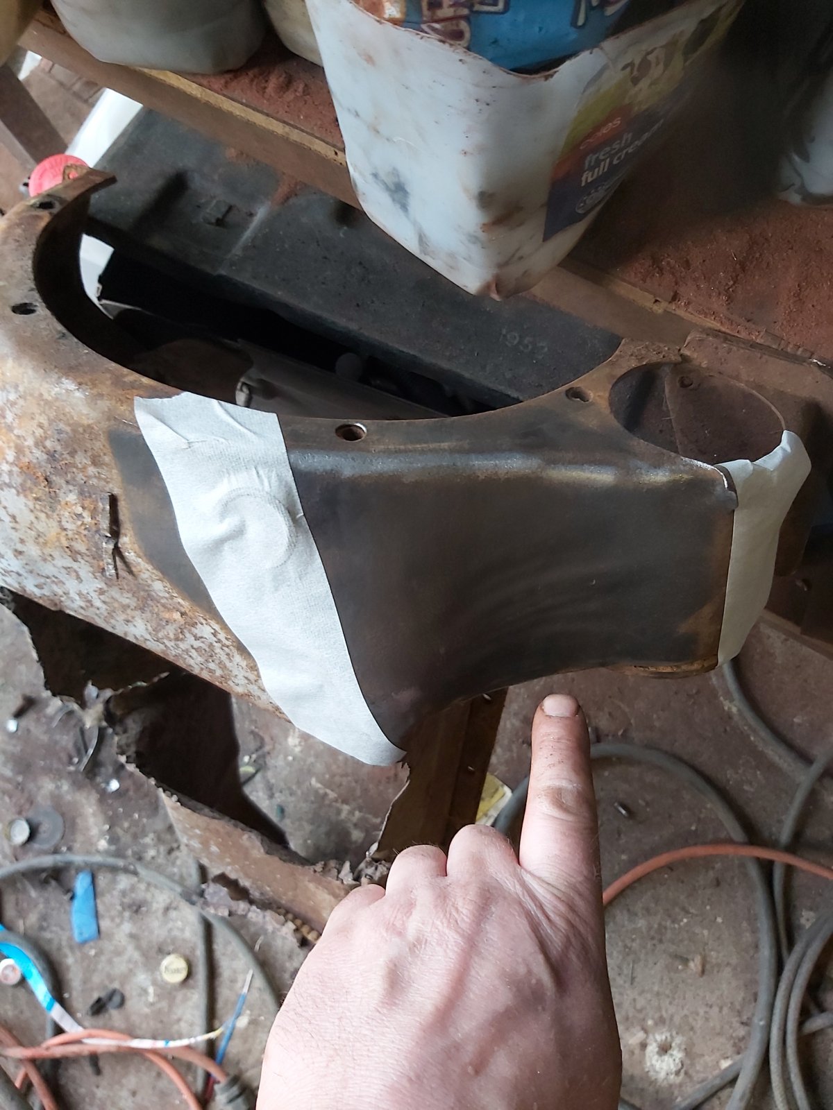

    I spent some time tonight modifying the sump, and clutch cover for the roadster, to clear the wishbone. I like the idea of not splitting the bones. This is a truck sump which also has the large inspection plate on the bottom of the sump. This is just one of those jobs I've been putting off. 20220916_135510.jpg 20220916_152807.jpg 20220916_171315.jpg 20220916_191017.jpg

    Good choice on the truck pan... Bonneville Bud Jones ran one on his '27 T roadster, but actually split the bones because of the lower bell cover interference with 'said bones'...
    I liked the large sump plate, I could get my whole hand in there if necessary.

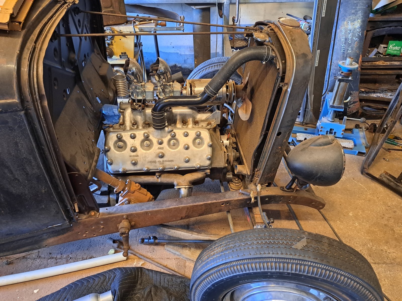

    It's been a while since I posted any progress. I have the 32 heavy axle under the roadster, 46-48 wishbone, made some progress scrounging parts for hood latches and installed a 32 steering box. It's nice to bolt some parts on. 20230422_145639.jpg

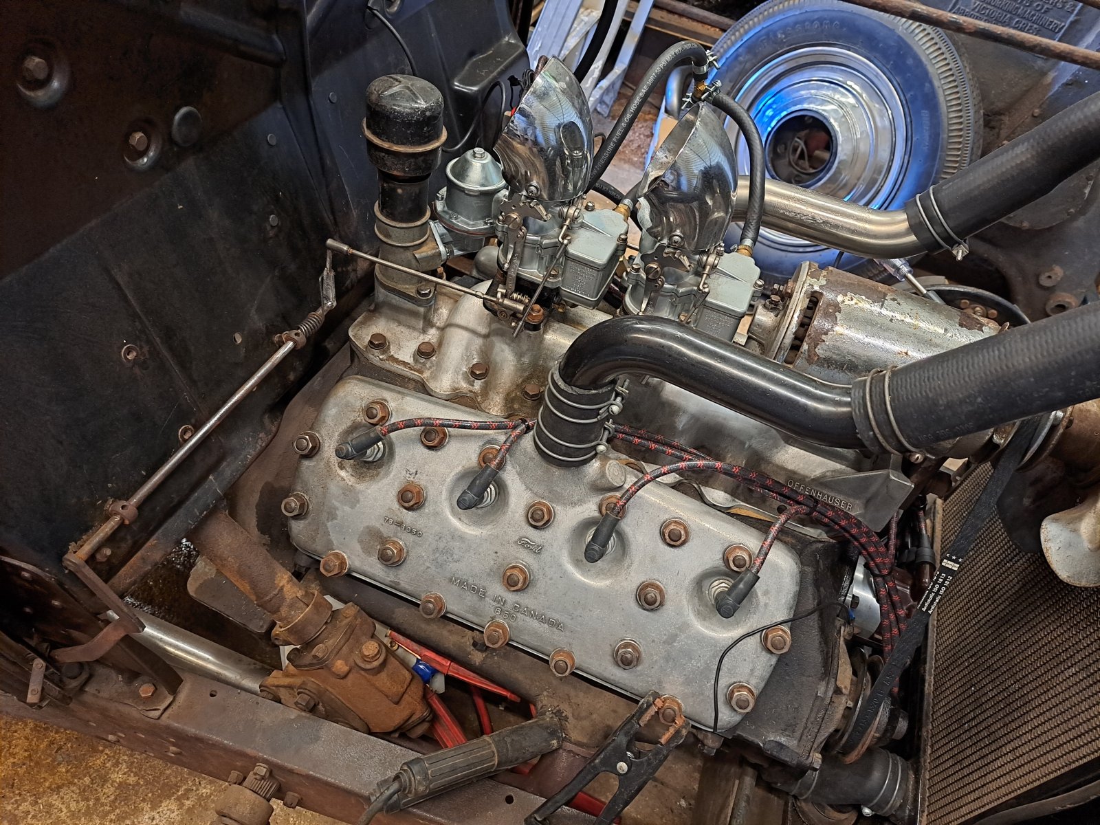

    Yesterday I dragged out some parts for another engine I'm building up, and today I got to mock up the little "Wade" supercharger. I was lucking enough to get today in the shed, and got some welding done on the roadster. I'd been putting it off until the weather cooled down, and "total fire ban season" was finished. 20230501_104954.jpg 20230501_104818.jpg Screenshot_20230501_175008_Gallery.jpg

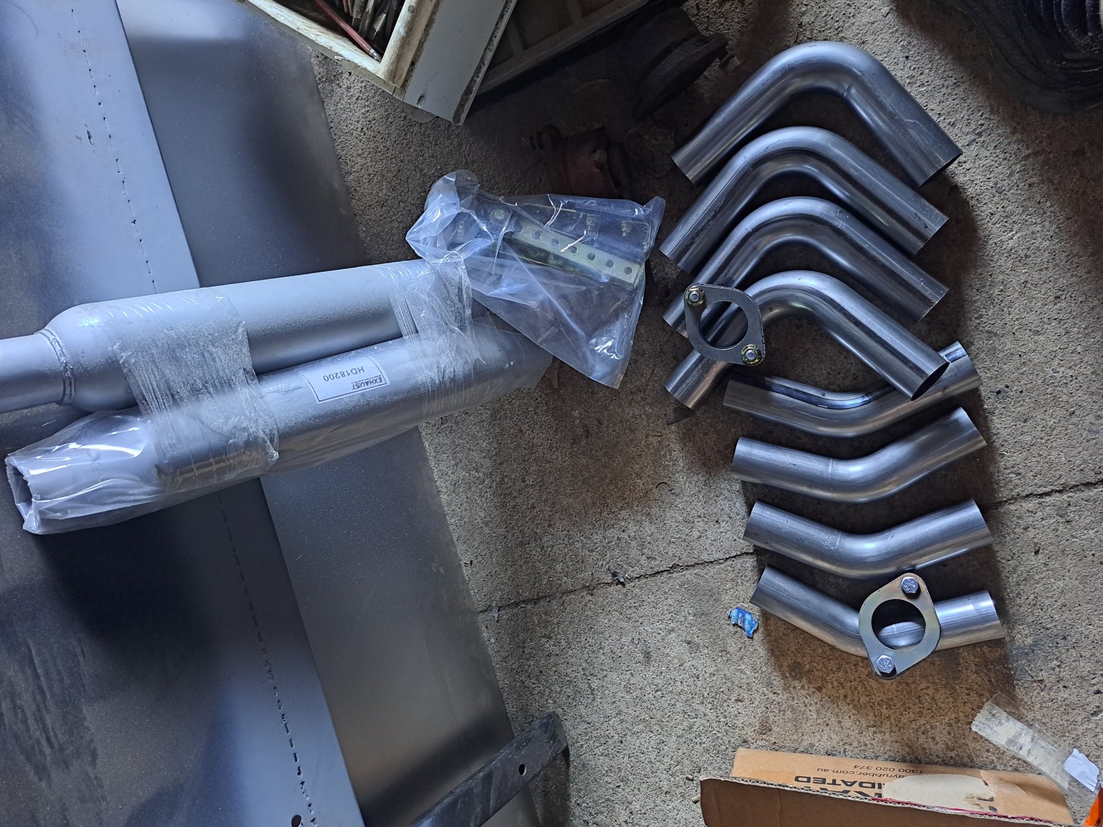

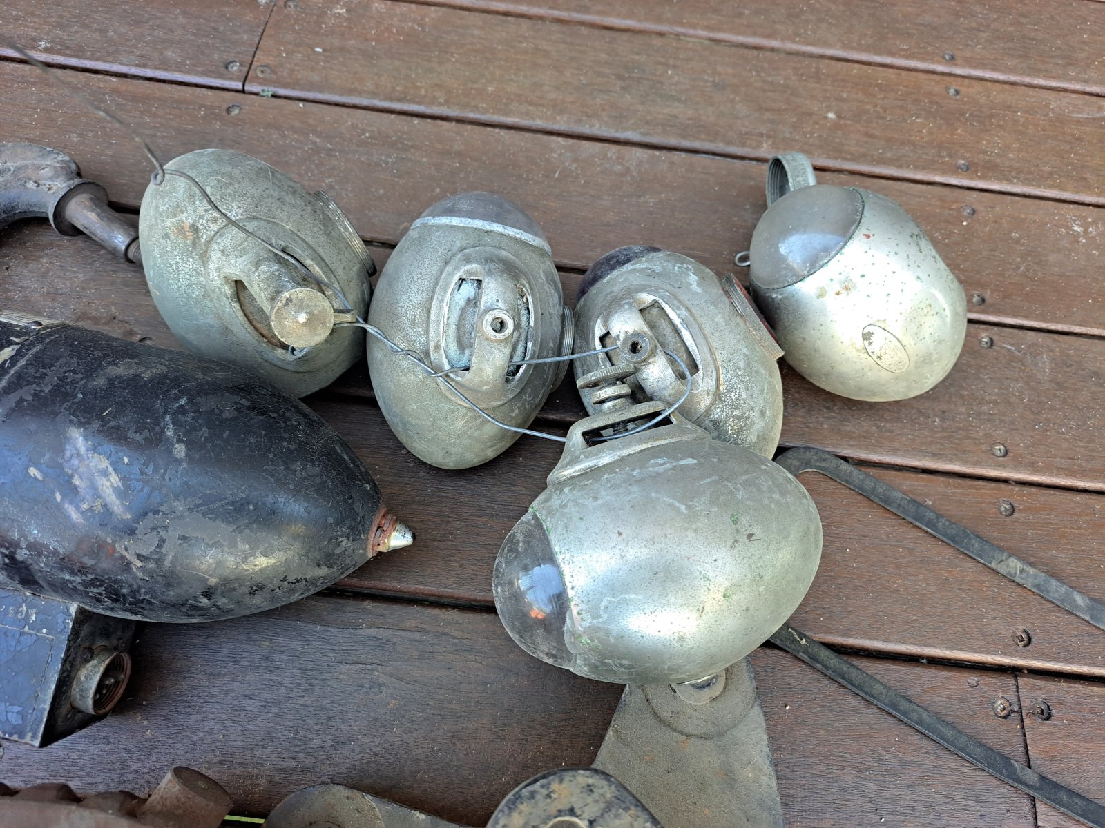

  13. Drylake
    Joined: Jul 17, 2016
    Posts: 738
    Drylake
    Well it's been a little while since I've posted any progress.
    I have recently sold a few things to afford some parts to help my progress.
    I am currently working on the plumbing (exhaust, brakes and radiator hoses) and also the wiring. The exhaust consists of dual 2" tubing with 18" hotdogs.

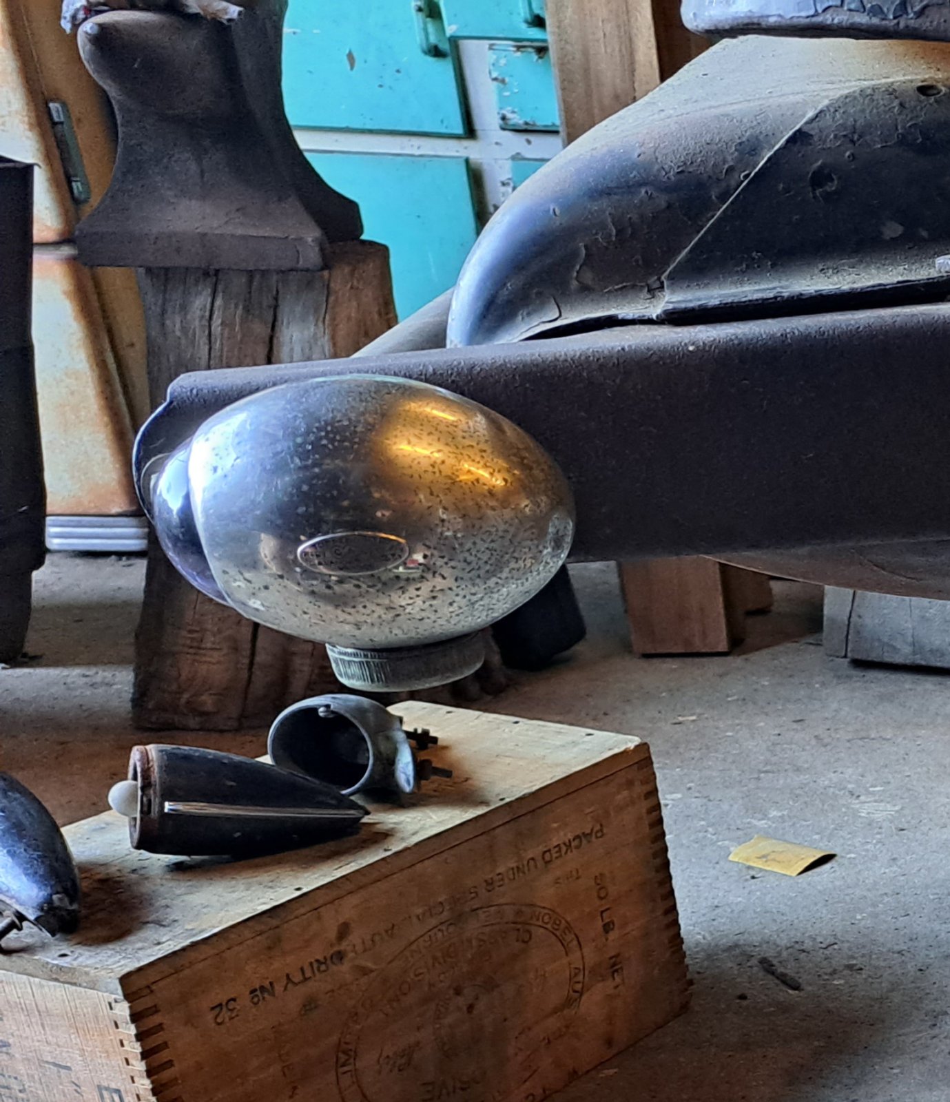

    I also bought a few vintage parts I think are interesting, and rare. The cowl lights remind me of e&j type 20 headlights and would make cool indicators on something With those headlights. Surprisingly they're from a 1913 Vauxhall. I think the bullet style generator is very interesting as well, it is 12V. The hunting for parts is a lot of fun!
    Here are some photos. 20230713_153142.jpg 20230715_094312.jpg 20230715_151206.jpg 20230715_094630.jpg 20230715_155543.jpg 20230717_135700.jpg 20230717_162401.jpg 20230717_130750.jpg

  16. Atwater Mike
    Joined: May 31, 2002
    Posts: 11,618
    Atwater Mike
    Yeah, the generator is a One-Off, for certain. Great looking, and as for the design of those older generators, easy to rebuild.
    If you can only find larger brushes, they can be ground down to size with a fine stone grinder.

  19. Outback
    Joined: Mar 4, 2005
    Posts: 3,450
    Outback
    from NE Vic, Oz
    Great work, we have a 1911 Vauxhall in the work shop at the moment, 2 in fact. ;)
    Those lights are made by CAV

    The generator is a "Rotax" brand out of London. Google came up with aeroplane engines, but nothing that looked similar.

    Rotax made electrical components for early vehicles, lights, instruments etc

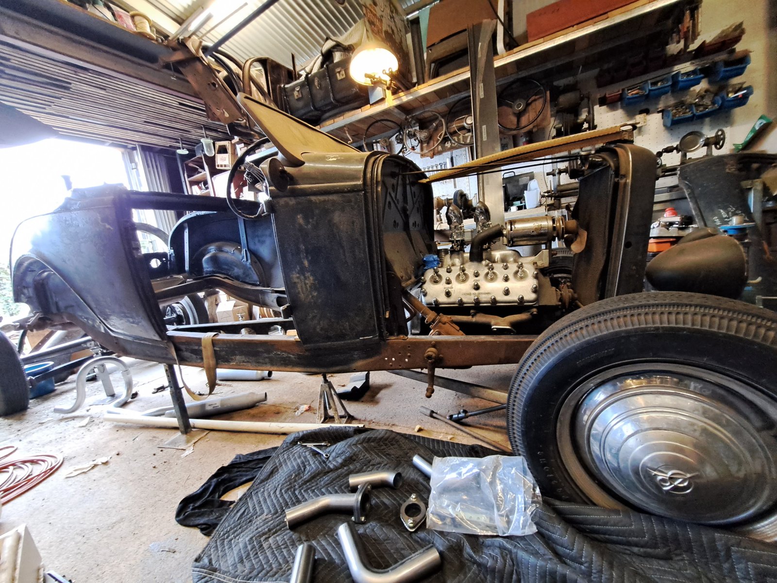

    20231202_184658.jpg 20231202_173237.jpg 20231202_173219.jpg 20231202_131940.jpg 20231201_202202.jpg It's been a while, here are some progress photos. I have it running well. Today I modified some throttle linkage parts for the accelerator, and have been working on the brakes. I have a few parts ordered and on the way so I can make some progress during the Christmas period. The exhaust is almost done, I'm getting closer to having a driver!

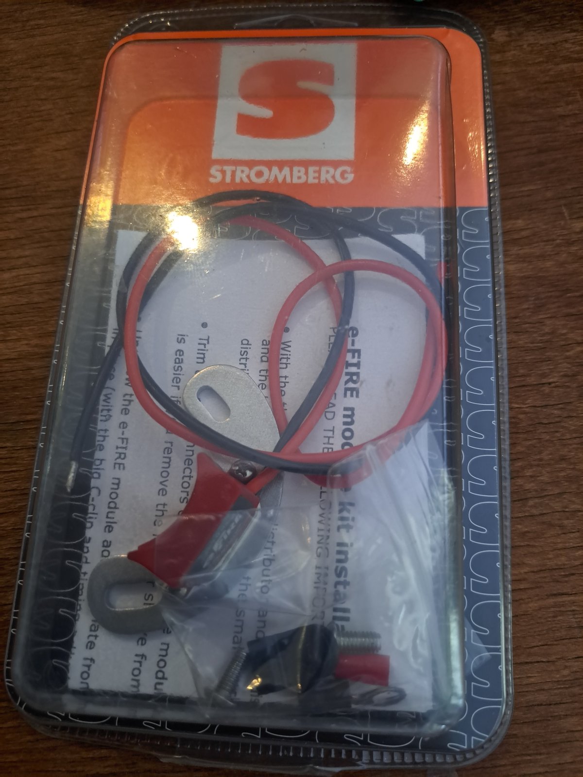

    I have had some troubles with the stromberg e-fire distributor. Having spent quite a bit of time with the multimeter testing multiple things, I discovered I had a bad ignition module, which had sat for a couple of years. I then purchased another module, and still had no spark. The problem ended up being a bad earth due to the anodised body of the e-fire distributor, running an earth directly to the base of the ignition module fixed the issue. 20231121_135510.jpg 20231110_155717.jpg
