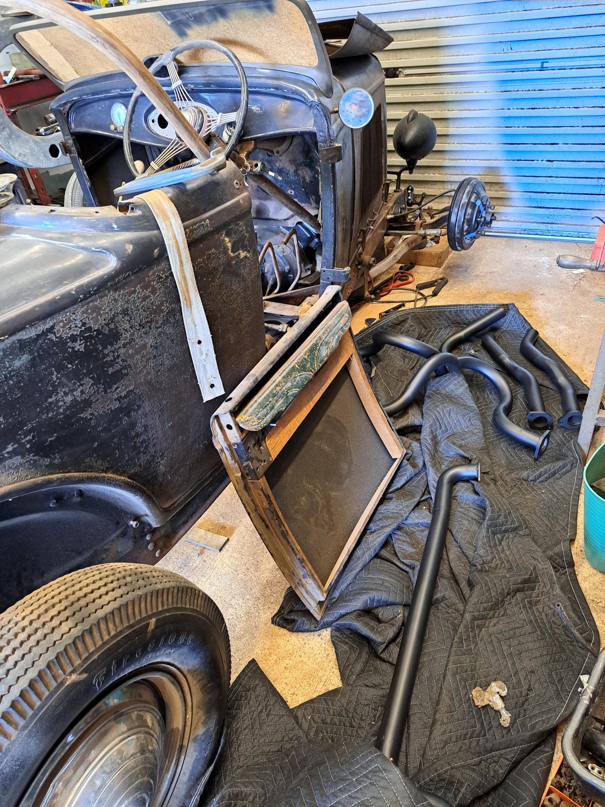

    The dual exhaust is all welded up and ceramic coated. I'm waiting on some brake parts to arrive, and I'll get it stopping soon. 20231217_101059.jpg

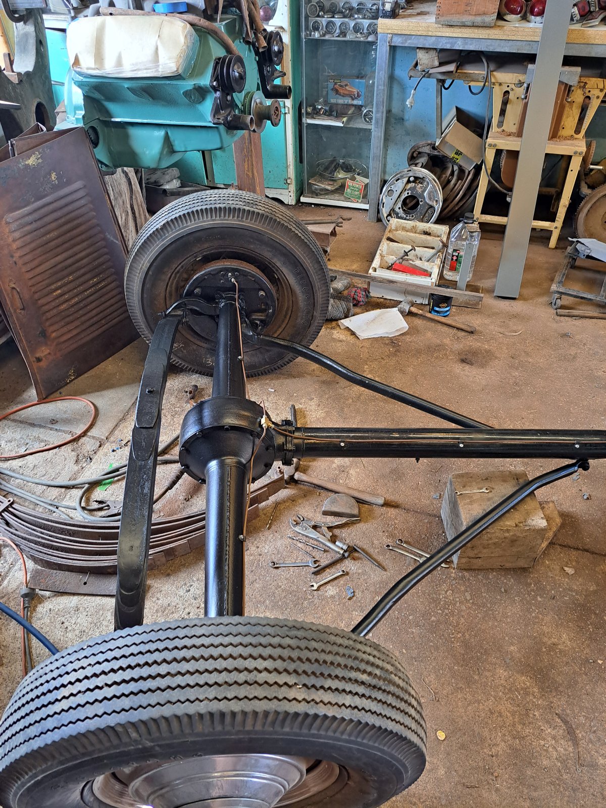

    20240126_131405.jpg 20240126_131338.jpg 20240121_101319.jpg 20231230_181301.jpg 20231201_202202.jpg Today I spent some time painting the rear end, flushing the new brake lines and installing the shortened drive shaft, and a replacement fuel tank I bought at a recent swap meet. The speedo drive functions, so I did OK measuring the drive shaft length... The fuel tank appears clean inside and holds fuel. The brake shoes and handbrake levers are installed. Once the rear end is completely installed, I'll bleed the brakes. I'm getting close to a test drive... Lots of small things on my "to do list". Floors will go back in once the brakes are sorted and once I've re-connected the clutch linkage.

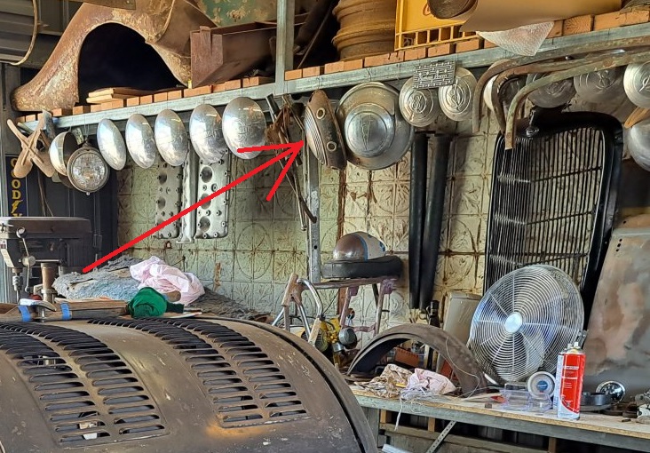

  8. There has to be a story to that wide-five Mercury hubcap with the custom holes.

    That cap was given to me locally, with another one that had been chromed. The holes in the one you pointed out has vintage kitchen cabinet breather caps all around. It has the gentle man's full name, "return to Robert Smith" and a two digit area code for the switch board phone connection on the back side of it. It's not in the best condition, but is interesting.

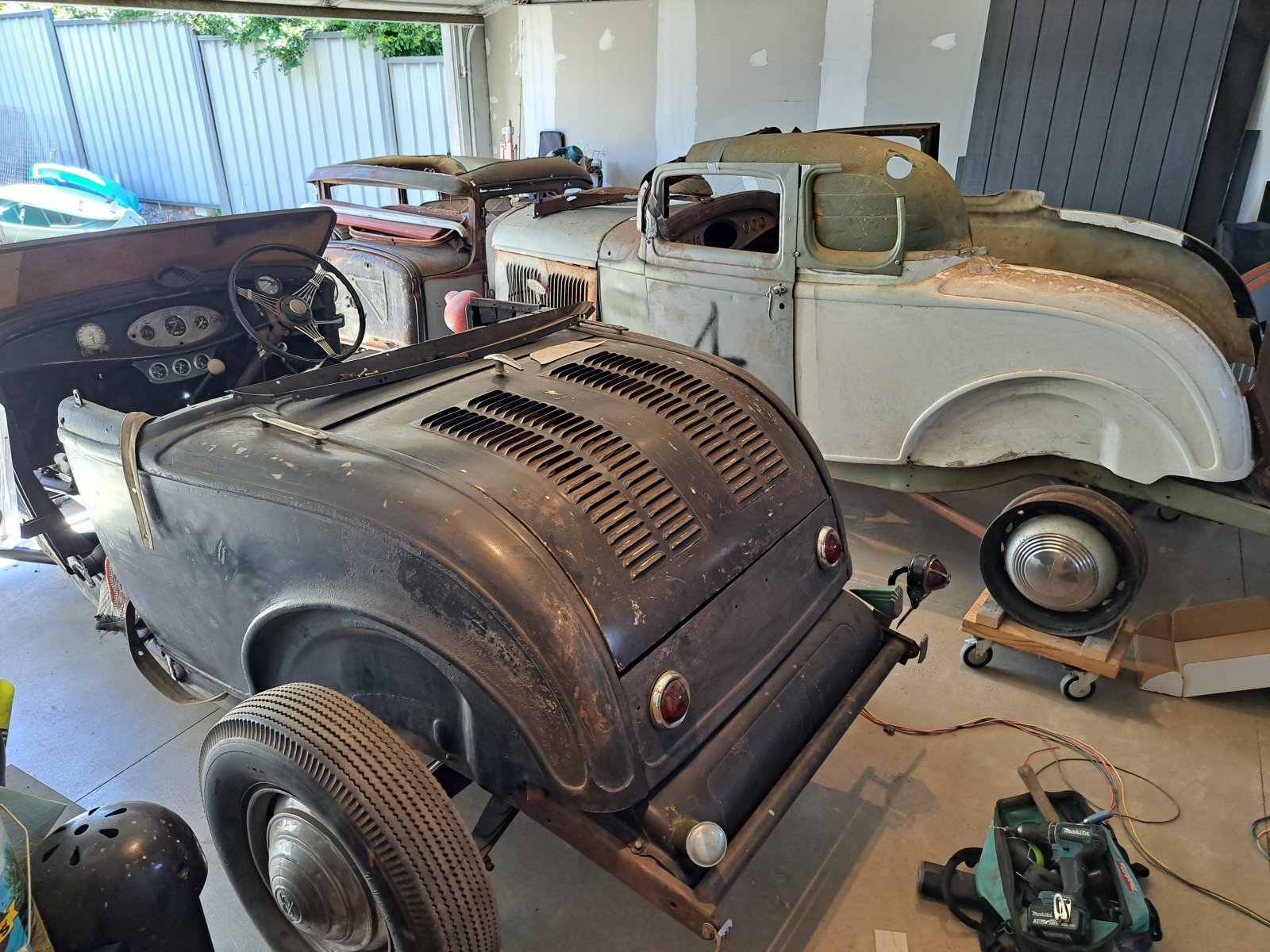

    Last Thursday night I rolled the roadster into the garage for the first time to finish it off in comfort. Wiring has been started, and I have a decent size list. Choosing tail lights has been a challenge as I have a few I like. 20240301_194131.jpg 20240301_150144.jpg 20240301_150023.jpg IMG_20240302_204907.jpg
