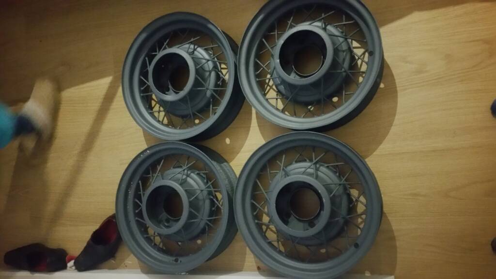

    1475139858817.jpg got my 35 wires back from abrasive blasting. One came up pretty bad. More progress!

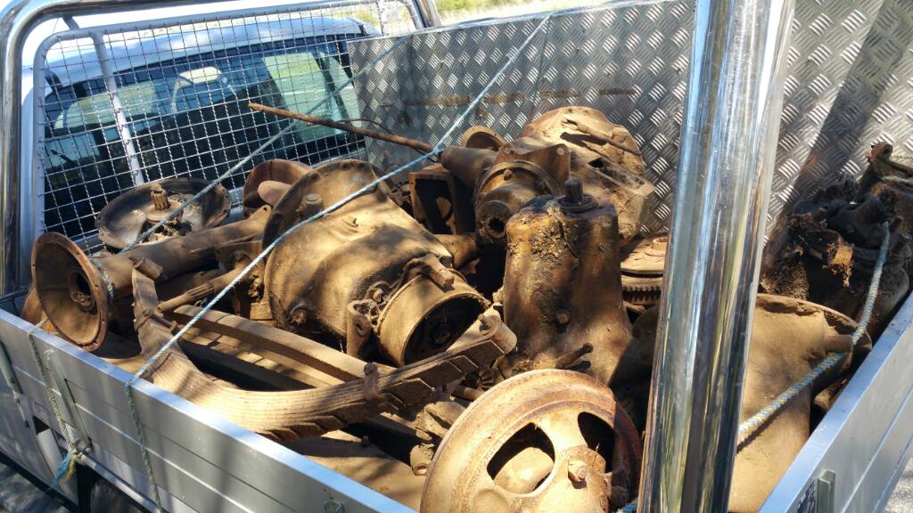

    Finally got the chance to pick up the flatheads and front ends etc from glen Innes nsw. Drove from Adelaide, what a long drive! Around 38hrs in total! Got some of the parts i need though, fast forward my project with a big hit of parts! I'll post photos of my finds as i sort through buckets of parts and piles of gear boxes.

    1476783407268.jpg 1476783418904.jpg I also am in negotiations with a 1950's aluminium caravan to tow along to long distance swap meets!

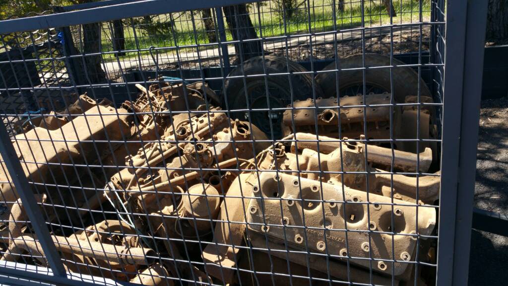

    are those Canadian heads aluminum?

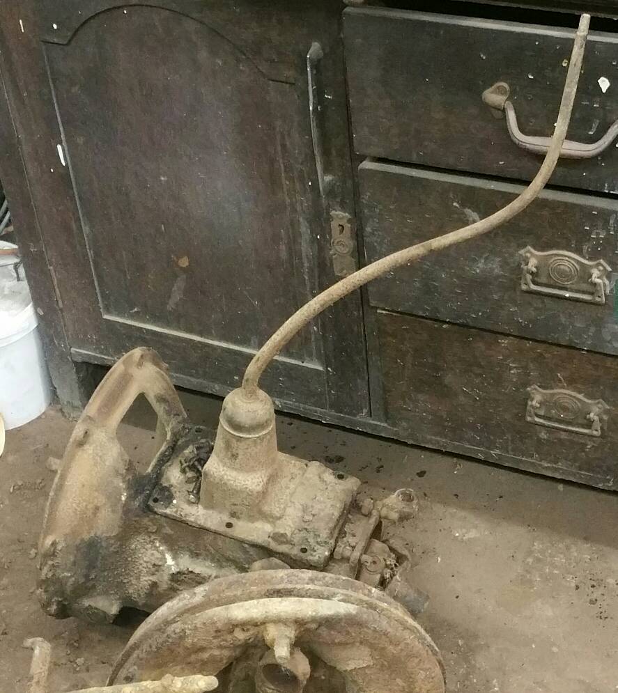

    Yeah, there are two with canadian alloy heads. 4 out of the 5 engines will clean up well and have clean bores. I have alot of sorting and cleaning to do! 10 gear boxes in total in various condition. 1476868377978.jpg

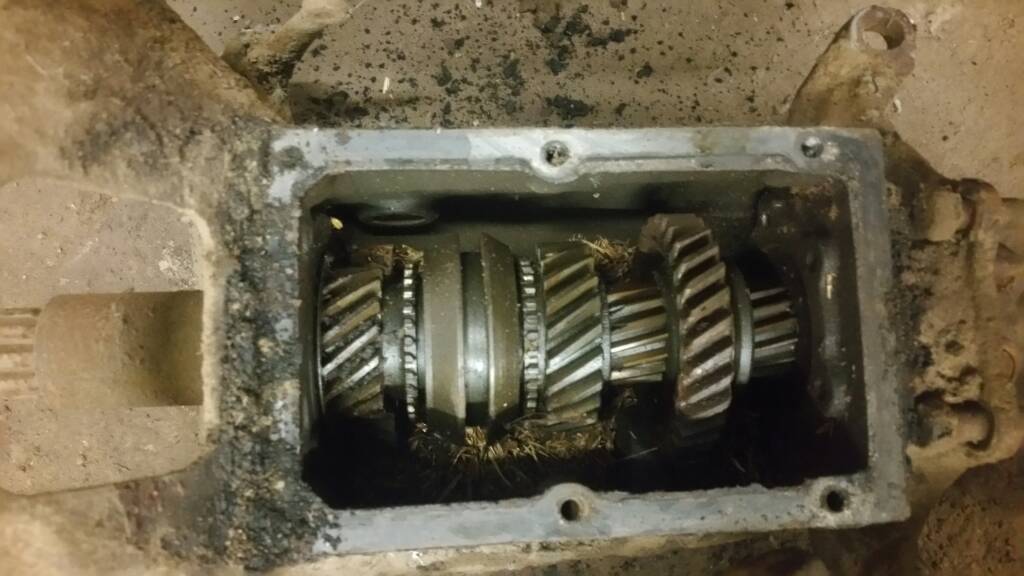

    1476961742121.jpg 1476961750198.jpg 1476961756488.jpg 1476961761288.jpg 1476965224529.jpg 1476965224529.jpg I've been going through the top loaders tonight checking on vanpelt to identify them. I believe i have an early 39 pickup trans and a couple of earlier 37-38's which would make sense given the flatheads that came with the lot. The canadian 21 stud heads are pretty clean. I'm not sure if they originally came with flat top pistons in 37? But I'll check to see if it is standard bore tomorrow.

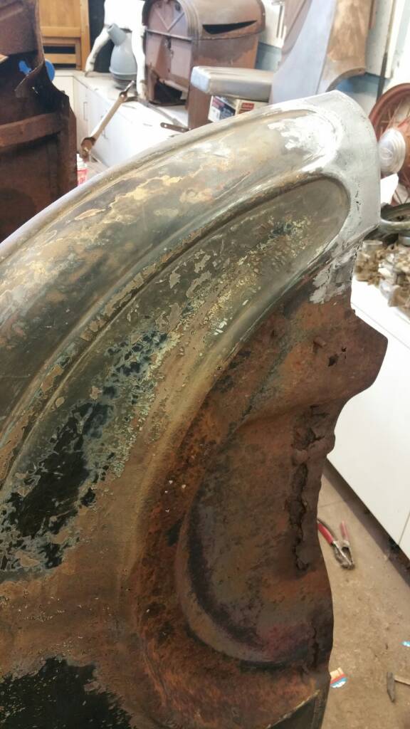

  15. Drylake
    Joined: Jul 17, 2016
    Posts: 737
    Drylake

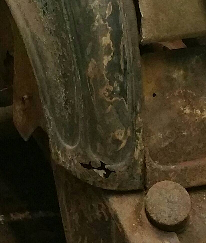

    1477377687859.jpg i keep a s**** bin in the shed for 1930's patch panels. Sometimes it saves me making patches from scratch. This time i cut part of the patch out of a 33-34 dodge sedan quarter window. Using the corner radius for the inner radius of the roadster quarter. Worked all right and saved me alot of time.

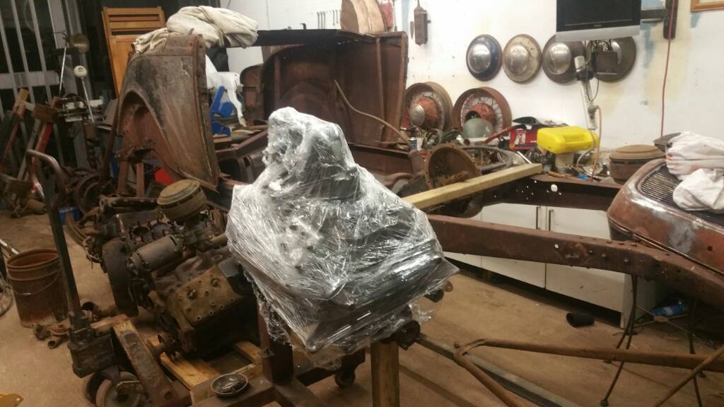

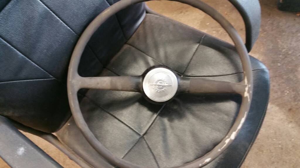

    1477993363982.jpg shed is full at the moment. I put the ch***is on the rotisserie on the weekend to make it easy welding up some holes that won't be necessary using the copper block backing method. I still have to chase up front and rear end components to get it mocked up and rolling. I'm hoping the bendigo swap meet will be a winner for me! Steering box is going to be 40 ford along with the steering wheel, which will have a modified 56 horn ****on.[​IMG]

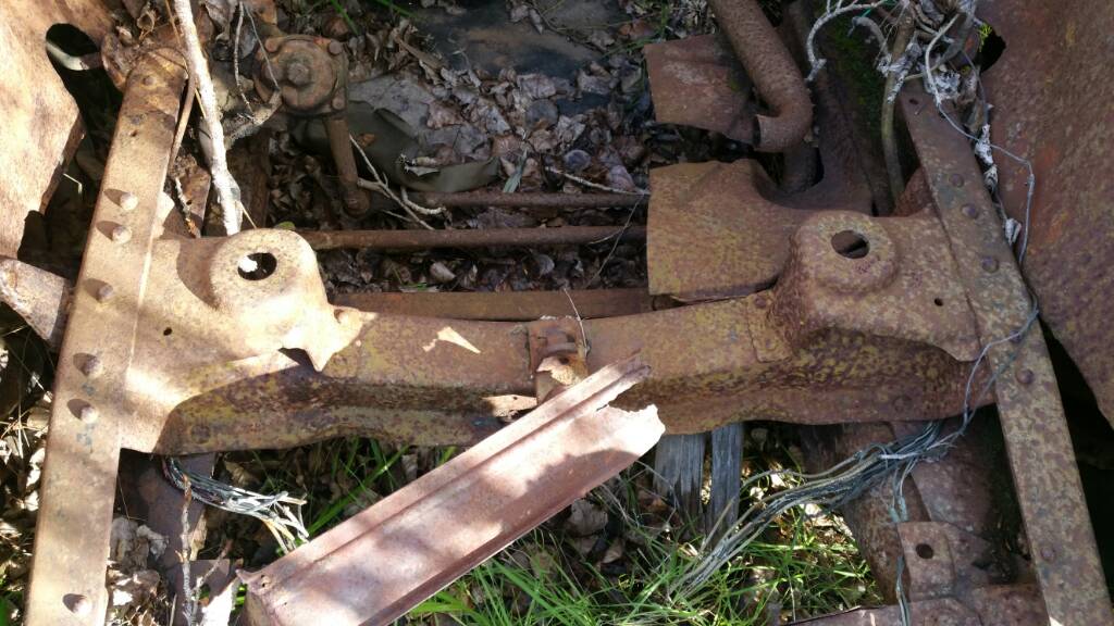

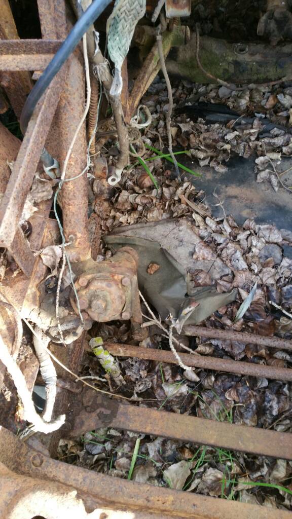

    [​IMG] just need to remove the box. I have been thinking of modifying the cross member for motor mounts, and maybe using the column out of this toasty old truck. I have spotted a good idea on here using the original motor mounts on the cross member for the 21 stud fabbing mounts to reach forward. Looked neat.

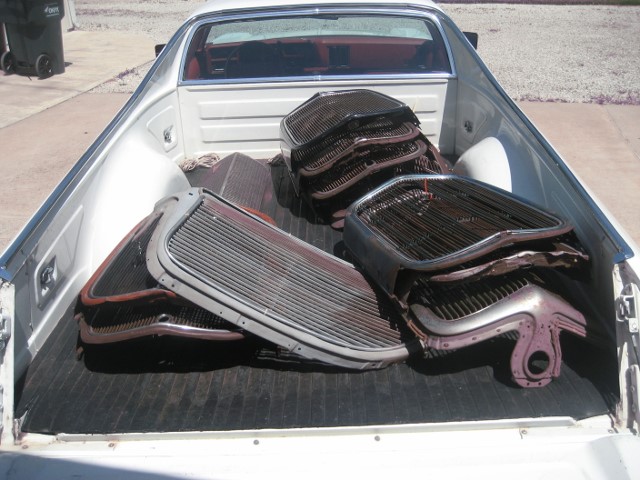

  28. D.Conrad
    Joined: Jan 8, 2010
    Posts: 528
    D.Conrad
    Helped clean out a widow's garage recently. GRILLS 001 (640x480).jpg Ronny\'s grills & Manifolds 001 (640x480).jpg
