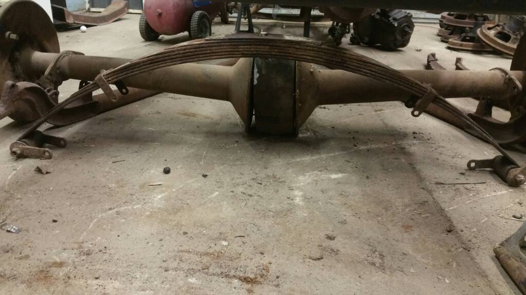

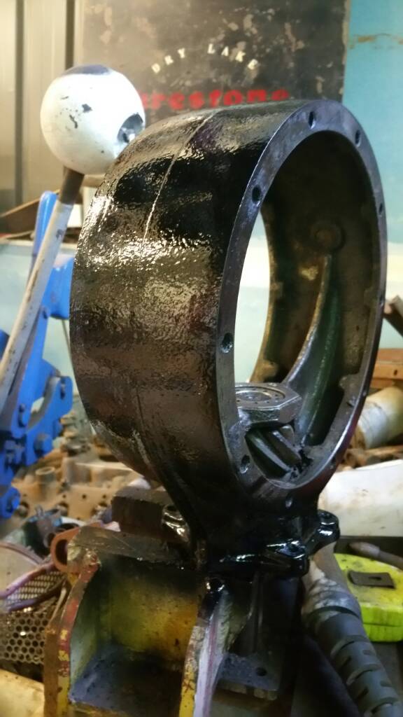

    My plan is to try to clean up one part of the running gear every night. By the end of the week, spray a batch. Might drag out longer but I'm just trying to make small goals to get to completion sooner. [​IMG]

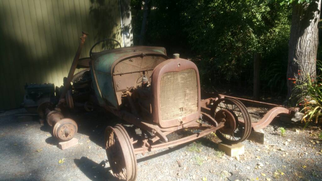

    Another stash has made it's way into my hands....[​IMG]I'll be moving alot of it on and using what i need!

    Well, some of this model A gear has been the hardest to let go in terms of wanting to keep it! But, it will help the 32 progress! I've made my money back and am $1,000 up since picking it up friday!

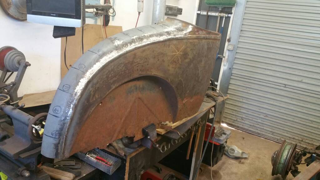

    I paired the quarters up and marked every 100mm down the back of them. Then made templates for the 100mm increments using the more complete quarter panel as the guide for the cardboard templates. The patches were then hammer and dollied by hand, tacked in postion, then finish welded and cleaned up. It was time consuming and enjoyable! 20150204_182206.jpg This was my first time creating a patch of any sort.

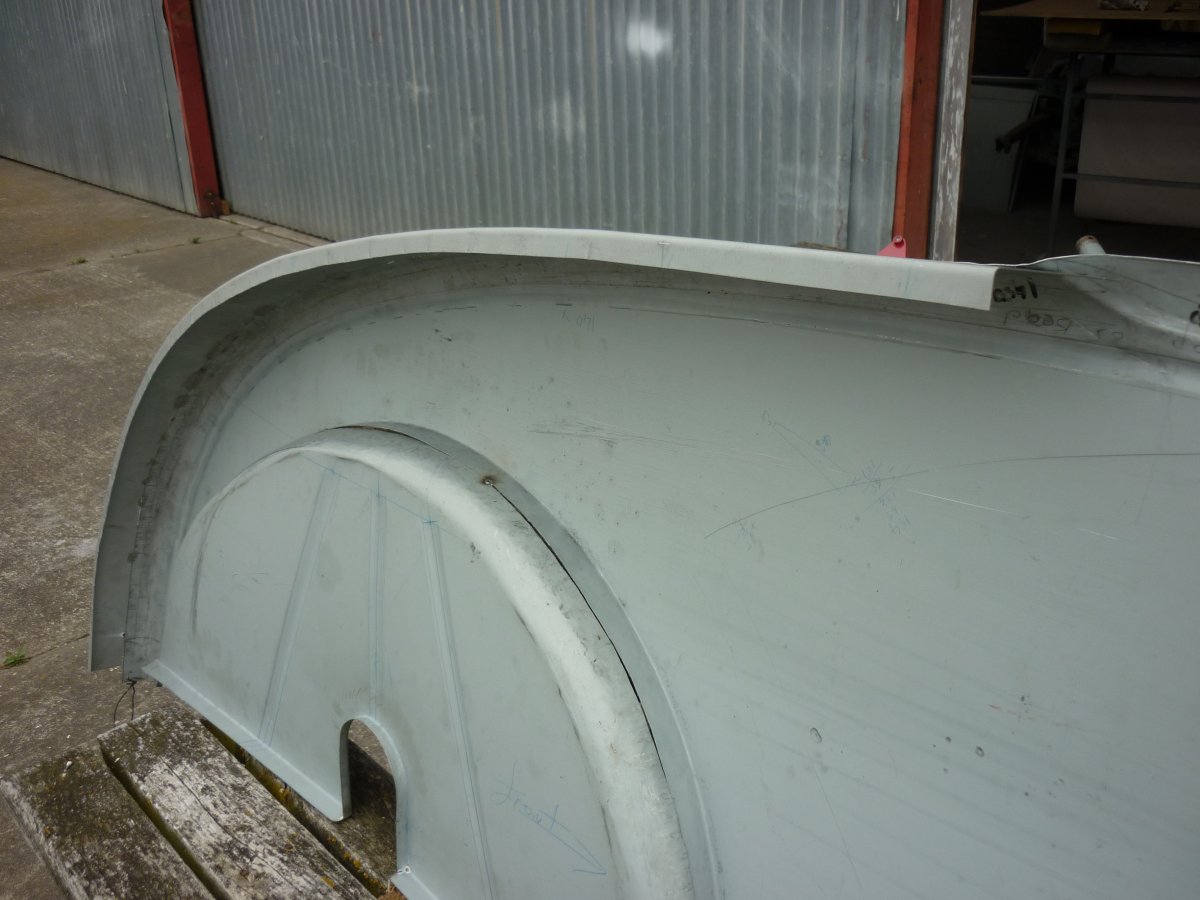

    Found a ****py photo of the top section welded on but not dressed out, this started as a flat section which I folded a lip on (The lip is on the edge that meets the trunk channel)then shrunk the lip to fit the curve of the quarter then a slight shrink along the mating edge (to the quarter) smoothed out on the wheel then weld the bits together then dress out with hammer and dolly (which I did after this shot) hope this helps....oh yeah going to make the top front section separate and stick it on. no flash .JPG

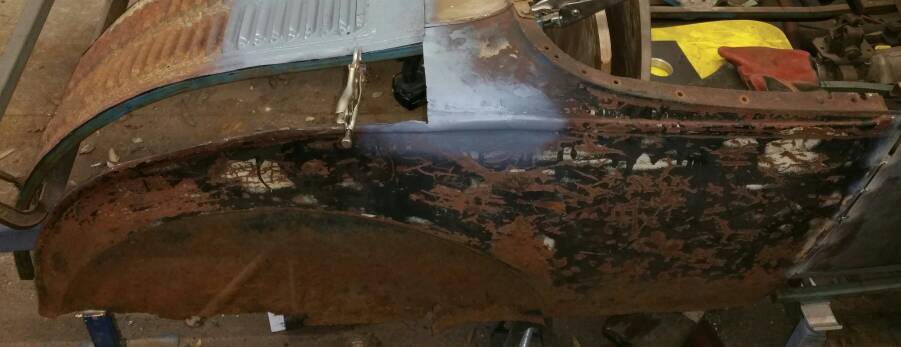

    My coupe quarters have been done for quite a while now. I found working with the cuts around the edge of the existing swage to be the most challenging part.

    inside view.JPG this should give a better idea how I shrunk the lip to get the curve to match the outer part of the quarter, this will fit in to the trunk channel.

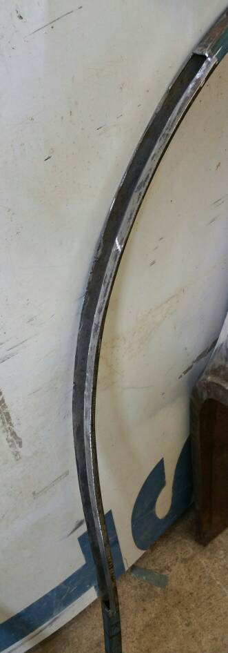

    At the stage i repaired the quarters i had a very limited selection of tools. I ended up using a pipe bender and marking every 50mm along a piece of 19mm square tube and bending it gradually to create the return of the quarter and rain gutter. Hard to tell in the photo but i split the square tube and welded this piece on as the mount for the rubber seal. 20150306_095055-1.jpg It might not be a text book method, but it was cheap, easy and successful.
