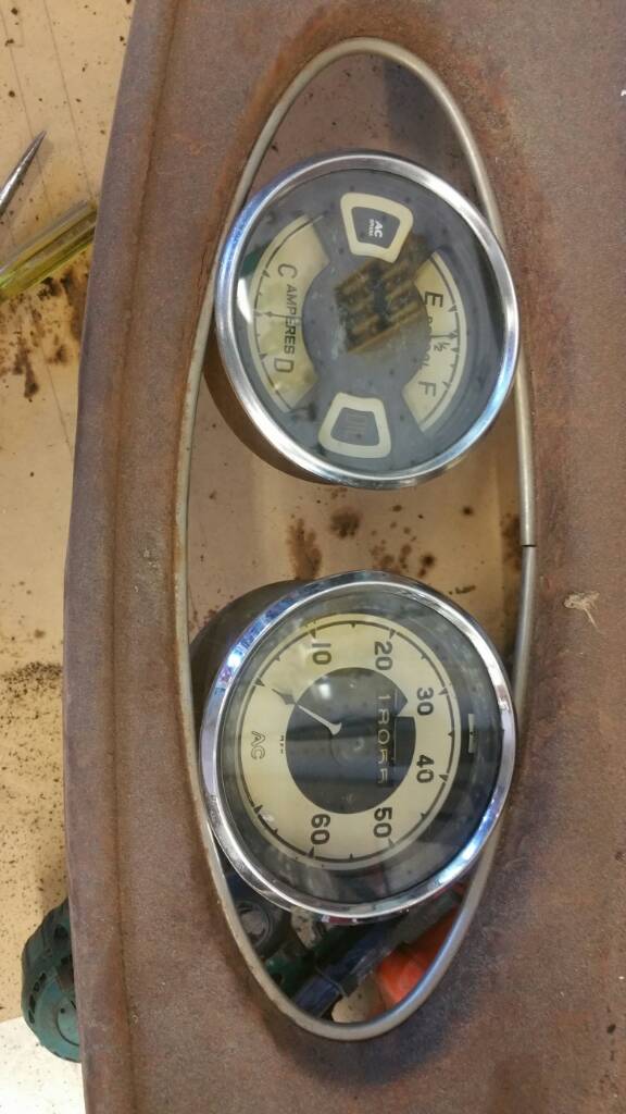

    Swap meet score today! Came with a spare speedo. It just had the look I'm after. No brand on the face, nice era look and cheap. Ticks all the boxes. I'll probably find they're stuffed[emoji2]![​IMG]

    The AC on the face may point to some sort of GM truck... good pick up by the way. Was that the Clare swap?

    Yeah, bit of a drive. Grabbed a couple of headlights and a small light I might use as an emergency light.

    Nice looking gauges.

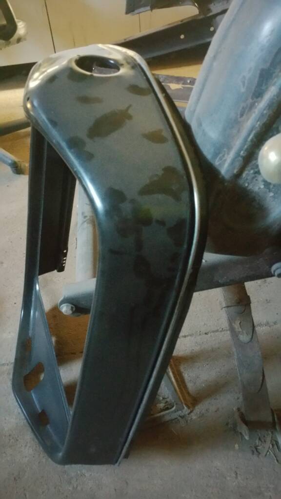

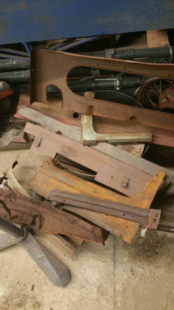

    Scored a rad shell trim, picked it up tonight. Original...[​IMG]
    Sent from my SM-N910G using The H.A.M.B. mobile app

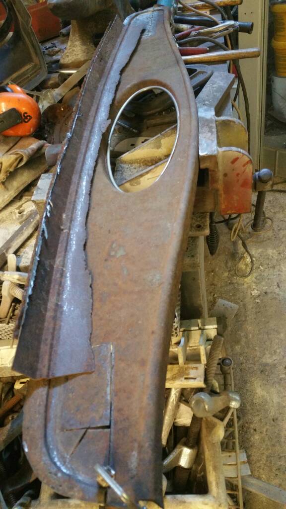

    Sqeezed half an hour in the shed tonight, before dad duties kicked in.... rummaged through my patch panel bin to repair my dash.[​IMG]

    [​IMG]clean it up and hopefully weld the patches in tomorrow night.

    Nice save on the dash!

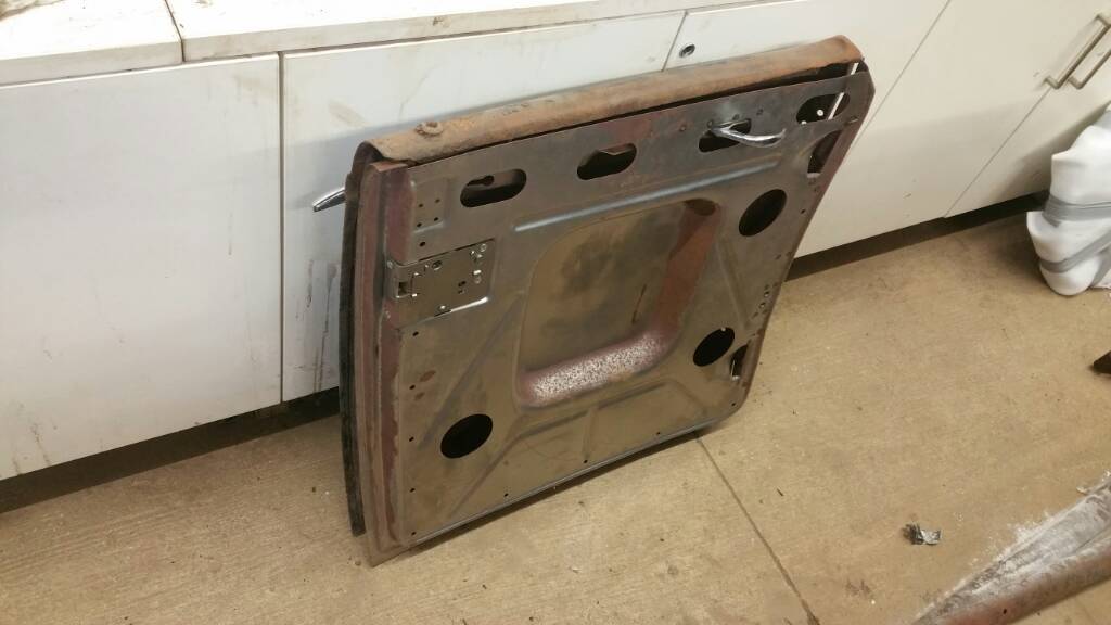

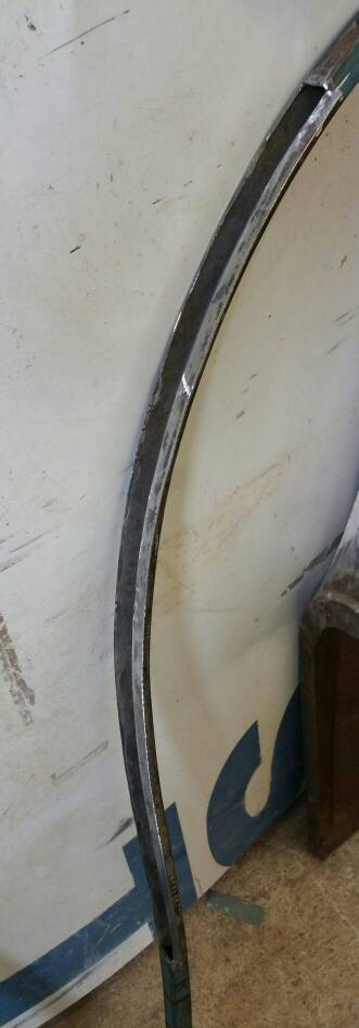

    [​IMG]passenger inner door skin arrived today! Needs a few adjustments but it will work! Did a little more on the dash but I'll chuck a photo up when it's in!

    You know Aussie roadsters had a timber inner structure right? US inners are more user friendly though.
  24. Drylake
    Joined: Jul 17, 2016
    Posts: 736
    Drylake
    Yes mate, i know they had an inner timber structure. I removed what was left by the white ants. I'm a cabinet maker and the temptation of creating some nice exposed timber frames is pretty high. But steel has much better structure and long jeverdy.

    I don't plan on putting a timber floor back in it either, sorry!

    To my knowledge, the only reason aussie 32's (amongst many others) had timber structures was to avoid import tax on arrival to Australia. A chassis and a bunch of crates would arrive with running gear etc. Inside. Crates would be used for door and cab inner structures as well as floors. Interesting history, but sagging twisting doors from heat and moisture fluctuations and fixings working loose doesn't appeal to me. Thanks for bringing the topic up though, so i can clarify my plans. I appreciate any positive input thanks for commenting ozyrodder!
