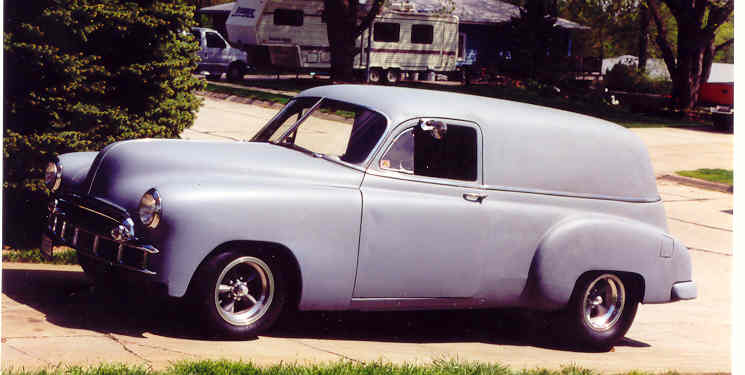

    You'll have to set the pinion angle with full weight on the springs...car sitting on the floor.
    When I set up my 50 delivery, I made a pair of lowering blocks that actually welded onto the axle housing and my spring-bolt holes [locates the axle on the springs] were drilled about 2.5 inches forward of the axle centerline to align the wheels in the wheelwells. Worked out great and yes, I also set my pinion angle at 3 degrees. I left the U-bolts loose [spring perches/lowering blocks not welded] and let the car down on it's wheels...used a floor jack to push the pinion up to 3 degrees and tack welded axle housing to spring perches/lowering blocks...then finished welded.
