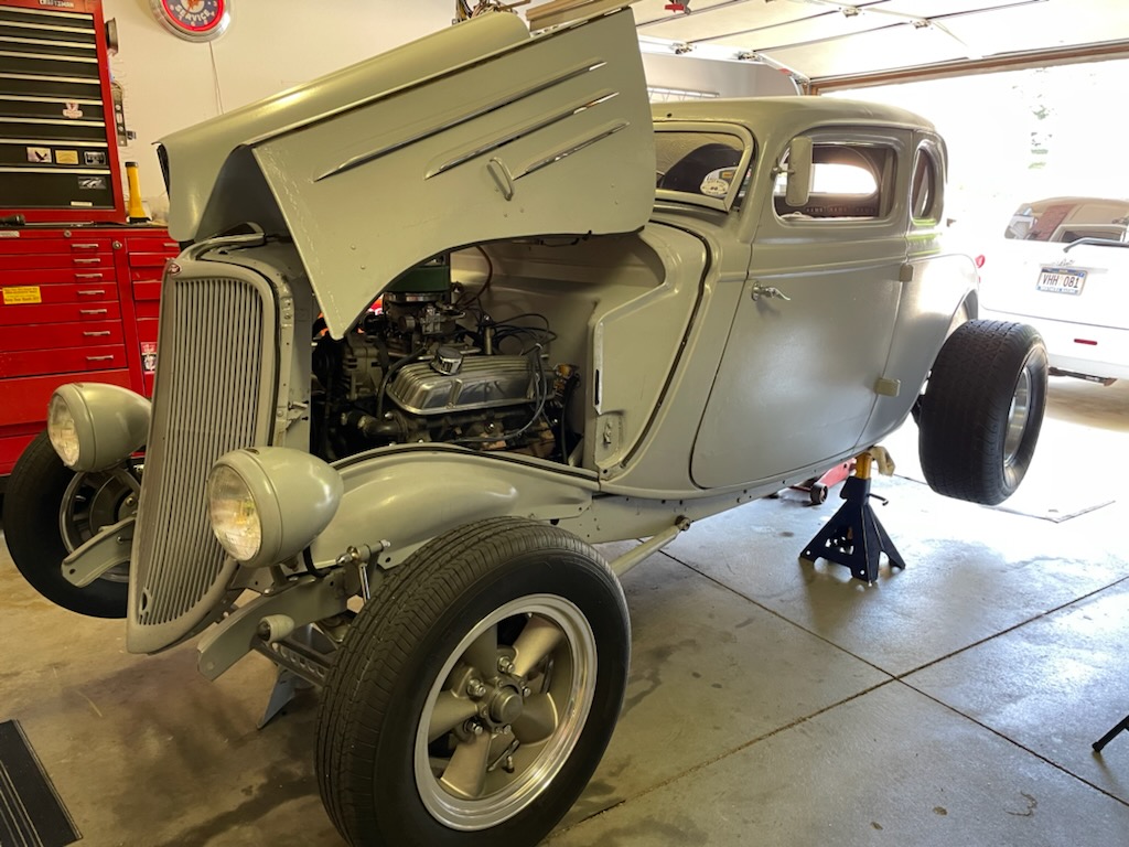

    I've been thinking I might make a run from Omaha to the west coast to visit family. I'd planned to drive my coupe out there because I'd driven it to Joplin for the HAMB drags a few times with no problems. Checked fluid levels and the plan was to do an "exploratory" run 150 miles west to Grand Island, Nebraska just to make sure everything was ok with the car.
    Every since I put the motor [Pontiac 370 cu in] together the rope rear main seal has dripped a little but not enough to worry about. I was planning to put my highway gears in the quick change but got lazy....left the 3.54s in and set off for Grand Island. At highway speeds the engine was buzzing more than I was comfortable with [3300-3500 rpm] but what the hell.
    Everything went pretty good until I pulled into a gas station at G.I. for some $4.70 fuel. I could hear the rear gear a little louder than I liked and at idle the oil pressure was lower than usual. I fired it back up and came home. I noticed the exhaust would puff a little smoke on deceleration ........ that's new.
    I made it home ok and the next day I checked the oil to see it was ok, in fact it was over full. Hmmmm....the engine is MAKING it's own oil??? Welp, I've been through this before with an old ford pickup I once owned. I have a hole in the mechanical fuel pump's diaphram! Pumping raw fuel into the crankcase! I sniffed the dipstick and the oil fill to confirm my su****ions. Smelled like gasoline. I was pissed and parked the car in the garage for almost 2 weeks without even looking at it.
    Today I actually decided to work off my 9 point list of **** to fix and number 1 was jack the beast up. Number 2 was drain engine oil, trans oil and drain rear axle. I got the engine oil drained to find the genuine plastic washer under my drain plug has a crack in it. I'm sure I'll find other stuff wrong too.
    As I think about it I shouldn't be mad at all....the car got me 300 miles of fun and was able to get me home. Tomorrow is another day. 34onstands2.jpg 34onstandsoil.jpg

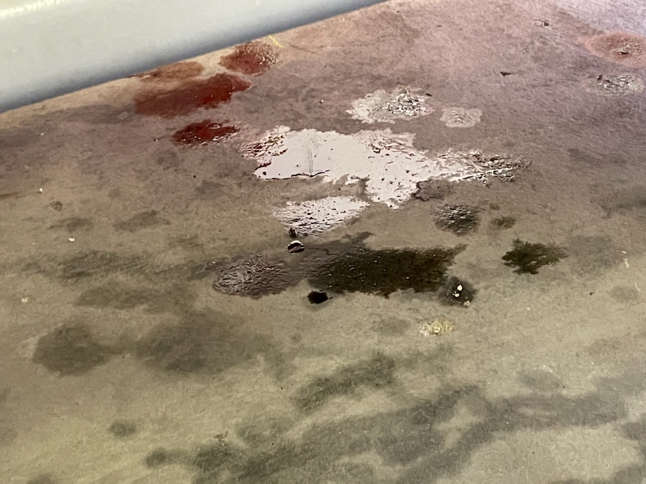

    My sedan has oil spots like that underneath every place I park it. And my drain plug gasket is actually not one of them.

    I got the engine oil leaks fixed with a new pan gasket and rear main seal, but the 39 trans leaks like a sieve from multiple places.

    Man those drips are noting compared to my garage soot under the flathead. Been drippijg for years! Lol.

    I park over a full sheet of plywood in my garage, and even that doesn't catch every spot.
