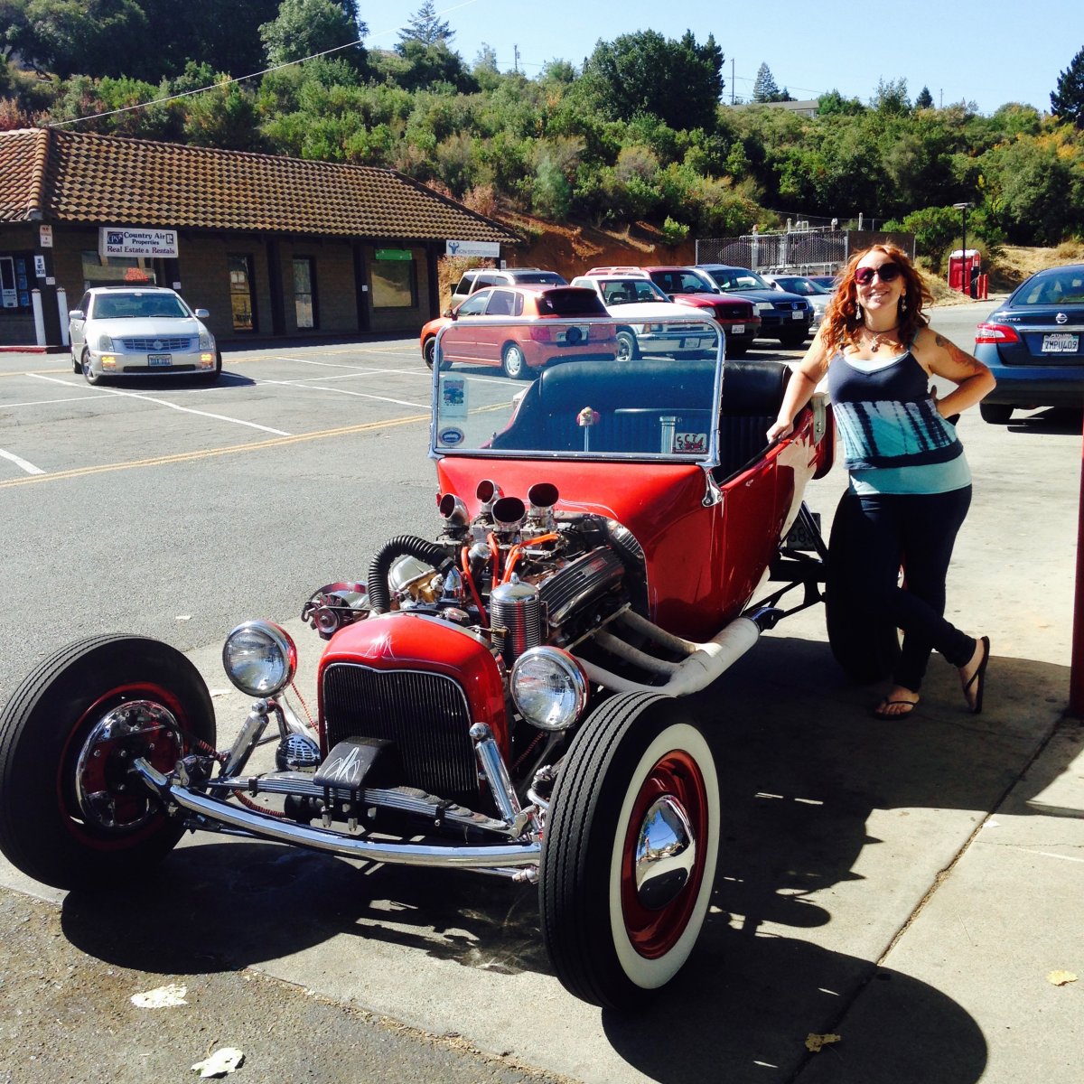

    This is a busy board I didn't expect this many replies so quickly. Try and answer some of the questions
    The pic I posted of the bucket is one I downloaded from the ad. I only have one body.

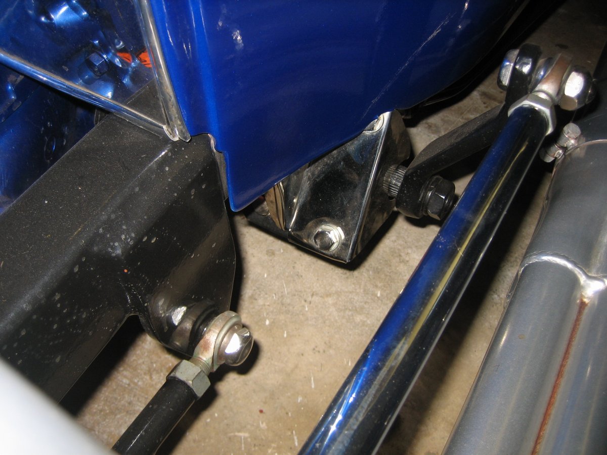

    Last T-bucket I built was with my son,we did use a Mustang steering box. I made a stainless steel cover an polished it,so it looks chrome. Box is mounted low {just a little lower then front bone,with arm up=gets rear of steering rod an rear end of bone fairly close together for low bumpsteer. 025.JPG
