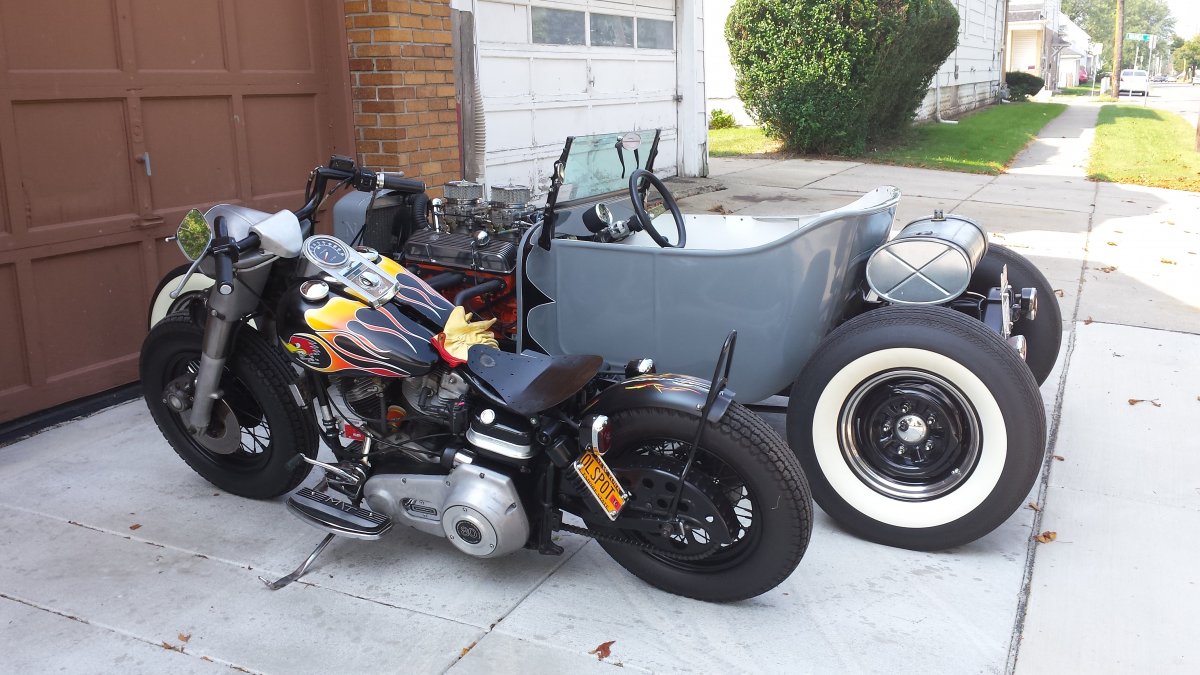

    Welcome to the HAMB and think about making the doors work during your build. Here's my bike and bucket, I also own a 1964 8hp Wheel Horse too. 20150905_110927.jpg

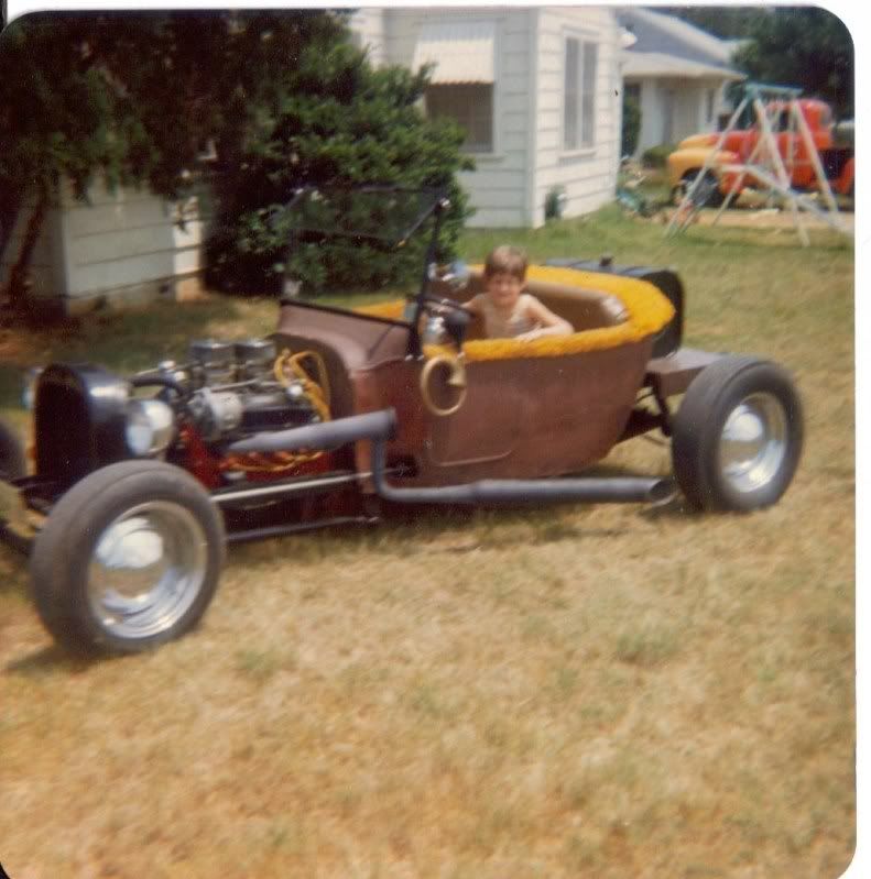

    Yep, have to agree there. My first attempt was a T bucket with a flathead and 27 body I dug out of a neighbors field and a frame a buddy had built.
    The one I built in Texas in the early 70's and had a ton of fun with was pretty rough by today's standards and had those "out of date" megaphone headers. A bit too much custom van influence on the interior too, Can't figure out why the hell I didn't go buy a couple more yards of that tan vinyl that I covered the seats with as that would have cost about ten bucks at the time.
    Most of the welding on that car was done by Paul Charles who now lives near Lake Whitney TX. We lived in McGregor then and I would stick parts in my car and carry them down the street to his garage where he would weld them and then I hauled them back home.
    I had a lot of want to but not that many rod building skills or knowledge in those days.
