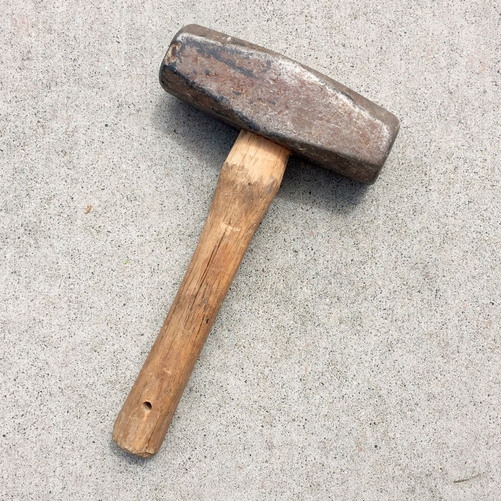

    Hope you don't have to revert to the hammer fix, Danny...Deuces HATE that!

    Too wiggel door gl*** tell it gose down a little,something like this, shake raddle n roll,dancing is up to you,LOL
