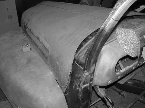

    Here are a couple pix that were taken the other night.
  6. onelow48
    Joined: Jun 29, 2003
    Posts: 262
    onelow48
    from Maryland
    another one...

  13. Jeff... Bill has my plaz. Get him to bring it down to cut the hood. Cut the two inches off then mock it back together. Step back and look at it. Then tuck the top part inside the bottom half. Lower the front about a half inch and step back again. Try 3/4 of an inch and try a full inch. Step back each time and look at it. Hell take pictures of it at each level then decide how much to "pie cut" it.
    Glad to hear you're makin progress with it.
    Clark
