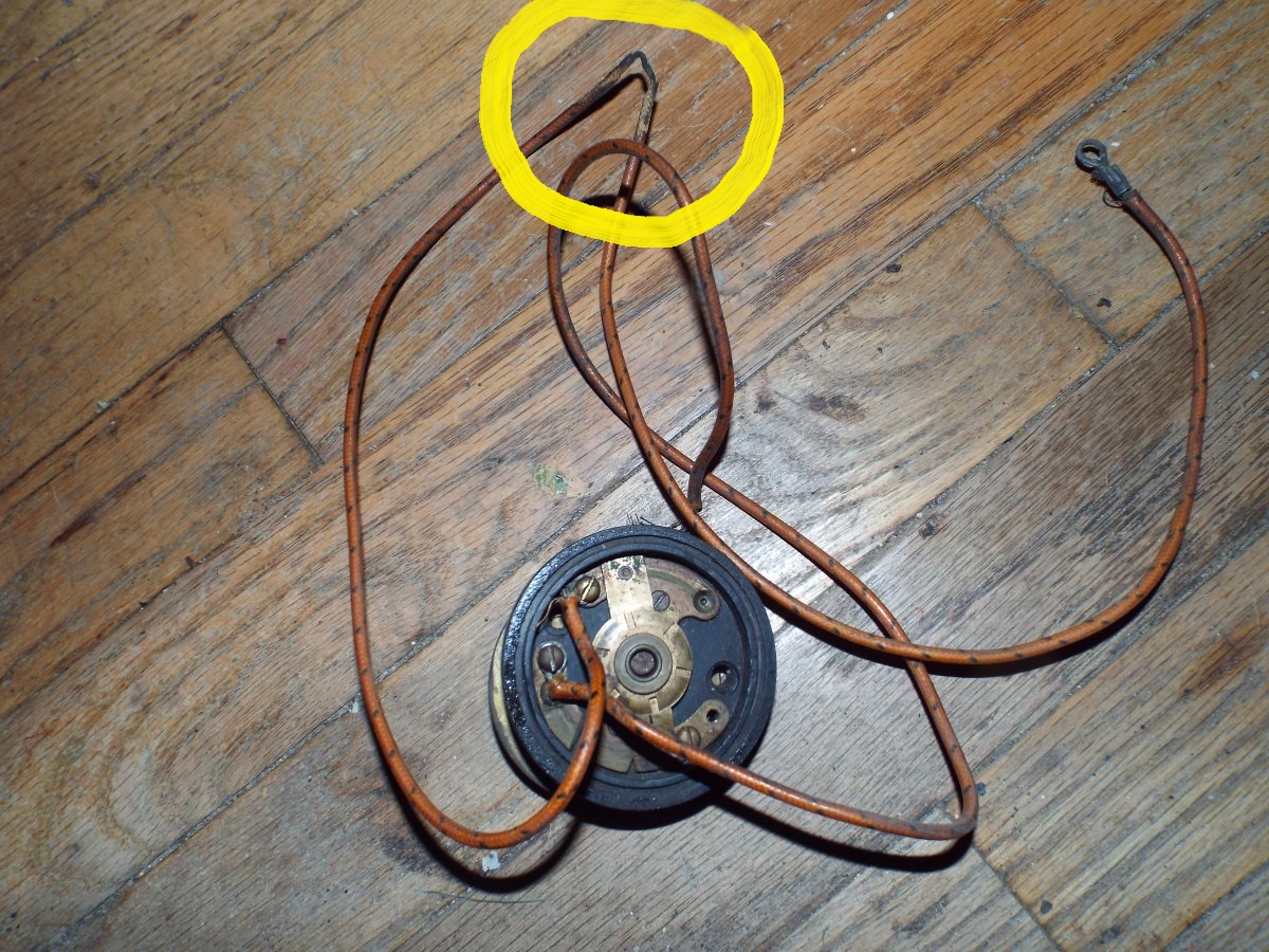

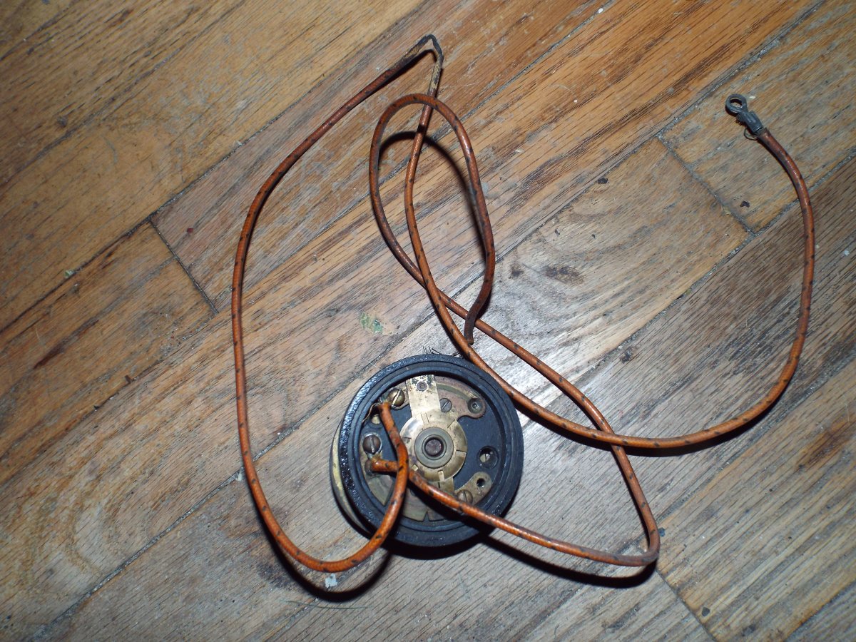

  13. noboD
    Joined: Jan 29, 2004
    Posts: 8,882
    noboD
    Ahhh, Bob there two wires in the picture.

  14. The37Kid
    Joined: Apr 30, 2004
    Posts: 32,362
    The37Kid
    Yes, 50-50 chance of getting it right, and I don't understand the switch either.

  15. Don't say there's two, don't listen, Bob there IS ONLY ONE WIRE.........carry one.;);):D JW
  16. F&J
    Joined: Apr 5, 2007
    Posts: 13,281
    F&J
    looks like the wire BURNED.. lol

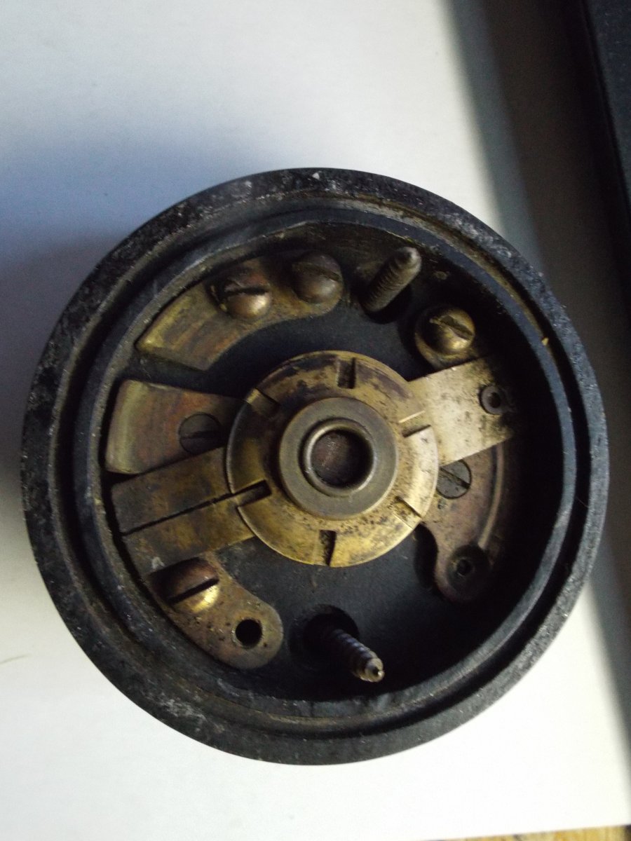

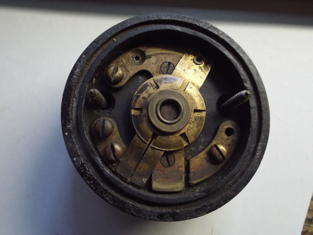

  17. The37Kid
    Posts: 32,362
    The37Kid
    First thing I did after taking that photo was put the wire outside in the scrap pile. On or off it still makes contact with all the brass. NOTHING electrical is understandable to me. DSCF2819.JPG DSCF2820.JPG DSCF2821.JPG

  19. noboD
    Posts: 8,882
    noboD
    Everything electrical is powered by smoke.
  20. One contact is for RUN and other would ground it for OFF, that's how i see it working. As long as the two separate contacts cant touch the moving arm at the same time it will work. JW
    Six Ball and loudbang like this.
  21. F&J
    Joined: Apr 5, 2007
    Posts: 13,281
    F&J
    I've worked on a few very early Mag cars.... I would bet one wire goes to chassis ground, the other goes to the Mag. The Mag only produces spark if the wire to it, is NOT grounded. To shut the engine off, that switch grounds the wire to the Mag.......In other words, the engine "should" run with no wires at all, but then you can't shut the engine off.

  22. The37Kid

  23. F&J
    Joined: Apr 5, 2007
    Posts: 13,281
    F&J
    It needs to be good solid contact at the brass contacts to kill the Mag. It won't jump an arc.
    Six Ball likes this.
  24. Low voltage, they knew what they were making. House switches can have much the same gap. JW
