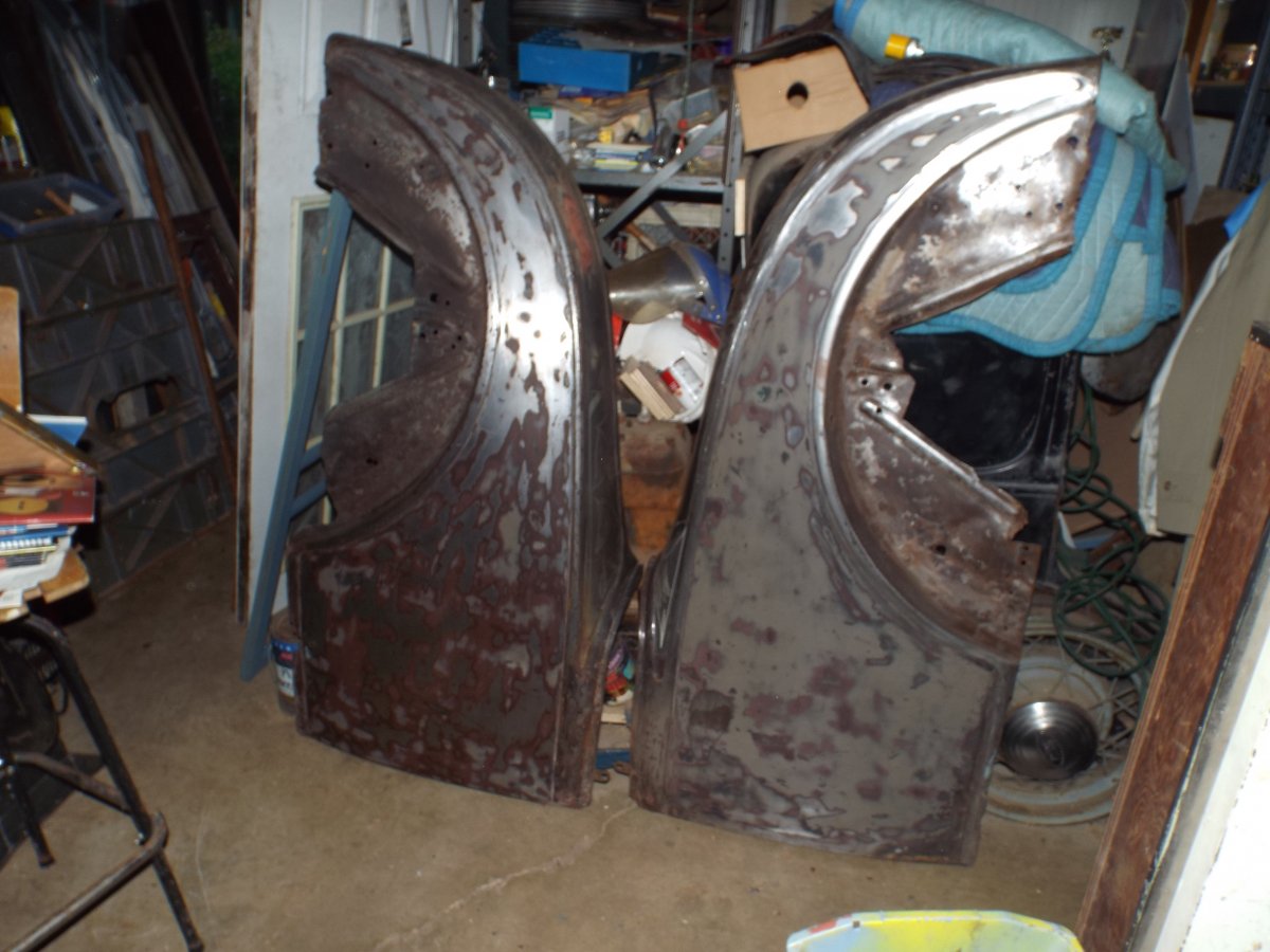

    It took a full sheet of 400 to get the drivers side cleaned up, lot more factory paint there.

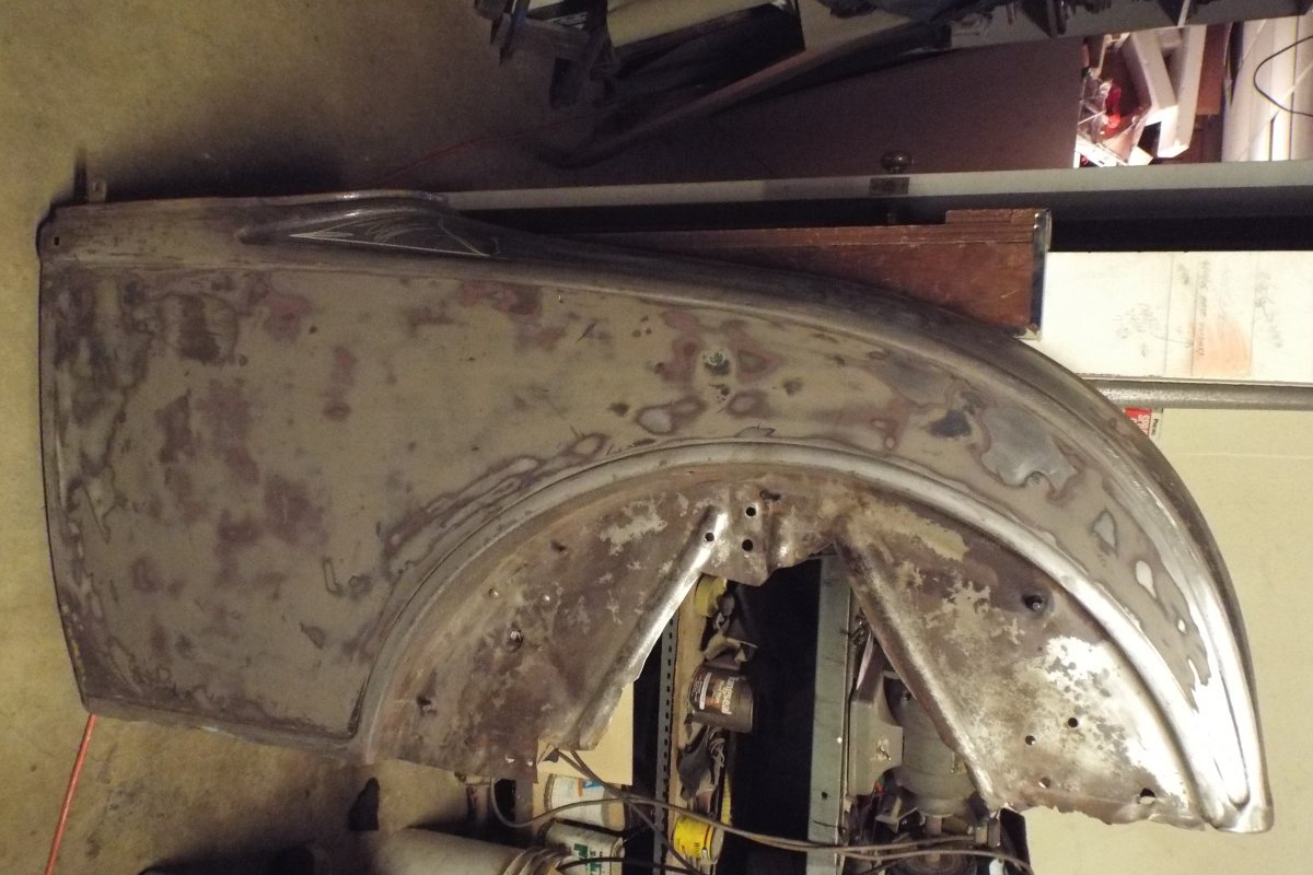

    No photos, but I have spent time yesterday and today on the rear quarters. Cut the factory spot welds and removed the rear corner brackets.
  7. The37Kid
    Joined: Apr 30, 2004
    Posts: 32,362
    The37Kid

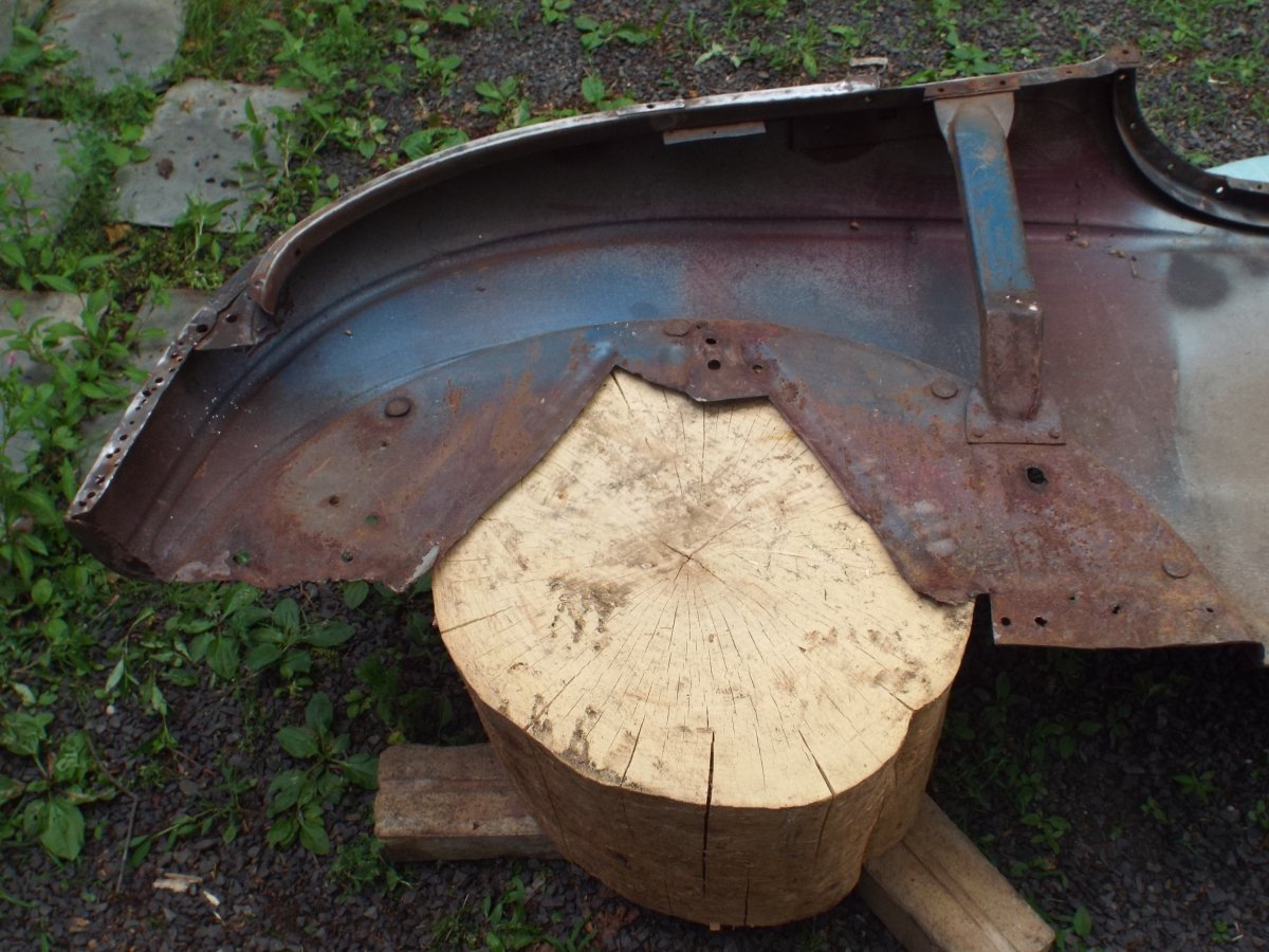

    Quarters are now cleaned of any bolts, screws or rivet remains, noticed the rear brackets were the rumble lid hinge attaches are missing, I'll be running a trunk lid so don't know if they need to go back in. Happy Father's Day!

    those triangular gussets go in both rumble and trunk... just remove the tophat shaped bracket that the hinge pivots through to convert... they are year specific …
    henry should have made a short piece of trunk gutter to bolt / rivet in for the bodies that don't have rumbles...
    Hmmmmmm…. is that a business opportunity calling a hamber ? …
    lots of guys would like to keep the water in a channel rather than just splash onto the floor...
    [2] styles - stock frame and '32 rails...
    i'ld buy 3 pair if in my $ bracket...
    more for washing the car more than cruising in the rain... $0.02.
