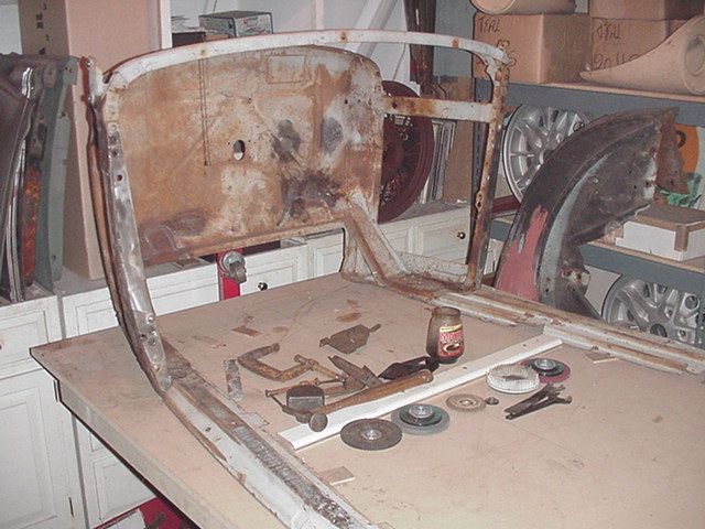

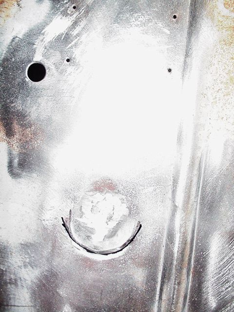

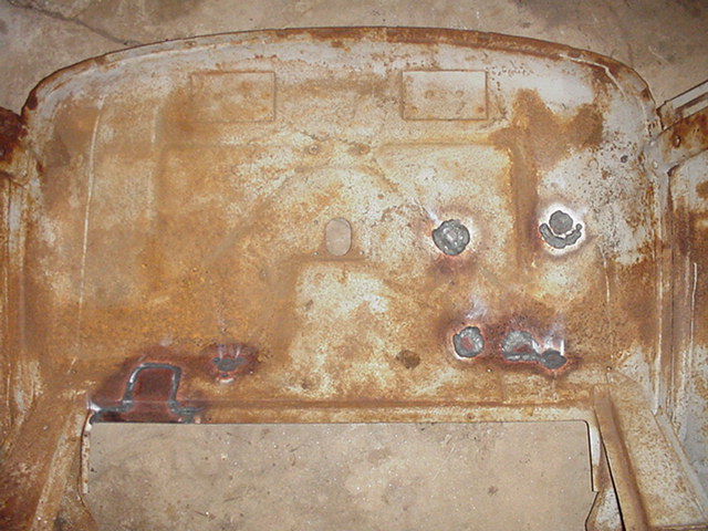

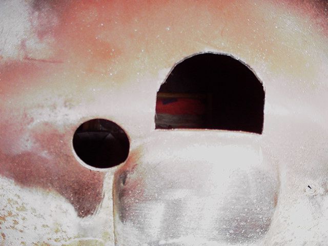

    I may have put an hour or two into the project this weekend. Got all the plugs cut out of a junk firewall to fill the unwanted holes in this one, cut out the lump for the choke rod. I did sell some stuff this week and will put it into needed parts. This firewall is a long way fron the finished firewall in Dodgerrodders RPU, he's set the bar, its good to have a goal.:)

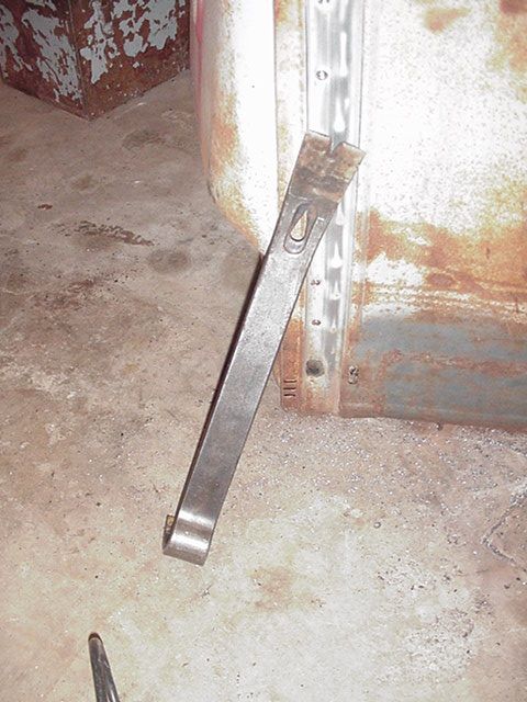

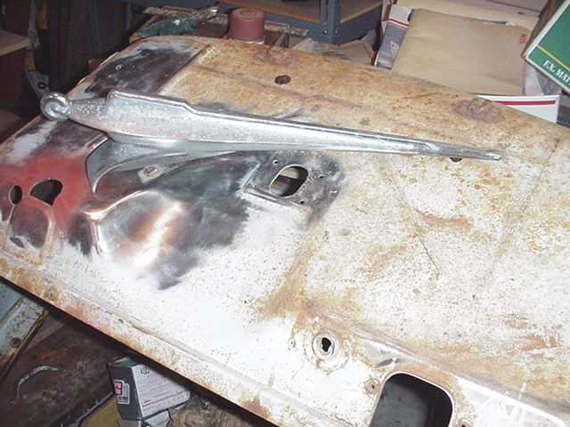

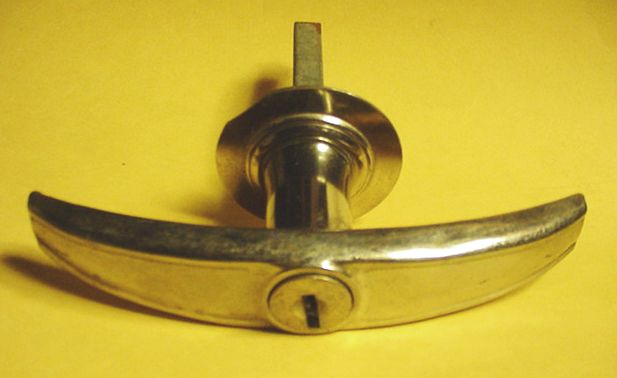

    Slacked off on the project today, just one more firewall hole to fill. Hope to have things finished for the sandblaster pickup this week. Did well yesterday on the scrap I cleaned out of the basement, turned it over into two parts buys. Does anyone recognize what this deck lid handle is from? Not Model A, stainless steel, 4 5/8 tip to tip.

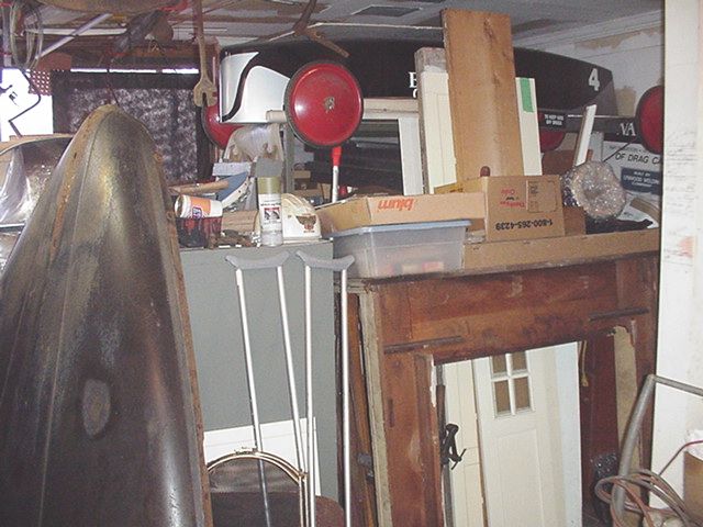

  9. Model A roadster in the basement. Good idea for a hiding spot. My wife would never look there.

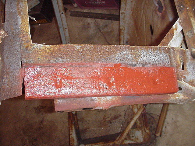

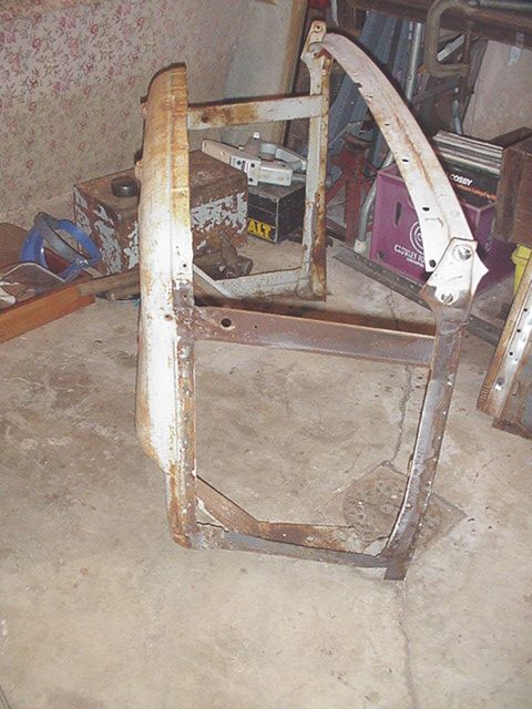

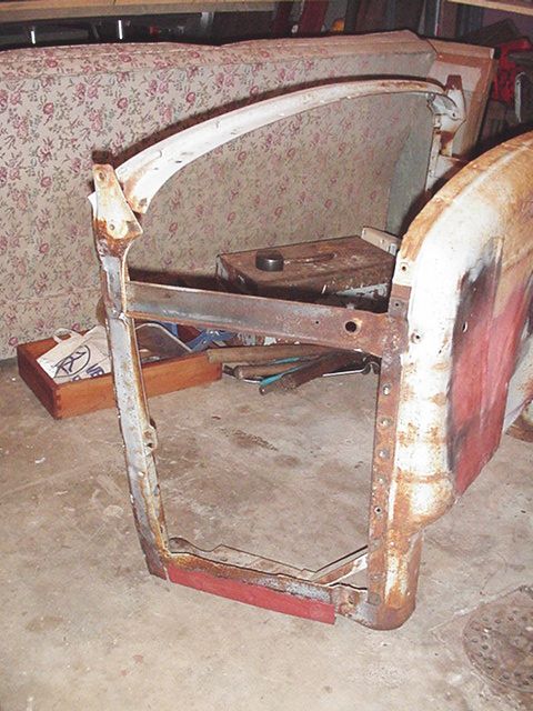

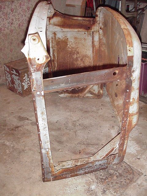

    Found time to work on the cowl section today. Holes are welded and ground, steering column hole was filled. I poped all the spot welds that hold the side panels on and now it is ready for American Dry Strippers to pick up and blast. I've got new Brookville panels to install. Looks like there is a plate on the bottom that needs to be replaced that has the red primer on it. I'll pop that off too to be sure everything gets blasted to as new condition.
    ******* Update: That piece in red primer is the Inner Cowl Bottom Patch. Snyders carries them, part number A-014-X, $16.95 each..........I ordered two.

    Naked Cowl Section

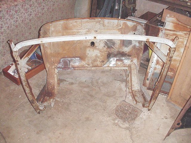

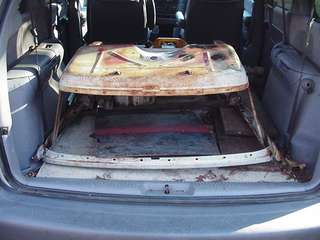

    Stuck the cowl on the sub rails for the first time, then packed them in the Minivan. American Dry Strippers will pick them up at work today, and deliver clean parts back to me in a week. I just may have a finished cowl by Christmas!

    that looks like the handle for the roll up rear window of a 1931 Model A coupe
