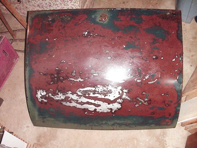

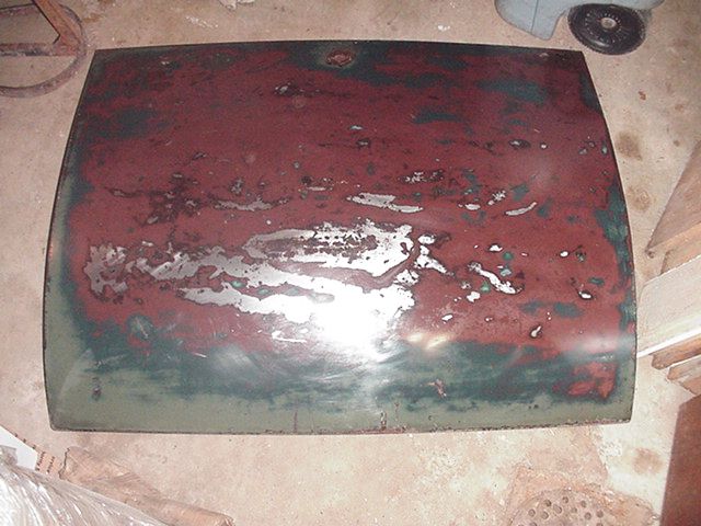

    I actually spent some time on the project over the weekend. Razor bladed the paint off the deck lid, sanded it with 1500 and gave it a coat of wax. How I have something clean to look at. Spindles are at the blaster, should be back this week. Posted some questions here about drilled backing plates. Got the back side of the roof on the house striped and tar papered so I can start shingling this week. Nice thing is the with 30 year shingles I'll never have to go up their again.

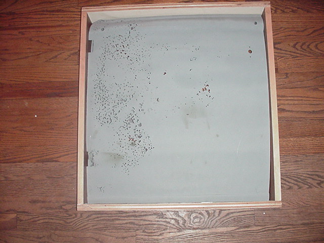

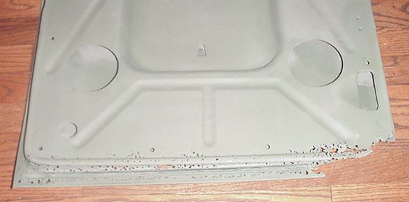

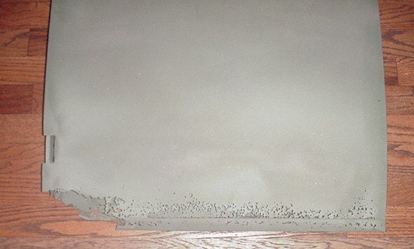

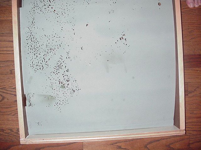

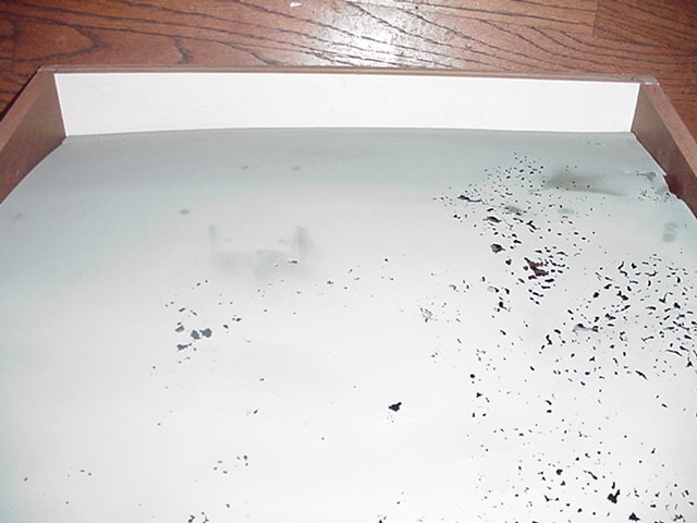

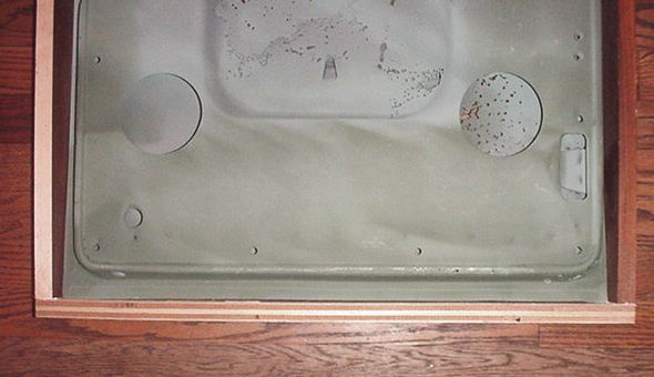

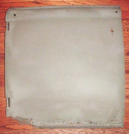

    I should finish the cowl and get in primer, but desided to attack the drivers door. I think I bought this door around 1975, good except the bottom is rotted off it. I won another on eBay last year that had everything but the bottom rotted off it. both were gl*** beaded by American Dry Striping in ****ord, Ct. Gary does great work. I made a frame out of plywood that fits the eBay door nice and tight, this is a solid door that gives me the overall height of a finished door. I can rip another piece of wood and use it to mark my cut line. Install the other door tight to the top and sides and cut it. I plan to use the frame as a welding jig as well.
