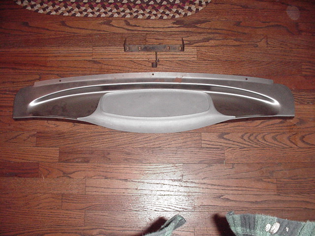

    Sold a 1905 Locomobile gauge and spent the money right away on a '32 Ford cowl vent hinge from 3Window Larry, and a Pierce Arrow dash from Alchemy. The dash arrived yesterday and it is a true work of art, fits my Brookvile dash perfectly. Next thing is buying hinges for the doors and finding a '32 cowl vent. I'd rather use an original, but may have to buy one from Brookville.

    Any time I actually work on this project is noteworthy to me, even if its only 2-3 hours. Cleaned off the work table and put everything in its place, even made places for some things. Found out the Pierce Arrow dash would have fit in a 1933-34, and started filing and sanding it, it's a really nice casting. Looked at the feet on the cowl, have to cut and reweld them for the mini channel that several guys have done on their HAMB projects. Got to find someone with a bead roller to redo my cowl panels, if they can be corrected. Just bugs me that that detail isn't the same as Henrys. Got to buy some studs so I can drill and thread the dash. Once that is sanded and polished it can be put aside and I can move on to another piece. Forcing myself to focus and finish something is my new goal.

    I posted an electrical question last week, and the replies really screwed up my thinking on this project, and I've preatty much blocked out ever finishing it. I do want to get the body done 100% and in primer paint ready before buying the frame rails. Drilled and tapped the Alcamy Pierce-Arrow dash and used some Bugatti nuts and studs that have been in my toolbox since 1984. Fitted it to the Brookville '32 dash that fits a 30-31 Roadster, then got that tweeked to fit in the cowl. I need to drill some more holes to allow this to attach to the cowl hoop and stay in place without using the three stock dash rail screws. I'll worry about drilling gauge and ****on holes in two years or so when and if I have them.

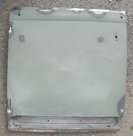

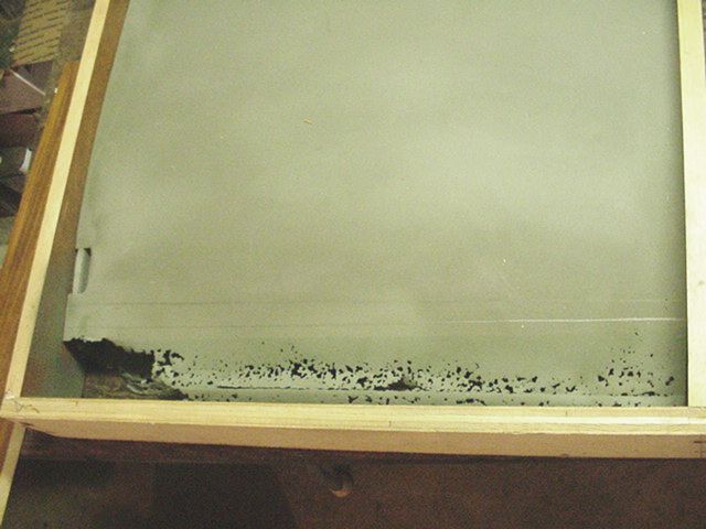

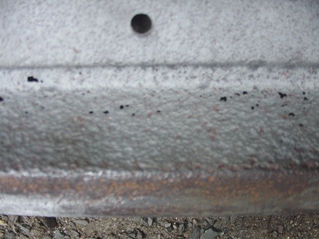

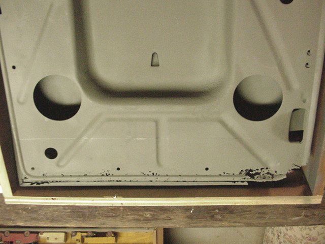

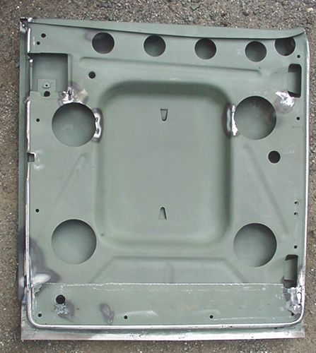

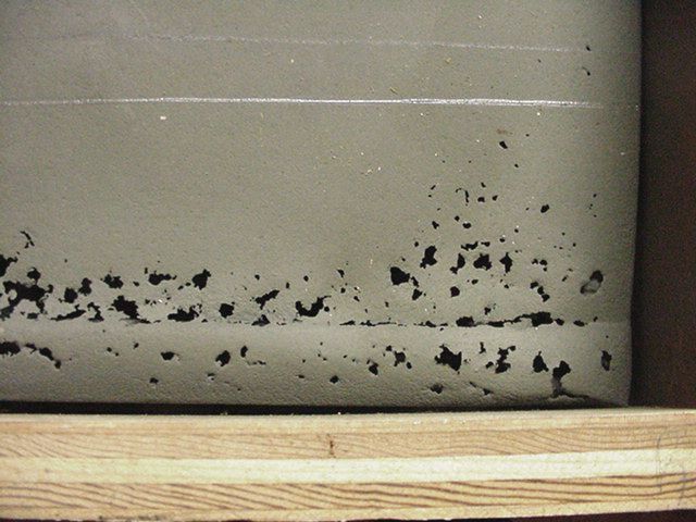

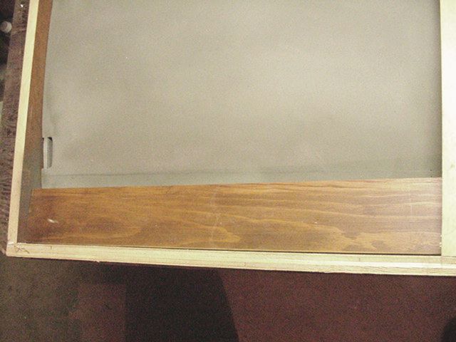

    I don't know why, maybe because the table saw was set up for another project but I spent some time on the Roadster today. The drivers door is good except for the mouse nest that rotted out the bottom front corner and there is rust through along the bottom. It looked worse when I came back from the sandblaster, American Dry Stripping in ****ord, Ct. I have another door with a great botton and inner panel, just need to cut and weld the two good halves together. I made a box that fit the other door since it is solid top to bottom, then placed this one in and it touches top and sides. I ripped a piece of pine the width of the good solid bottom and scruibed a good line to guide my tin snips. I need to take it to work tomorrow to cut the spot weld that are on the rolled edge. The other door sits in the box and gets the scribe mark, giving me two parts that will make a proper height door. Any step that takes me closer to a finished component is a good one. Bob
    Six Ball likes this.

    It was nice this afternoon, set up a table out back and did some welding. Making one door out of two took some carefull cutting and fitting. I need to use the cutoff wheel at work tomorrow, then the outer skin can go on.
