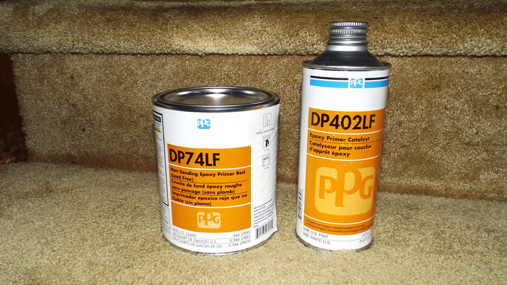

    This is what $94.69 worth of epoxy primer and hardener looks like. Getting more bits & pieces blasted, add a coat of primer and it will look like progress, slow, but progress none the less. Bob 4th%20of%20July%20and%20after_zpssbcxwgcg.jpg

    Bob, once you open that 402, you have about two weeks to use it before it goes bad. so set up a bunch of stuff.........and use a good new mask..... they go bad too.

    Thanks Ted, I had a few bucks so I wanted to spend it on the projects before is got blown away on something else. Guess the sandblast pile will get a bit larger. Thanks for the advice. Bob

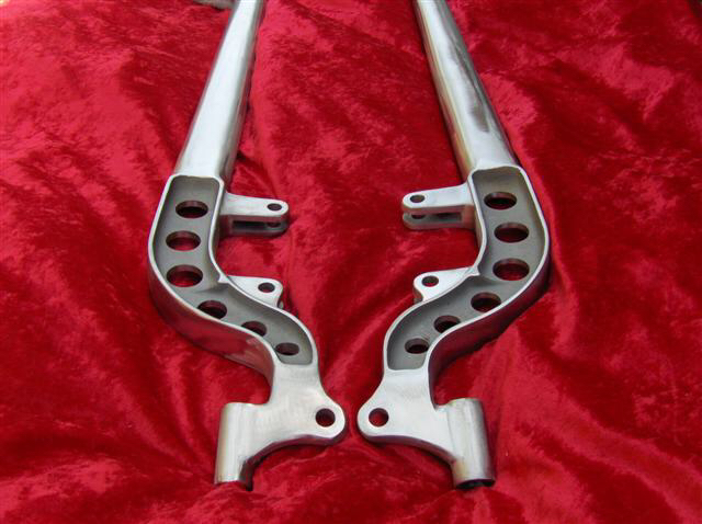

    If you feel like splashing out, 117Harv can turn those old bones into jewellery.

    Everything 117Harve puts his hands on turns into jewellery. I think I may add the lightening holes, and let the original forge marks stay. Bob

    I got the same stuff as well but got the 401 activator. More grab in it I heard

    The above^^^^^ info on the primer is correct! I learned the hard way! Made an excellent car cover though!
    Shoot as much as you can after cracking it open,and continue for the two weeks following.......
    After that- just throw it away.........****s to spend the $,and works great,but if it sit's,and you use it,you wont be a happy camper! Glad your back on it!

    Bob if you don't get to use it all before the date use it at work for something, don't let it go to waste.
    i have a little left in a can here that is approaching the "dead line" you can have it if you want to "try" it out first.

    401 gives you more "open" time to recoat. epoxy primer has a window of time after which it "closes" up. it has the ability to stick to what it is sprayed on, and then a length of time at which something can be sprayed on it and it will "grab" it. 401 gives a longer time than 402. after that it needs to be scuffed or epoxy sprayed back on. good primer, i always start with it.
    when i spray filler primer over it, i choose a different color, so when i block the filler and hit the different color i know when to stop. for example black epoxy under a gray filler primer, when i hit black i stop. this warns me i am getting close to exposing bare metal.

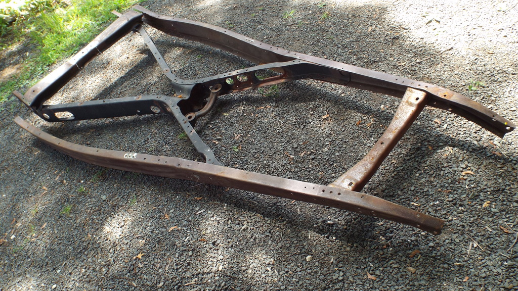

    4th%20of%20July%20and%20after%20015_zpsrqvmisdm.jpg 4th%20of%20July%20and%20after%20006_zpsxuvmjzoj.jpg 4th%20of%20July%20and%20after%20005_zpsx0kg2tkc.jpg Big day today, picked up a pair of original '32 rails with a factory number. Kind of funny when I think of all the stuff I sold to pay for them. Won some new JW Rod Shop rear rail sections from a Pro Street ch***is project ten minutes befor I left to pick up the rails. I've had the '37 x member and front and rear crossmembers for years. This will be a good winter project, getting bodywork in primer is job one while it is still warm. Bob

    nice, that explains the frame measurement question you posted.
    i have a 34 x member if you need it.

    It was a great day my first new in the box SMITH'S gauge arrived today, the fuel gauge. The frame rails are in the ba*****t, far more good areas than bad. Just having them mocked up will allow me to get the body subrails set, I'll need to save up for the kickup kit next. Bob

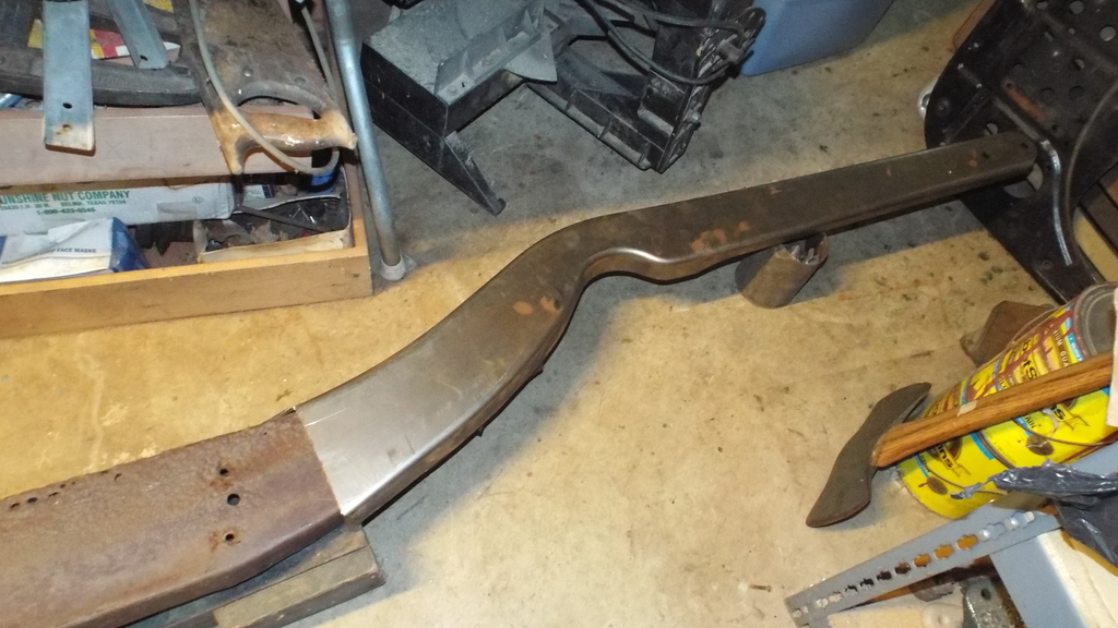

    JW rear kick up sections arrived today! Some were in Ohio there is a pro stock '32 ch***is, thanks to Thunder Road Rod & Custom the rear sections were listed on "That Auction Site". I had no idea just were the stock rails were cut but hoped for the best and the auction ended 15 minutes before I left to pick the rails up. For now I plan to just mock them up so I can fit the sub rail kick ups and fit the body. Bobbed rear tips will help replace the rotted top section on the drivers side. 2015%20LARS%20Fund%20503_zpsgc3fhzos.jpg 2015%20LARS%20Fund%20502_zpsr97eulpk.jpg
