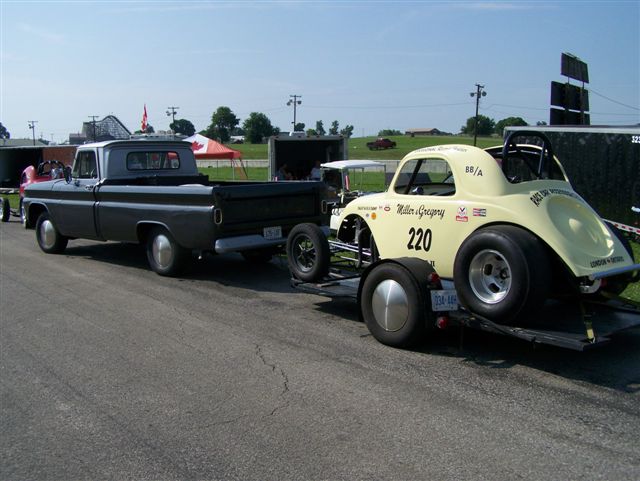

    Look at the pics of the trailer that I have. It's a dovetail, with #3500 axles & springs, along with 7.50-15 8-ply bias trailer tires. I've hauled (quite safely, I might add) over 65K miles with this rig, from everything from a Metropolitan to a 2-ton '50 Dodge cab & chassis. I'm getting ready to replace the tires with new, identical-style tires, just because these have been on the rig since 2001. Plenty of tread left, but the age of them concerns me now. How many of the "cheap" $30.00 MH wheels/tires did you go through, assuming you've had your trailer nearly nine years?

    I bought this one in 1988.It was titled as a 1968 homemade .It was made with a drive on lift out of a gas station.It was made well,only problem was it was built low to the ground.You had to drive on with the window down and crawl out it.Or winch it on...

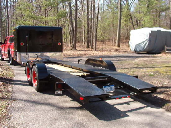

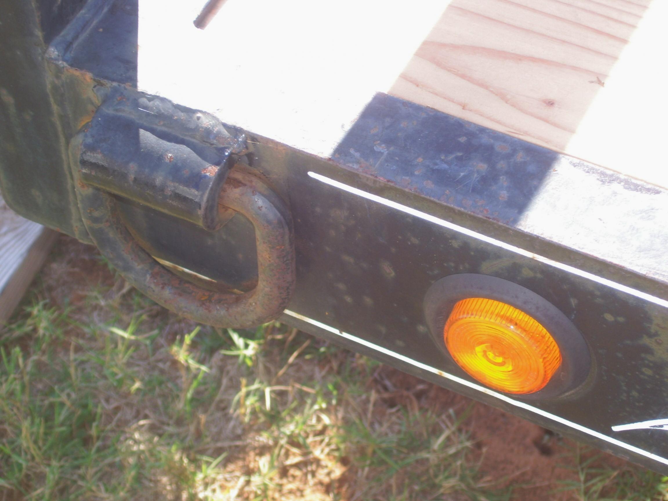

    I've had this trailer since 91 and I've pulled it all over the country. The winter of 06/07 I stretched it out from 16' to 24'. While doing the rebuild I also replaced the 3500# axles only one of which had 10" brakes with 6000# axles with both axles having 12" brakes. I have over 30 tiedowns on it, plus 2" boards down part of the center for hauling motors or what ever. This hauls like a dream and I've had it over 80 mph loaded a number of times while passing on the 2 laners. I have all the required lighting and used LED's for the tailights of which there are 4 as the ones on the back of the sleeper are functional also. It's a bit heavy at 3700# but I don't need to worry about it falling apart either. The picture with a load is crossing Big Horn Mts in Wy. and under the plastic is two flatheads. These pics were 2 years ago just after I finished it It now has a square tubing headache rack and hubcaps plus more tiedowns. I've put just over 16,000 mi on it in the last 2 years

  7. Is that a sleeper cab on your trailer??? What a cool idea that is! That gives me a design thought for a gooseneck hauler I'm wanting to build. What is the tongue weight on your rig?

    Yes that's a 40" sleeper. Saves like crazy on motel bills as I sleep in truck stops or Walmart parking lots. It really makes a difference when I'm out on a parts hunting trip to not have the room expenses. I don't know what the tongue weight is. I have a Chev 2500 Hd with an 8.1 in it that I use for hauling it plus I use a WD hitch set-up.

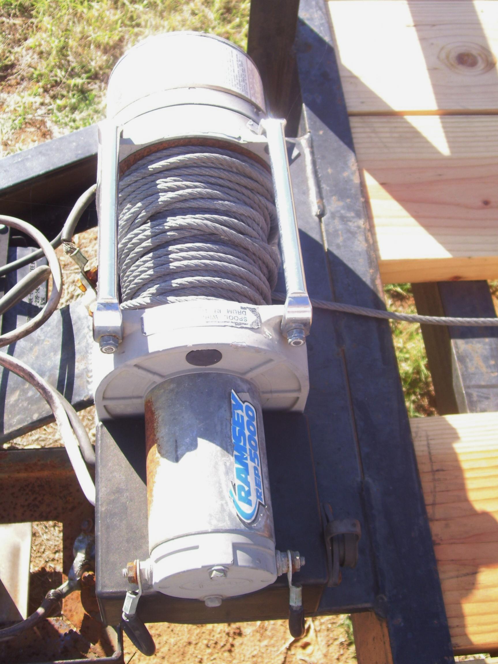

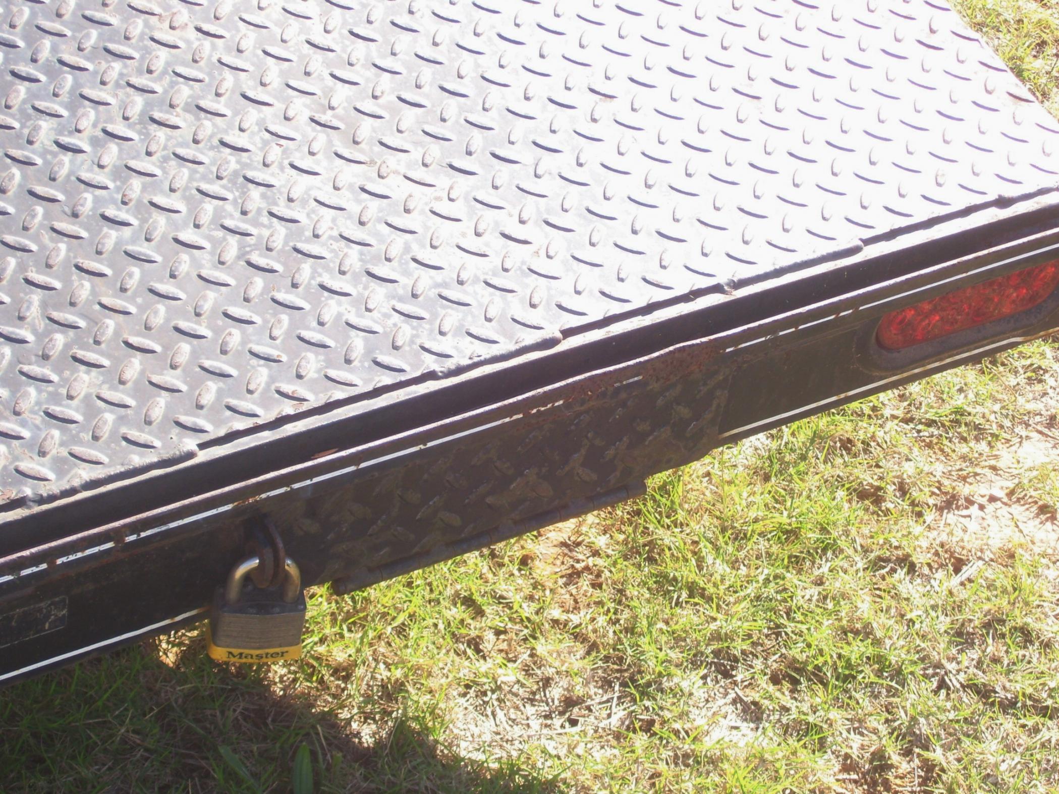

    i was looking for one for awhile that would fit my needs also. like mentioned ealier, one that i could put a 60's car on and be able to open the door.i could find anything that suited my needs, so i decided to build one. i went alittle crazy. total lenght is 32 ft. it has a 4ft box with all the winch, batteries, spares, etc.
    main frame is 2x2x3/16 box.
    up rights are the same
    floor bracing is 1 1/4 x 1 1/14 box i think 11 gauge, dont remember
    2x3x 1/4 for the tounge
    2x4x1/4 for the header
    .060 alum. for the skin
    2 5/16 bull dog coupler
    7000 pd axles with electric brakes.

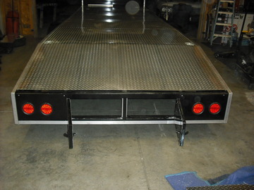

  10. ryno
    Joined: Oct 6, 2005
    Posts: 3,469
    ryno
    a couple of the frame work and the rear ramp storage.
