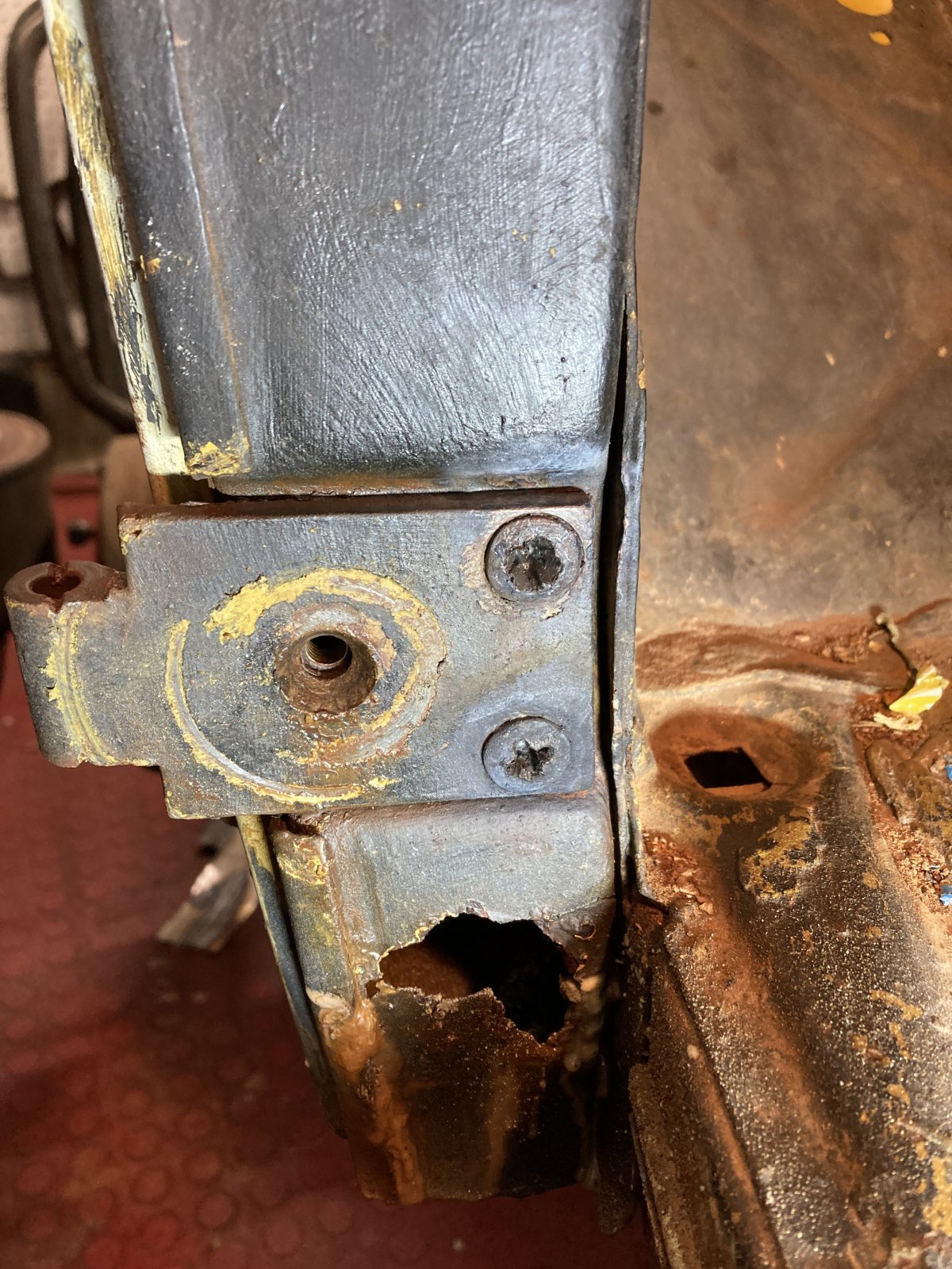

    Gentlemen,
    At my last post I have broken the tip of a carbide bit into the head of a rivet. I was able to knock that on through and finished removing all the door hinges from the doors. So I have now graduated to removing the other side of the hinges from the cab.
    No rivets, screws this side. I have a few that I just cannot get out and I am wondering if my impact screwdriver is optimal. As you can see in the first picture, it is an old "Esco" unit that worked fine on dirt bikes around 1970. However, I think it is set up to turn "too fast" and I might be better off with a unit that offers more leverage, less movement. Hoping to get any suggestions.
    I have been heating the screws up with a simple propane torch. I am hesitant to bring out the oxy/act as I am not sure I want that level of heat just yet.
    I know we all have our favorite penetrants. (And I know the real battle is getting the penetrant in where it will so some good.) I start out with putting a wax candle on the head and threads of the heated screw in hopes the wax will work its way in where I want it. If that does not do the trick I have Sea Foam Penetrating Oil (a buddy recommended it) and some Loc***e Fast break that is ancient.
    Open to any suggestions, as to methods that have worked well for you !

    On the top one, you maybe at the point of welding a nut onto it.
    I say break out the real torch as well. Looks like a pain.
    You’ll get it. Keep patient.

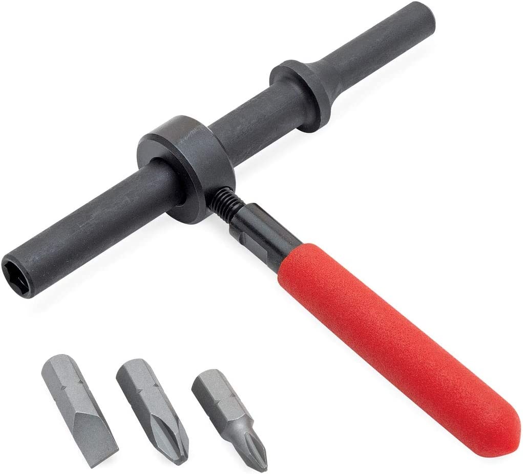

    ^^^^^^^^^^^^ Those work great! Hit the trigger and turn, don't put turning force on it when you hit the trigger unless you have really strong bit's.

    the "shake and break " pictured above i bought one from snap on in the 90s put it your air hammer , turn it all the way down setting wise stick it in the screw ,lean on the bar and braap braap braap and they are free ,, soak the **** out of them for a few days if they are nasty ,, they will come out THAT TOOL IS MAGIC !!!!! if you dont own one you should EVERYBODY!!! dosent beat up stuff the way a hammer driver does ,, works every time snap on is exactly like this https://www.autotoolworld.com/Wivco...-N-Break-Imp-Screw-Remover-Tool_p_187218.html

    I looked on Eastwood site for @51504bat suggestion re: 'Shake-n-Break'.
    This tool sells from $18.99 (plus $18.00 shipping!) up to $49.00 plus shipping.
    From Eastwood, $18.99 dove in price with 'saved coupons' on their site. Tool cost $6.99!
    The shipping was Fedex, $18. But still... And, It's Eastwood. Thanks, 5150.

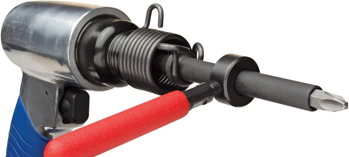

    I use the air chisel tool myself but I'm to cheap to buy one so I welded mine together from an old air chisel a socket on the end and a bolt welded on the side for a handle. Never had a screw that it wouldn't take out. Don't need any penatrating oil either. Took out a ton of model a door screws and never broke another one off.

  24. I have used the eastwood tool successfully many times. I bought it on sale after it was 1st released. I was a skeptic but soon proved wrong. :)
    51504bat likes this.
  25. I should add that eastwood recommends using low air pressure. I have had 90 psi on it before on tough door screws.
    egads likes this.

    Obviously the philips slots in the upper screw are toast.
    I'd try a small sharp chisel and hammer to drive the screw CCW.
    Maybe use a thin abrasive disk to cut a slot in the head of the screw for use with a stout flat bit. That reminds me, I need to get a couple of drag link sockets, one to grind down a bit for lesser screws.
    https://m.media-amazon.com/images/W/WEBP_402378-T1/images/I/51SEcmN2A9L._AC_SY879_.jpg
    I'd smush the philips slots tighter on the lower screw. Then drive the phillips bit into the philips slots to form a tighter, work hardened philips pattern.
    That air chisel version looks promising. Separating the functions of the impact screwdriver.
