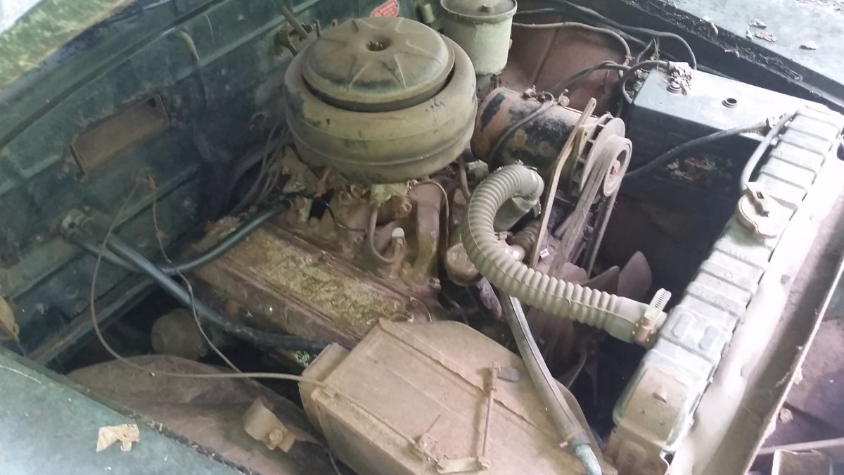

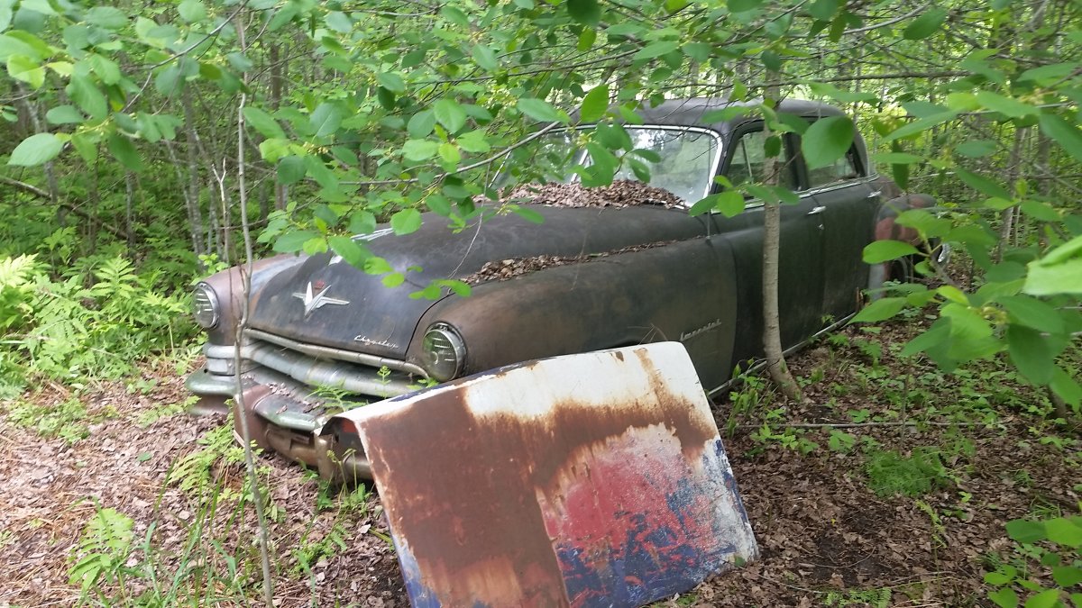

    What size hemi should be in this car? Looks original and motor is tight.

    It's a '51-52 Imperial sedan. It would have had a 331ci Chrysler Hemi stock and that sure looks like one to me. The earlier engines had smaller ports and an extended bellhousing, which makes them somewhat less desirable than the later Chryslers. But they're all desirable in their own way and can be built to suit your needs. The car looks like it's wasting away, so grab the Hemi before it gets s****ped.

    Make sure you get the headlight bulbs. It has the Autolite Bullseye bulbs. They are hard to find and worth money even if they do not light up. That car must of been sitting a long time. Do a search on them.

    Looks to be a 1953 which would carry a 331 c.i. HEMI.
  5. Good catch on the bulbs, I had one when my old bike was still 6V (back in the '70s) not only looked cool even to the uninformed but they seemed to make more light than the common off the shelf seal beam.
    yes it should be a 331 and the extended bell is not a problem, a 727 still can be adapted (or what ever you want really these days).

    If you search for it you can also find the procedure for cutting off the extended bell and modifying the block.
  7. There's zero need for that, none at all anymore.
  8. I actually did that a time or two before it occurred to me that you could just extend the crank. :D
    They used to get done both ways back when you couldn't just order the parts. I never saw it to be an issue, the long bell blocks were not as desirable but we used whatever we could get.

    I was told I was wrong about this. Yep....I am wrong. It is a 1951 or 1952 Imperial. It has a split windshield (which was pointed out to me) and the 1953 and 1954 had a curved, one-piece windshield. Thank you "Hnstray" for the lesson. I love to learn.

    The '53-54 Imperials also had a different rear door shape than the earlier cars, which is apparent in the first photo.

    ^^^^^^^^^that is true for Chrysler and Desoto in those years as well.

    Whats a car like this worth. Interior is completely shredded. Car is complete but not restorable.

    $1000 if there is anti-freeze in the cooling system - otherwise s**** price

    I dont really think anyone is going to sell that car for the $100 s**** price.

    The car in the original post is one of 21,711 built during it's two year (1951 and 1952) model span.

    The late '54 Hemi engines did away with the extended bell housing.
