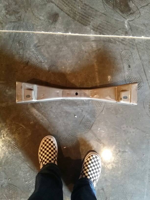

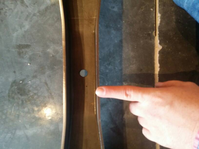

    Is there a flat area on the front crossmember for the front spring to clamp up to? On some repro "A" front crossmembers the flat area isn't wide enough, and the spring rides up on the radius on both sides and prevents the spring from seating properly. That is not good!

    flatout51
    I haven't tried a spring in it yet. I will tomorrow and let you know. But honestly I plan on installing original A front and rear crossmembers.

    flatout51
    I took this earlier to show the material thickness. It looks pretty flat in there and corners look sharp.
